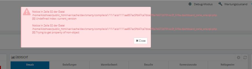

Michal Posted August 2, 2018 Share Posted August 2, 2018 (edited) Hi, I have just made an upgrade of development copy of my store via 1-Click upgrade from 1.6.1.20 (to 1.7.4.2). Currently I'm getting "Access denied" error when I try to open: Orders > Orders Discounts > Catalog Price Rules Customers > Customers Stats Shipping > Preferences International > Localization > Localization Shop Parameters > Order Settings > Order Settings Shop Parameters > Customer Settings > Titles Shop Parameters > Contact > Stores What coud be the problem? How to fix it? Edited February 28, 2019 by Michal (see edit history) 1 Link to comment Share on other sites More sharing options...
selectshop.at Posted August 2, 2018 Share Posted August 2, 2018 You also updated the server software ? It is not possible to run PS 1.7. with old php versions and/or old SQL. See here server requirements tested in production for PS 1.7. https://www.prestashop.com/forums/topic/633857-server-requirements-for-ps-17/ Link to comment Share on other sites More sharing options...

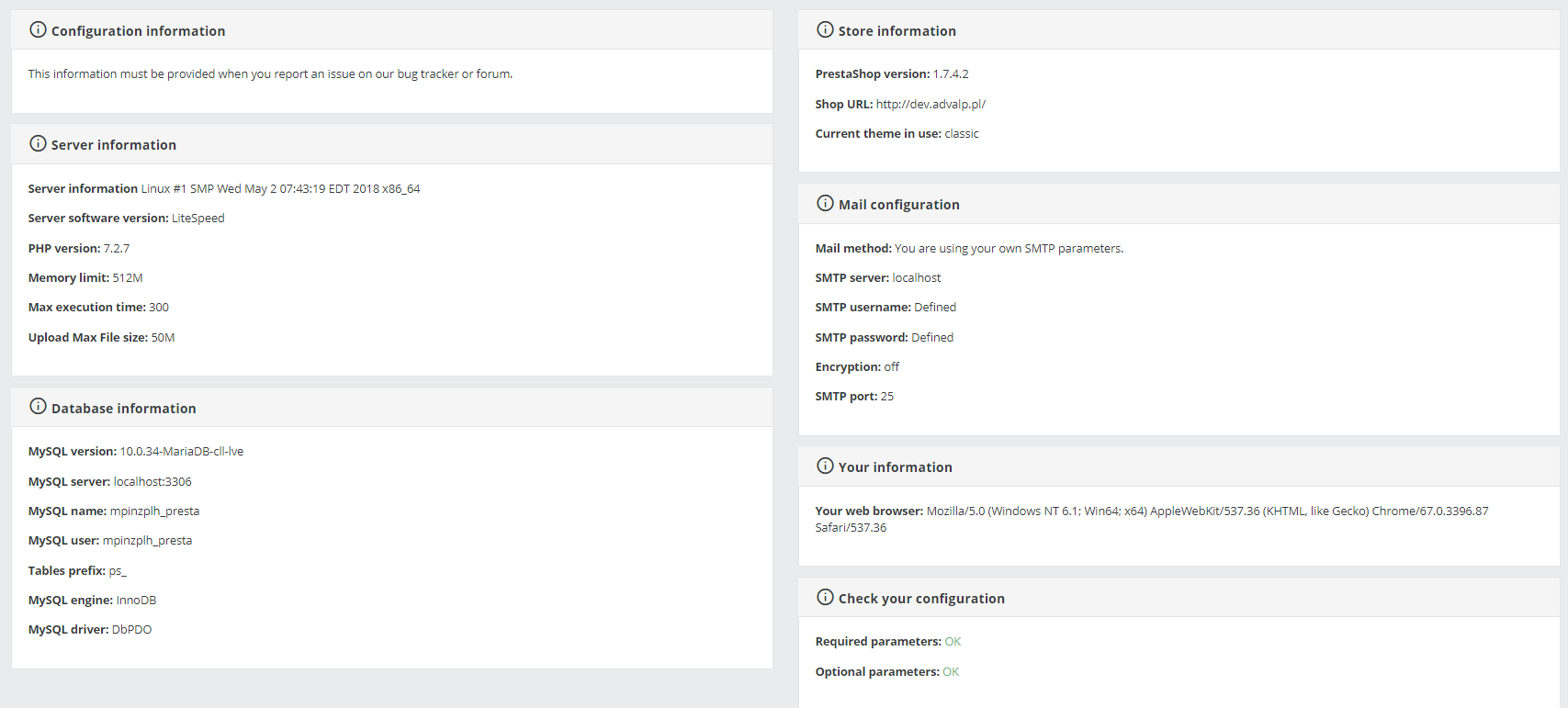

Michal Posted August 2, 2018 Author Share Posted August 2, 2018 (edited) My server is following the requirements (I've changed PHP 7.0 to 7.2 - error is still comming). Edit: I would also like to add, that new clean installation of Presta is working ok - I'm able to reach BO corners that are unavailable in dev store installation. Edited August 2, 2018 by Michal (see edit history) Link to comment Share on other sites More sharing options...
selectshop.at Posted August 3, 2018 Share Posted August 3, 2018 Server requirements are ok. If clean install works, than it must be an old module or theme you was using and this is still in effect. Link to comment Share on other sites More sharing options...

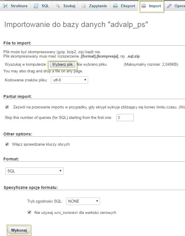

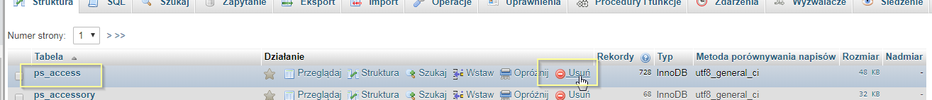

Michal Posted August 31, 2018 Author Share Posted August 31, 2018 (edited) Hi, Yes, the whole operation can be made with the phpMyAdmin. In mine looks like in the screen - sorry for the polish, but in english it should look quite similar. Just open your PS DB, and find ps_access table. In column 'actions' (polish 'działanie') there shoud be icon 'delete' (polish 'usuń') Then click 'Import' on the top menu, then 'choose file' ('wybierz plik'), and then click 'preform' ('wykonaj') Edited August 31, 2018 by Michal (see edit history) 1 Link to comment Share on other sites More sharing options...
sbempire Posted August 31, 2018 Share Posted August 31, 2018 Hi Michal, Thank you so much for the detailed fix information. It actually fixed the problem I had with no access to orders and stats menu. However, I lost access to all my modules. I tried to reset the modules as suggested by "El patron" but it didn't work. I will appreciate if anyone has a solution to access my modules again. I will be waiting for any suggestion for solution, while I continue to search a solution. Regards Link to comment Share on other sites More sharing options...

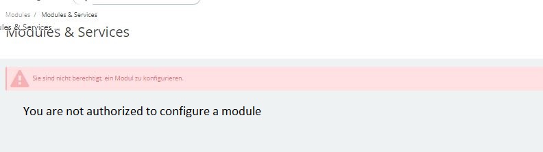

sbempire Posted August 31, 2018 Share Posted August 31, 2018 (edited) The information I get when I try to configur a module is " You are not authorized to configure a module". I am logged in as administrator. Edited August 31, 2018 by sbempire (see edit history) Link to comment Share on other sites More sharing options...

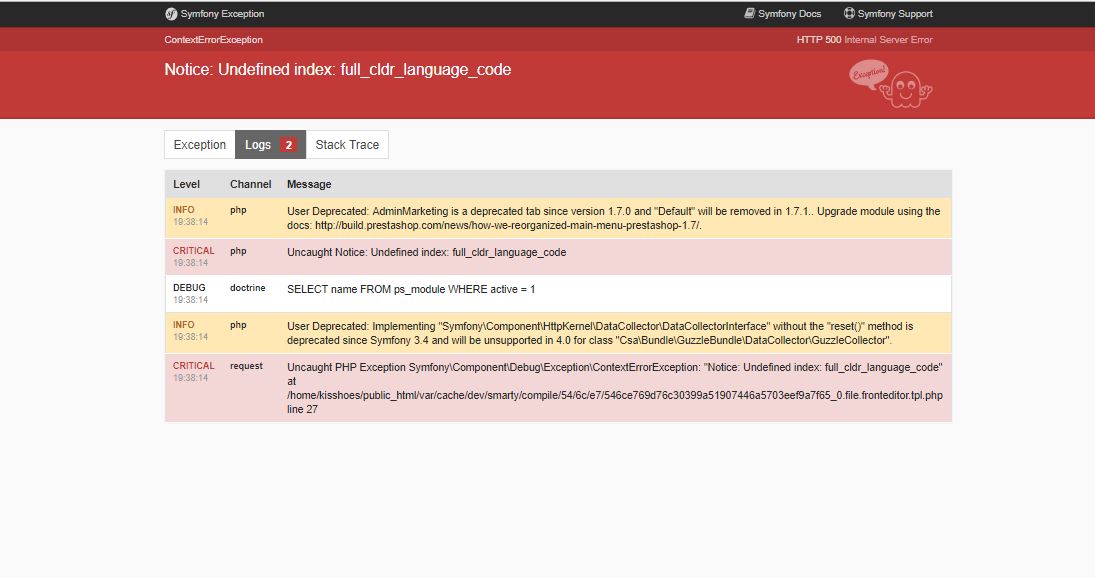

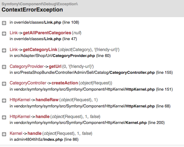

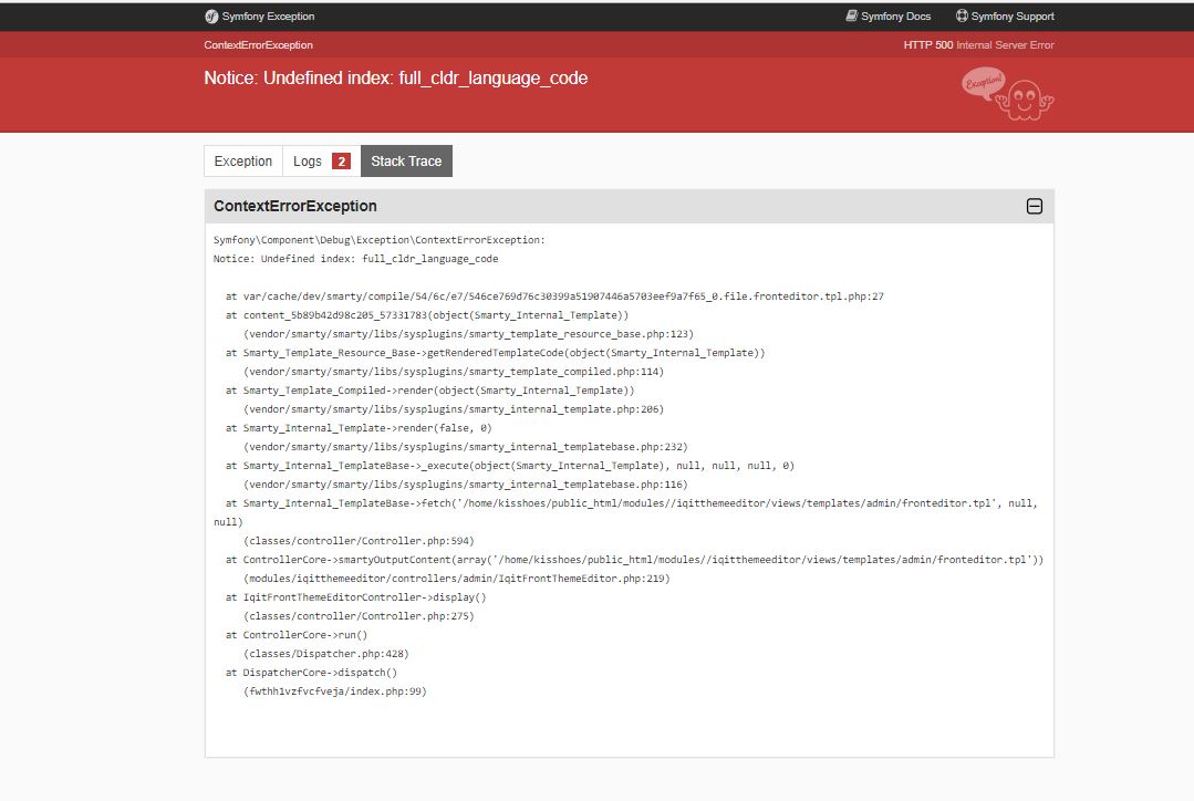

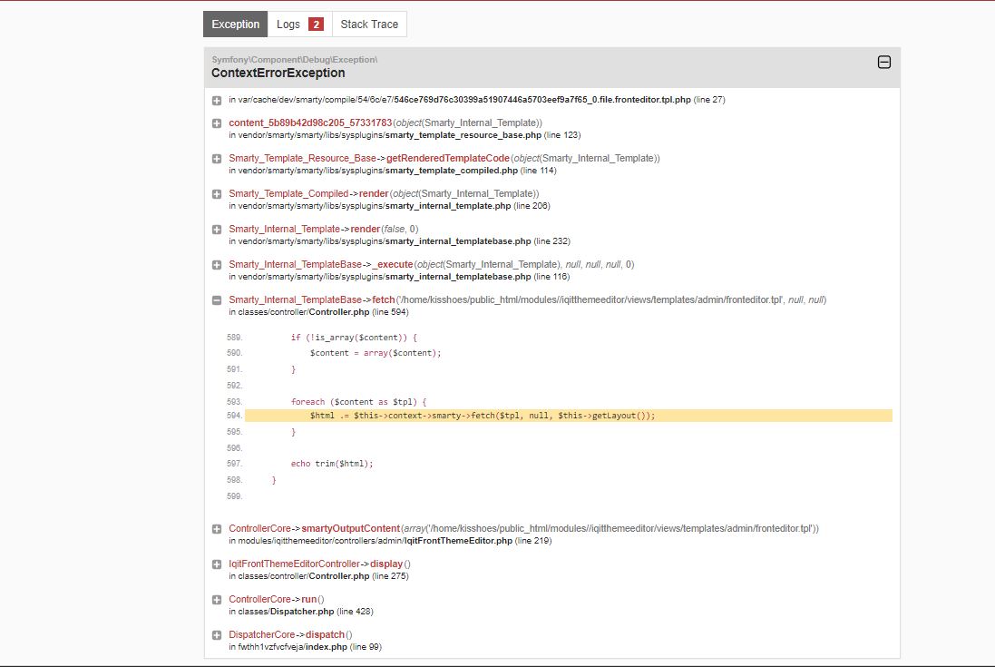

sbempire Posted August 31, 2018 Share Posted August 31, 2018 Hi El patron, the attached images are other information from debug mode from the theme editor. Please see Link to comment Share on other sites More sharing options...
sbempire Posted September 1, 2018 Share Posted September 1, 2018 Hi El patron, the attached images are other information from debug mode from the theme editor. Please see Link to comment Share on other sites More sharing options...
sbempire Posted September 1, 2018 Share Posted September 1, 2018 I am still seeking solution to " you are not authorized to configure a module error". If you have information to this issue please help Here is further error message on the dashboard with debug-mode on If you have explanations regarding these errors, please get them across. Thank you Link to comment Share on other sites More sharing options...

sbempire Posted September 3, 2018 Share Posted September 3, 2018 "You are not authorized to configure a module" Access to all my modules is denied On 31/08/2018 at 8:49 PM, sbempire said: The information I get when I try to configur a module is " You are not authorized to configure a module". I am logged in as administrator. On 31/08/2018 at 8:49 PM, sbempire said: E Has nobody a possible explanation for this bug - You are not authorized to configure a module. If you know a possible cause, please help!!! Thank you in advance for helping. Link to comment Share on other sites More sharing options...
EnricoM93 Posted October 29, 2018 Share Posted October 29, 2018 On 9/3/2018 at 11:14 AM, sbempire said: "You are not authorized to configure a module" Access to all my modules is denied Has nobody a possible explanation for this bug - You are not authorized to configure a module. If you know a possible cause, please help!!! Thank you in advance for helping. Same problem. Did you resolved? Link to comment Share on other sites More sharing options...
