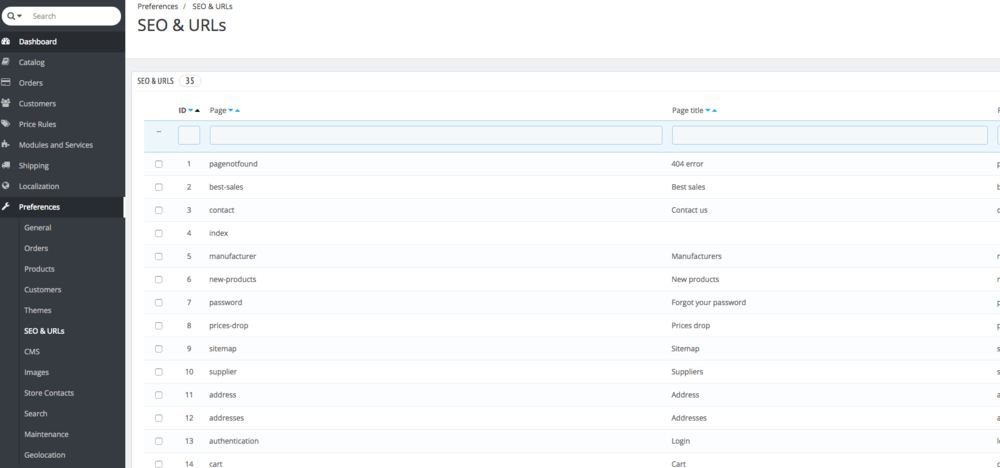

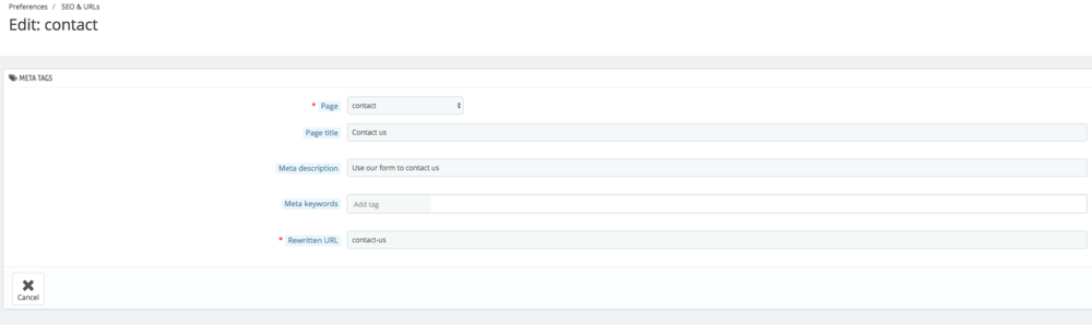

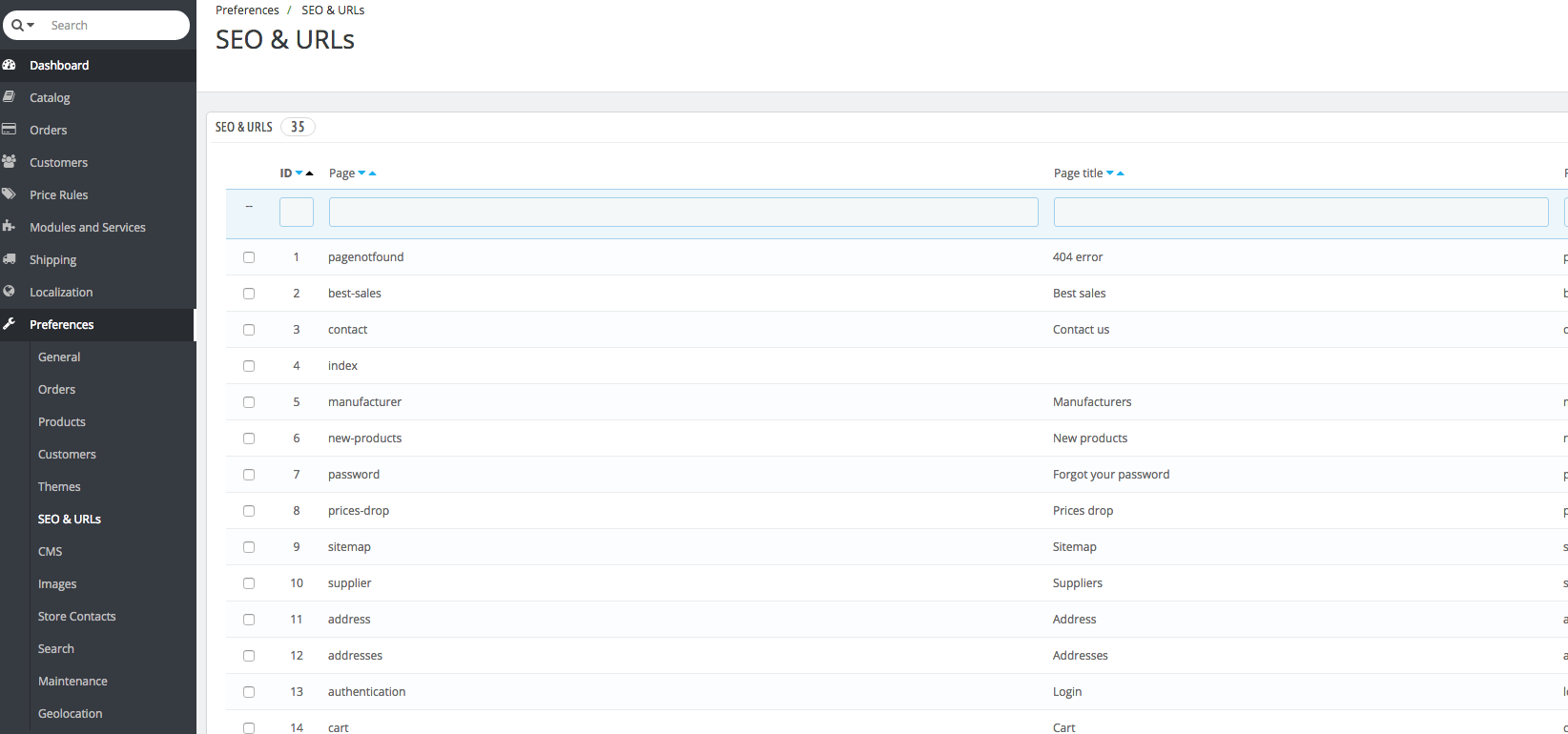

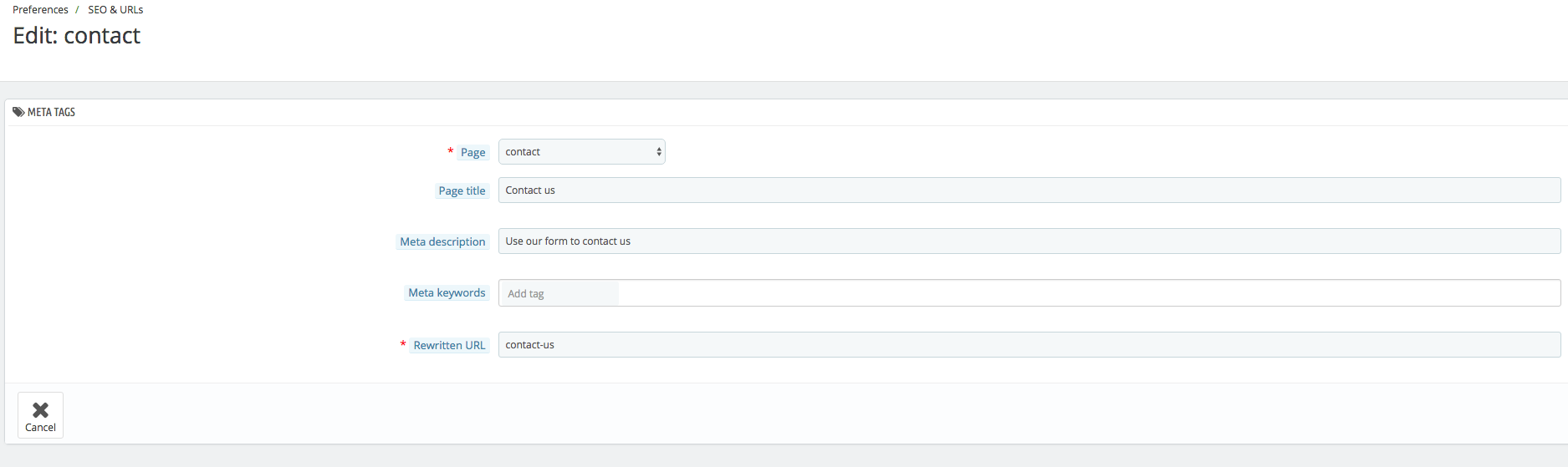

Mitsos QAS Posted February 27, 2018 Share Posted February 27, 2018 A simple solution that worked for me: Go to Preferences-->SEO & URLs and modify the contact page. In the Rewritten URL change contact-us to contact. The contact form will still work under the new URL but if you look at your online visitors the spammer gets a "pagenotfound" P.S.: I also have slidecaptcha on this form but didn't solve the problem P.S.2: IP blocking won't work cause it comes from all over Eastern Europe (Russia, Moldova, Ukraine, Kazakstan, Belarus,...) 3 Link to comment Share on other sites More sharing options...
epsilongr Posted February 28, 2018 Share Posted February 28, 2018 14 hours ago, Mitsos QAS said: A simple solution that worked for me: Go to Preferences-->SEO & URLs and modify the contact page. In the Rewritten URL change contact-us to contact. The contact form will still work under the new URL but if you look at your online visitors the spammer gets a "pagenotfound" P.S.: I also have slidecaptcha on this form but didn't solve the problem P.S.2: IP blocking won't work cause it comes from all over Eastern Europe (Russia, Moldova, Ukraine, Kazakstan, Belarus,...) me too ,but today probably they found it again. i just received the same russian spam mail 1 Link to comment Share on other sites More sharing options...
adversor Posted February 28, 2018 Share Posted February 28, 2018 Rewritting the SEO URL will not help. I have checked the log files, they also use /en/index.php?controller=contact This will redirect to the contact form what ever you write into SEO friendly URLs. Link to comment Share on other sites More sharing options...
TiaNex Shopping Posted February 28, 2018 Share Posted February 28, 2018 (edited) On 2/28/2018 at 7:31 PM, adversor said: Rewritting the SEO URL will not help. I have checked the log files, they also use /en/index.php?controller=contact This will redirect to the contact form what ever you write into SEO friendly URLs. it turns out this way will work ,please try it, i have add about more than 200 ips, i don't receive spam now, https://www.vicoffers.com/en/blog/4_ban-prestashop-spam-contact-message.html here is my blacklist, you can use ipset restore -f blacklist.txt to restore the blacklist to your server,then gather ip addresss and add manually blacklist.zip Edited March 1, 2018 by VicOffers (see edit history) Link to comment Share on other sites More sharing options...

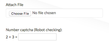

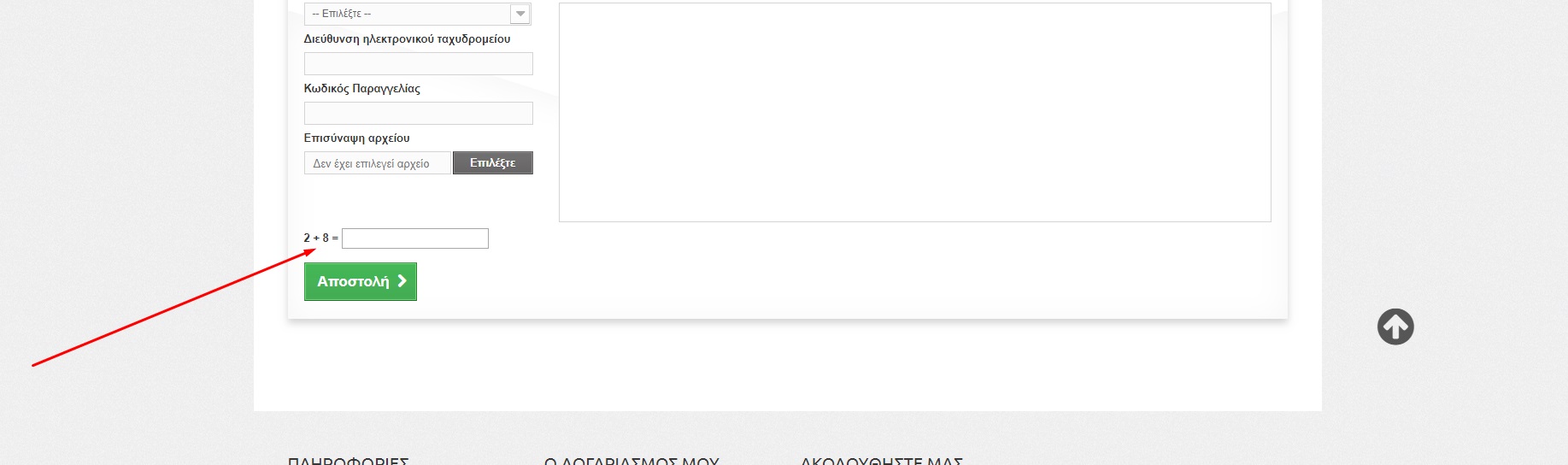

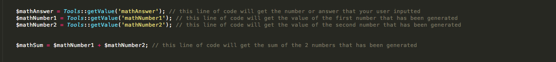

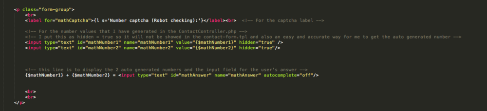

Steve Joms Posted November 15, 2018 Share Posted November 15, 2018 (edited) Hello Presta users, I hope this fix will work or I hope this will help someone. So instead of reCaptcha I created my own Math Captcha (ex. 5 + 7 = 12) My solution: 1. Just changing the code of contact-form.tpl in your themes folder won't work (the spammer can still connect to the "contact us" URL). What you should do is to delete the contact in the "SEO & URLs", you can find it in Preferences -> SEO & URLs 2. So after deleting the "contact" in SEO & URLs the spamming should be stop. Next thing you do is to edit the 2 files that is related to the issue. First file "contact-form.tpl" that is located in your theme folder (Dir: "/themes/"YourThemeName"/contact-form.tpl") Second file "ContactController.php" that is located in your theme folder (Dir: "/controllers/front/ContactController.php") 3. Editing the contact-form.tpl, in this file this is where you will edit the view of your contact form. You can put the code below just after the $fileupload if statement: It will look like this below: 4. Editing the ContactController.php, in this file this where your data will be controlled and validated before finalizing or posting the contact transaction. First look for initContent() function then add the following code just after line 287 or before this line of code "$this->setTemplate(_PS_THEME_DIR_.'contact-form.tpl');" Next look for postProcess() function this where the validation of data happens. In the postProcess function we should add some codes to make our Math Captcha be validated: 1. After this line of code "$message = Tools::getValue('message');" add the following code below: 2. Now we will add 2 validations first, if the field for Math Captcha is empty and second, if the answer to the Math Captcha is wrong. You can add this 2 validations right after this line of code "} elseif (!empty($file_attachment['name']) && !in_array(Tools::strtolower(substr($file_attachment['name'], -4)), $extension) &&!in_array(Tools::strtolower(substr($file_attachment['name'], -5)), $extension)) { $this->errors[] = Tools::displayError('Bad file extension'); }" Then add this code 5. Final step, just add again the contact webpage or url in the SEO & URLs VOILA!!! You now got rid off the contact spammer without spending a dime. I hope this will help someone or someone may add some thoughts with this solution. Cheers guys! Edited November 16, 2018 by Steve Joms (see edit history) 1 1 Link to comment Share on other sites More sharing options...
inspectaclueso Posted February 18, 2020 Share Posted February 18, 2020 On 11/15/2018 at 10:32 PM, Steve Joms said: Thanks @Steve Joms for sharing your work around. It would be awesome if you could post the code in a format that can be copied and pasted. This will prevent mistakes when trying to retype your code... or even attache the edited files so the code can be taken from them. Thanks Link to comment Share on other sites More sharing options...
