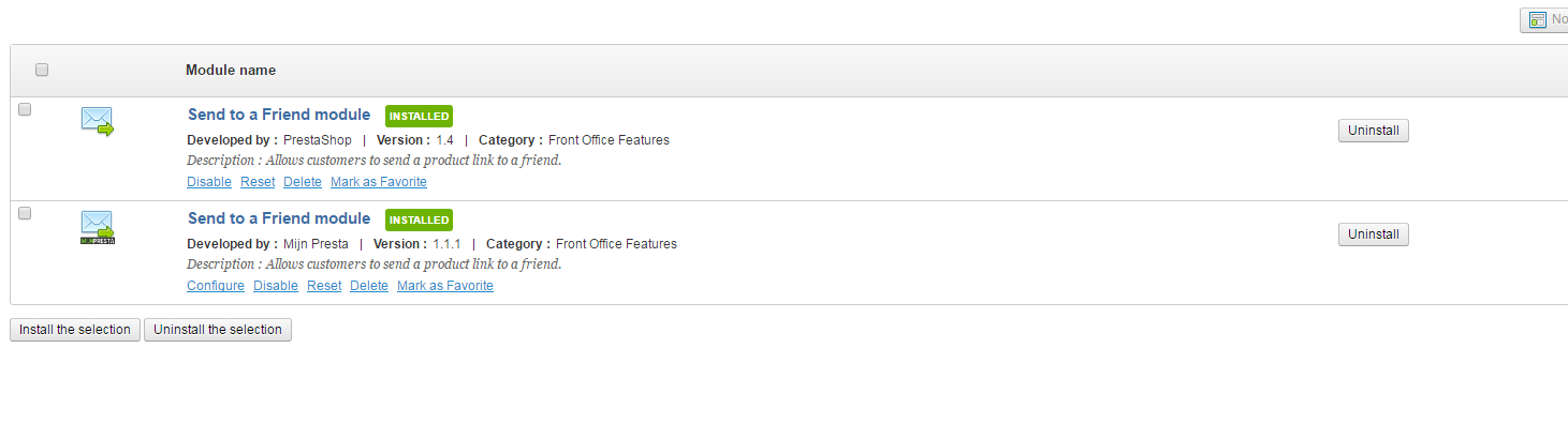

surferboy Posted August 4, 2016 Share Posted August 4, 2016 Secure the module with a captcha: https://github.com/firstred/mpsendtoafriend/releases No captcha response = no processing, so that saves your server some processing power. You can also protect the product reviews module if you like: https://github.com/firstred/mpproductcomments/releases Hi - I am kind of a bull in a china shop when it comes to tech administration. I downloaded the firs zip file you had in this link, under 1.1.2: https://github.com/firstred/mpsendtoafriend/releases Then I tried to add the module to my prestashop installation acp. Got an error. I tried again, after reenabling the send a link module. This time it added the module. Then I installed the module. Now there are two modules - see the attached prinstcreen. Do I need to uninstall the old one? Thanks, Brian Link to comment Share on other sites More sharing options...
surferboy Posted August 4, 2016 Share Posted August 4, 2016 update - there is no reCAPTCHA field appearing on the form for the send a link to a friend. any ideas? Link to comment Share on other sites More sharing options...
