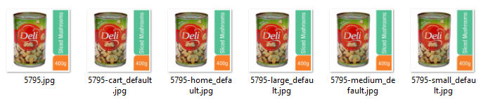

Hi,
I got my website backup & found the p folder where all images saved. But my aim is to link my exported products with the image name. Example pepsi product has ID1000 but the picture name not the same?! Anyone can tell me does image number represnt?
in your database you can find the table called ps_image where you can find the association with images and products.
for example you have for product ID 1000 an image with id 1234 you can found all images size in
/img/p/1/2/3/4/
(one folder for each number of the id)
and also the other image size you associate for the product (for example 1234-home_default.jpg)
/img/p/1/2/3/4/
this answer solved my problem, now I am able to create direct link to image.... check in ps_image for the id_image and from there you can create the link, thank you !!
