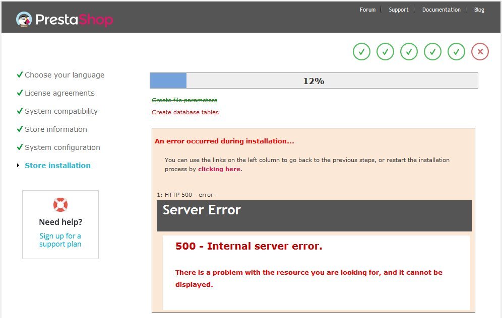

Hi,
Please check the permissions of the files /index.php and /install/index.php. it should be 755. You can check it from any FTP software like FileZilla or cPanel.
Just locate your file there and click "edit permissions" or "permissions" button (may be through right click).

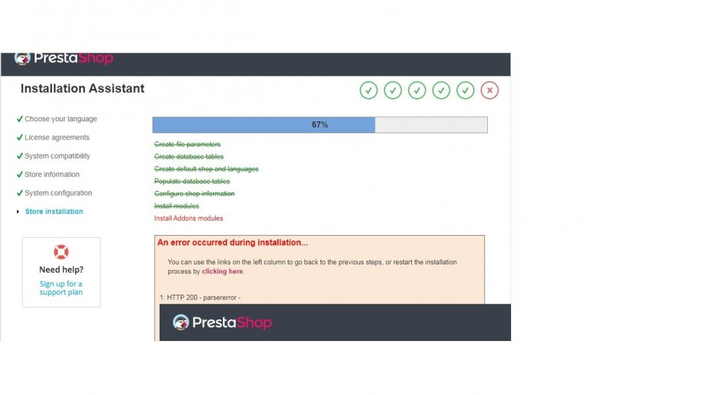

i have same problem
Create file parameters
Create database tables
Create default shop and languages
Populate database tables
Configure shop information
Install modules
Install Addons modules
An error occurred during installation...
You can use the links on the left column to go back to the previous steps, or restart the installation process by clicking here.
1: HTTP 200 - parsererror -

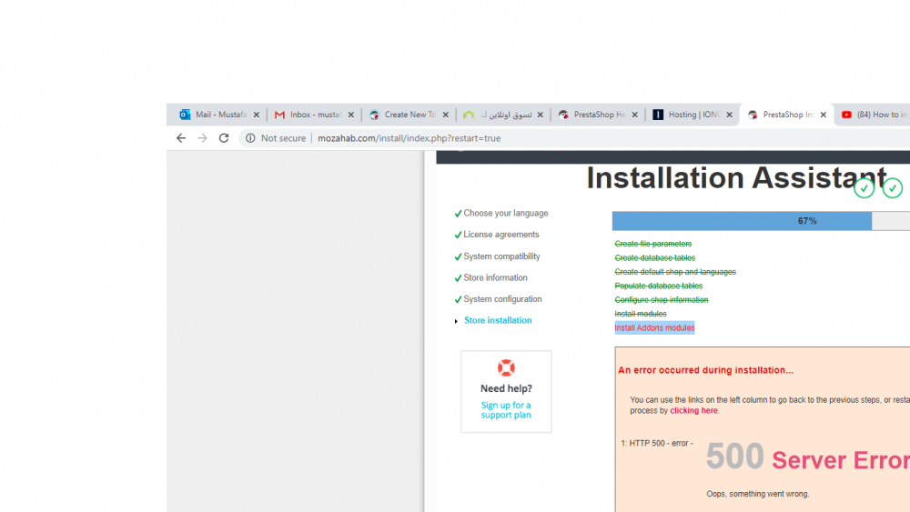

On 3/17/2020 at 8:12 AM, Mozahab said:
Obtuve el siguiente error
: HTTP 500 - error - 500 Error del servidor
en
El 67% instala módulos de complementos.

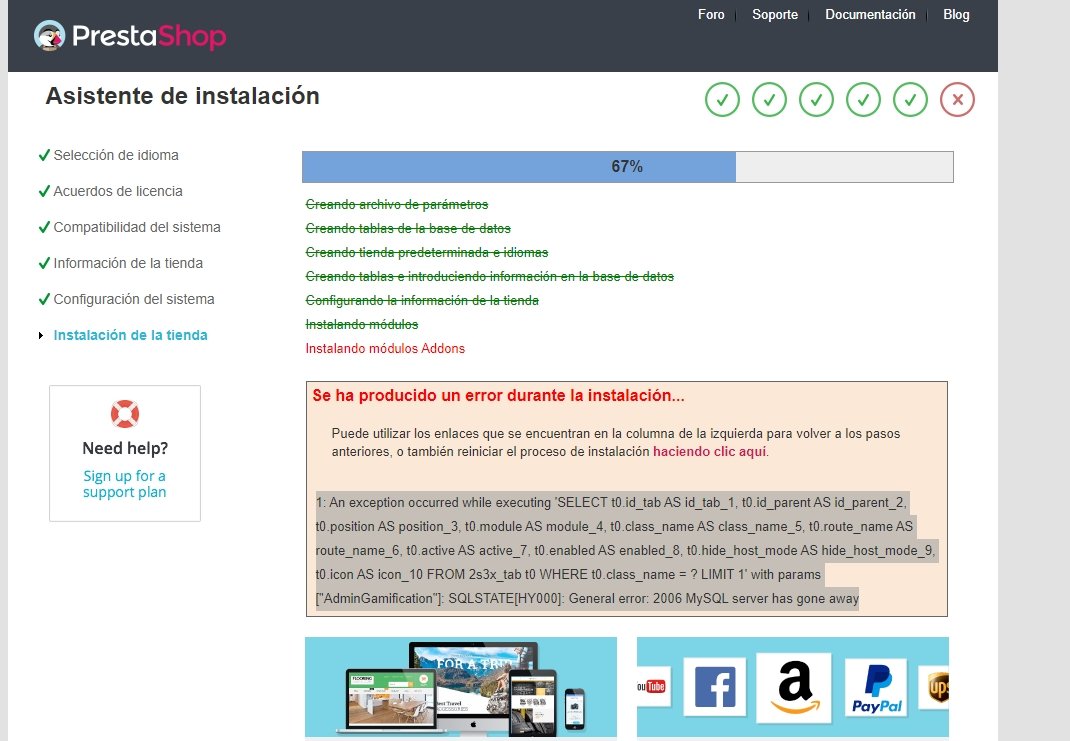

hello I have problems it does not exceed 12%
version 1.7.7.5 in PHP 7.3 FPM
1: HTTP 503 - error -
Service Unavailable
The server is temporarily unable to service your request due to maintenance downtime or capacity problems. Please try again later.
Edited by aceletta (see edit history)
hello I have problems 😪
1: An exception occurred while executing 'SELECT t0.id_tab AS id_tab_1, t0.id_parent AS id_parent_2, t0.position AS position_3, t0.module AS module_4, t0.class_name AS class_name_5, t0.route_name AS route_name_6, t0.active AS active_7, t0.enabled AS enabled_8, t0.hide_host_mode AS hide_host_mode_9, t0.icon AS icon_10 FROM 2s3x_tab t0 WHERE t0.class_name = ? LIMIT 1' with params ["AdminGamification"]: SQLSTATE[HY000]: General error: 2006 MySQL server has gone away

On 18/06/2021 at 15:55, aceletta said:
bonjour j'ai des problèmes  😪
1 : Une exception s'est produite lors de l'exécution de 'SELECT t0.id_tab AS id_tab_1, t0.id_parent AS id_parent_2, t0.position AS position_3, t0.module AS module_4, t0.class_name AS class_name_5, t0.route_name AS route_name_6, t0.active AS active_7 , t0.enabled AS enabled_8, t0.hide_host_mode AS hide_host_mode_9, t0.icon AS icon_10 FROM 2s3x_tab t0 WHERE t0.class_name = ? LIMIT 1' with params ["AdminGamification"] : SQLSTATE[HY000] : Erreur générale : 2006 MySQL server has gone away
Hello you find a solution please I have the same problem
