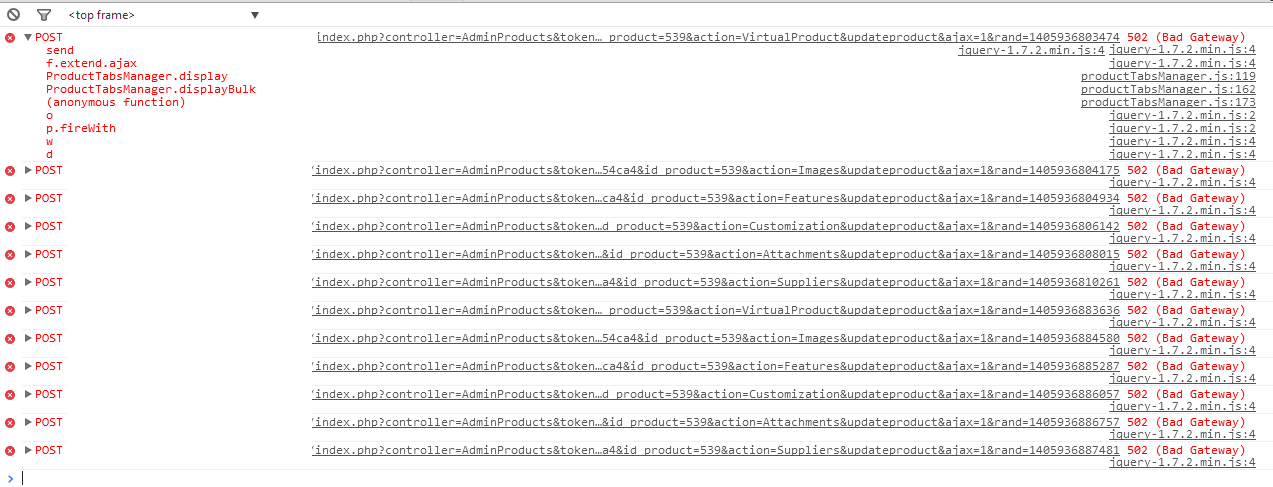

craftyhand Posted July 21, 2014 Share Posted July 21, 2014 I am using Prestashop 1.5.5 and getting above mentioned error while adding new or editing existing product. Site was functioning well until last 2 days but suddenly above message started poping up out of no where when I tried adding new product.I have searched for the solution for whole 3 days but in vein. I have changed forced compile and cache setting as well but made no difference. As suggested in the Prestashop forum, multi-store is disabled, changed define('PS_MODE_DEV', false) to define('PS_MODE_DEV', true), checked browser console using ctl + shift + J, to see if I can find tangible error message, 502 Bad Gateway error in jquery-1.7.2.min.js file ,but couldn't understand reason behind the error. I have attached error message for reference.The site is already up and running. Please help me solve this issue and I'd be really really thankful to you.Just for reference the site is hosted at godaddy.com (shared hosting).Regards Link to comment Share on other sites More sharing options...

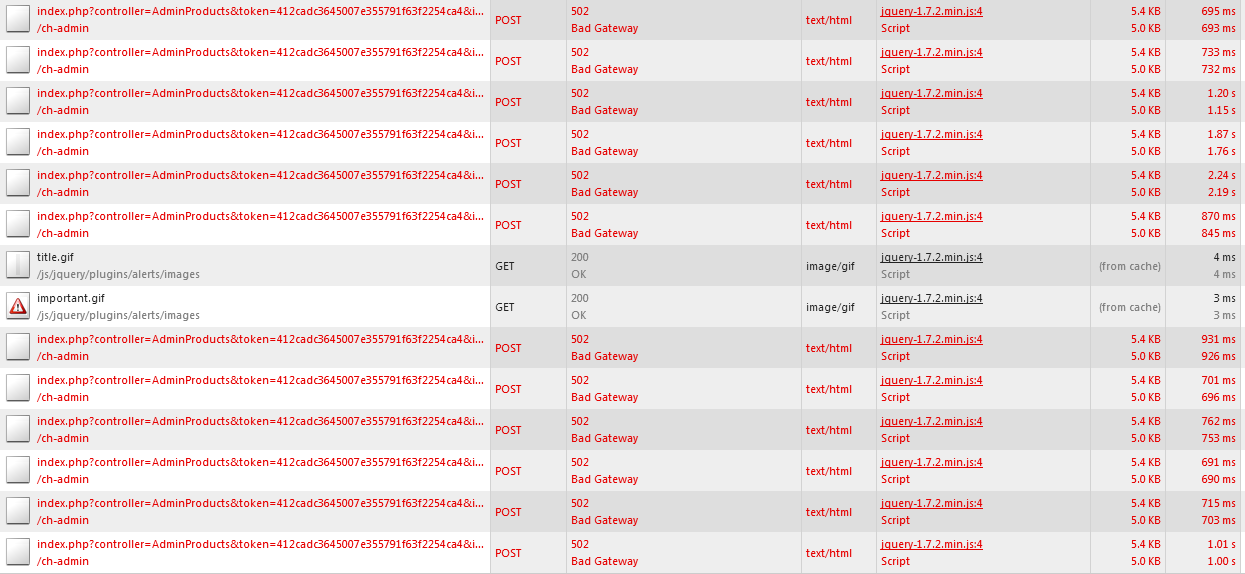

vekia Posted July 21, 2014 Share Posted July 21, 2014 for example, if you right click > open in new tab on one of the error from console, then if url address will appear in new tab, do you see the same gateway error? Link to comment Share on other sites More sharing options...

craftyhand Posted July 21, 2014 Author Share Posted July 21, 2014 (edited) for example, if you right click > open in new tab on one of the error from console, then if url address will appear in new tab, do you see the same gateway error? Thanks Vekia for prompt response. When I right click on the link and press display on new window from console as you have suggested, results in the new tab is inconsistent. Some times it displays "Error: Requested url content cannot be resolved." message, other times it displays the product input form without any error. After carefully observing these different result, I found that if I click open the link immediately after getting the message in console, it displays "Error: Requested url content cannot be resolved." message. But if you wait for a while(say a minute) and then click the same link in new tab, it displays the product input form. Weird behavior. Edited July 21, 2014 by craftyhand (see edit history) Link to comment Share on other sites More sharing options...
