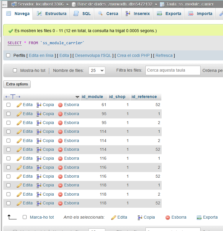

Eric WobyWeb Posted December 11, 2020 Share Posted December 11, 2020 Ok I found a solution as I was facing the very same issue. I am sorry I will be technical as I didn't find where in the backend we can fix it. So I will share it here, the link within the table ps_module_carrier was not made so I had to insert manually the id_module for each payment module, 1for id_shop as I habe only one shop and the id_reference of the selected carrier which doesn 't display any payment. example : INSERT INTO `ps_module_carrier` (`id_module`, `id_shop`, `id_reference`) VALUES ('81', '1', '97'); in sha Allah, It can help someone, sorry for the technical background needed. 3 1 Link to comment Share on other sites More sharing options...

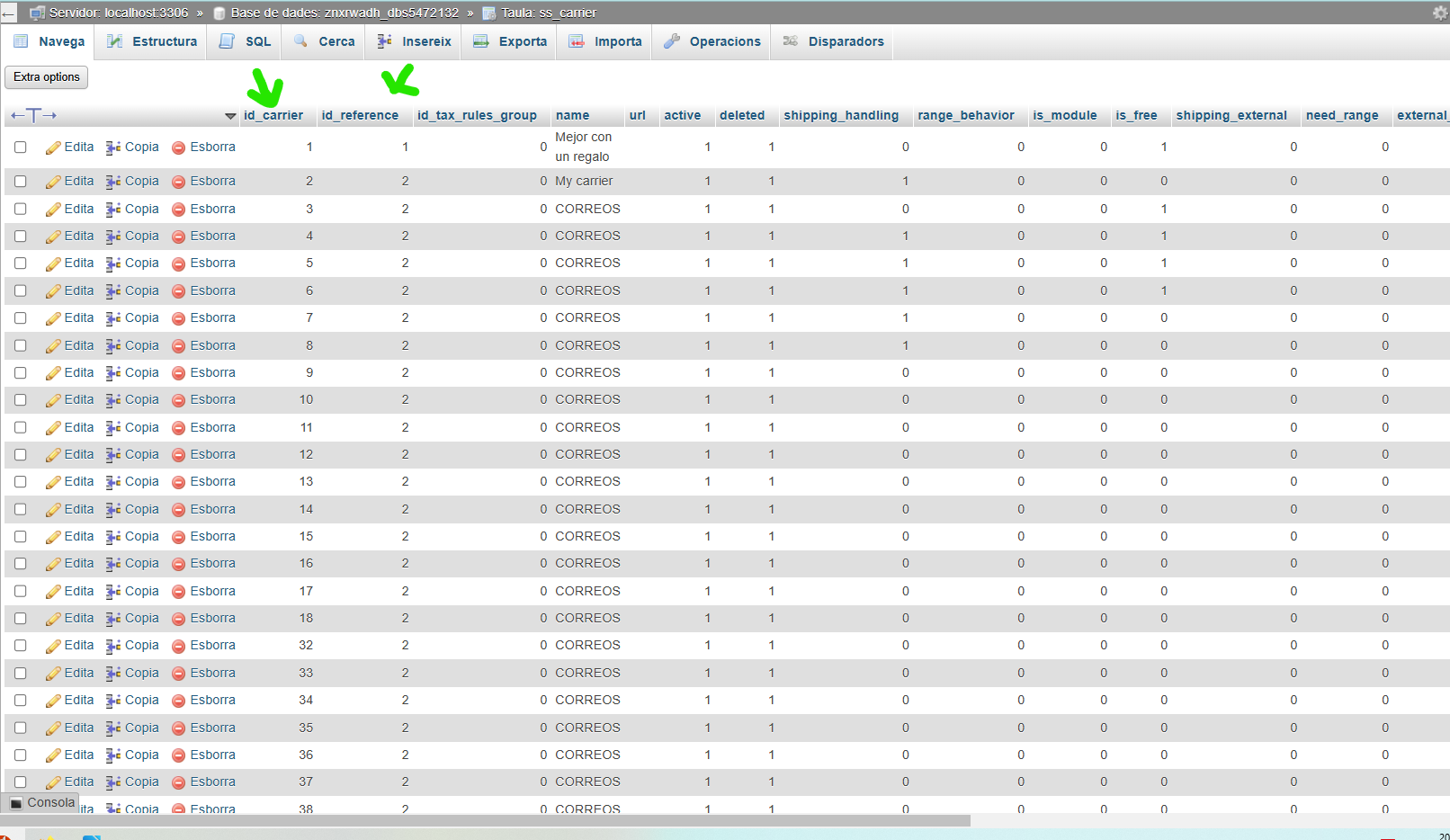

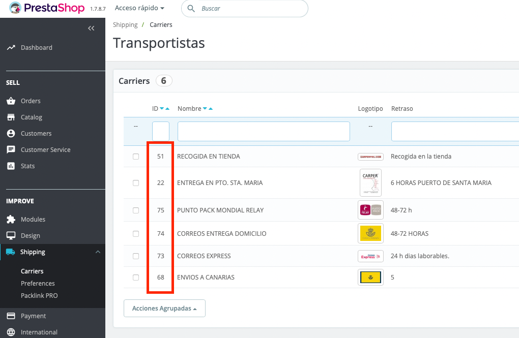

Msaustral Posted January 29, 2021 Share Posted January 29, 2021 Hi Everyone here is a workaround 1.- Find the table prefix_carrier -> take note of the field id_reference of all your active carriers 2.- Find the tables prefix_module -> take note of the field id_module of all your active payment module 3.- Find the table prefix_module_carrier -> you will see that there are missing entries for your carrier id_reference with the payment id_module associated, create the missing one the row id_module is the id of the payment module that you have active the row id_reference is the id of the carrier that you want thar payment to be available. Still do not know what is causing these records to disappear but this solves the issue, have a good day :) 2 3 Link to comment Share on other sites More sharing options...

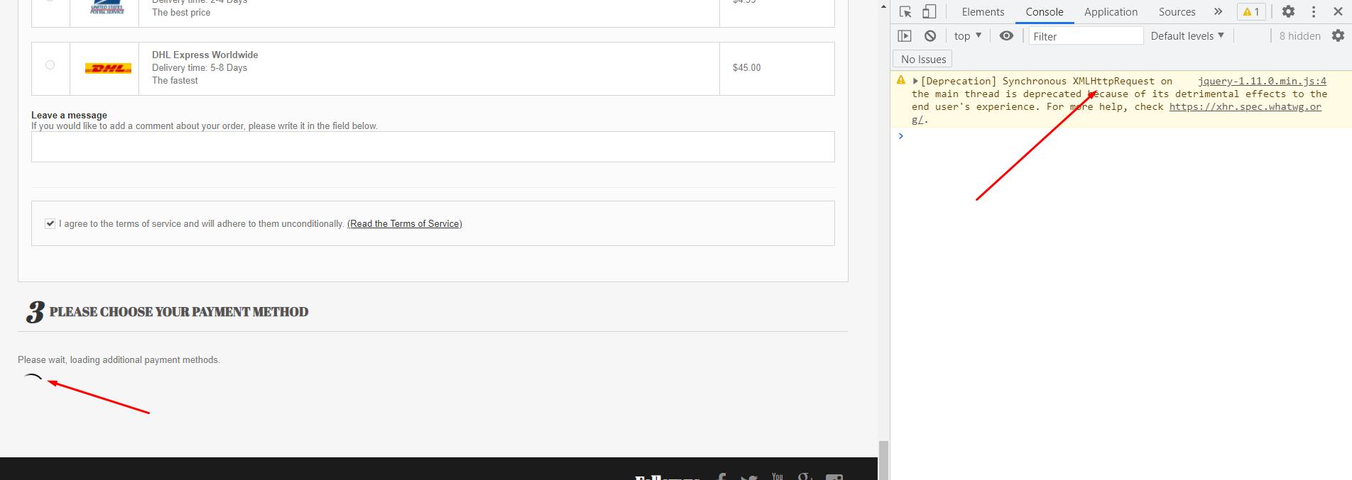

Terryta1 Posted August 9, 2021 Share Posted August 9, 2021 On 6/8/2020 at 8:40 AM, El Patron said: Hi @El Patron Firstly, I'm sorry to reaching out in wrong topic channel. But I just want to ask you one thing. I changed the Order process type from "standard" to "Once-page checkout", but the payment method doesn't appear. The loading spinner icon loads forever. What I can only see is only an warning on console of browser. Could you give me answer for this? Sorry again. Link to comment Share on other sites More sharing options...

Spanish Snapper Posted October 12, 2022 Share Posted October 12, 2022 On 1/29/2021 at 1:48 AM, Msaustral said: Hi Everyone here is a workaround 1.- Find the table prefix_carrier -> take note of the field id_reference of all your active carriers 2.- Find the tables prefix_module -> take note of the field id_module of all your active payment module 3.- Find the table prefix_module_carrier -> you will see that there are missing entries for your carrier id_reference with the payment id_module associated, create the missing one the row id_module is the id of the payment module that you have active the row id_reference is the id of the carrier that you want thar payment to be available. Still do not know what is causing these records to disappear but this solves the issue, have a good day If you have a lot of carriers with similar names and aren't sure what IDs you should use, I found it helpful to grab the IDs from the admin panel. Link to comment Share on other sites More sharing options...

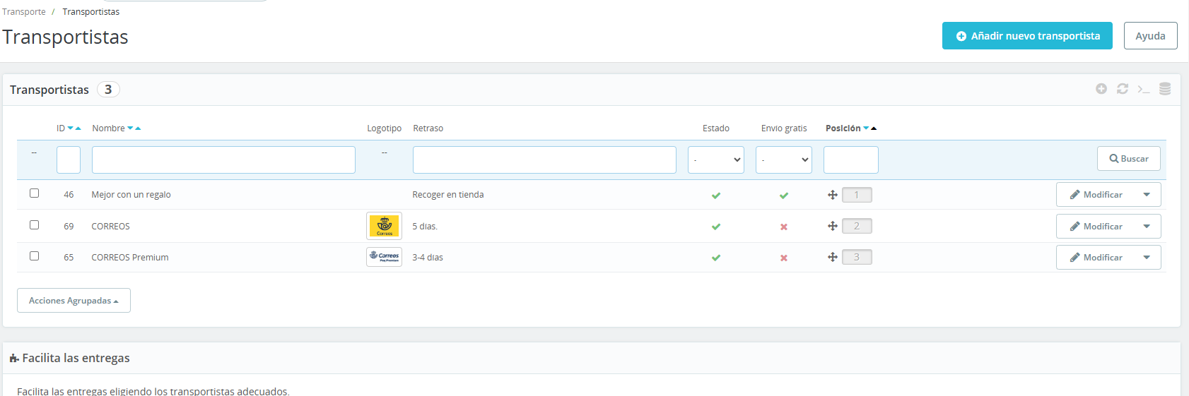

brunosalter Posted January 27, 2025 Share Posted January 27, 2025 (edited) Hello everybody, see if someone can help me. I have a problem in my PS 1.7 shop. Payment methods have disappeared. I tried this to no avail. On 3/30/2024 at 9:58 AM, RobbieBlokeToys said: Just being a good citizen and explaining what happened with me regarding this problem. While testing a new theme and going back to the original one while I fix images etc everything was knocked out of whack. I thought i was just hook positions but Prestashop Checkout module was also affected. There is no way to know this from the back end. Everything looks normal. Customers couldn't place orders at all. This problem was solved by resetting the module and logging back into PayPal. I would recommend people try this first before moving other things around that might cause more problems. This is quite a stupid bug for an e-commerce platform to have. The priority should always be that customers are able to purchase. Everything else should be secondary to that. Prestashop should be hardened against the possibility any new module, theme, or minor change could simply close off all payment capability without warning. This should be added to the (already long) list of things PS needs to fix. Uninstalled /Installed one method to check if worked but didnt come back. When I go to redsys gateway to configure i get this pile of errors in debug mode, actually I cannot switch it off. Here an extract. Two types of error. Notice en línea 114 en archivo /home/znxrwadh/public_html/classes/helper/HelperForm.php [8] Undefined index: type And Notice en línea 1497 en archivo /home/znxrwadh/public_html/var/cache/dev/smarty/compile/db/e3/70/dbe370e662a095f9efee5625c6bee66724095af2_0.file.form.tpl.php [8] Undefined index: type There are hundreds of the second one. This under solution couldn figure out. 1- In the DB, under prefix_carrier there are ids 1 (pick up), and 2 (Correos), Many Correos rows due maybe to different configurations ....In PS backend there are three; pick up id is 46, Correos standard is 69 and Correos Premium 65. Doesnt match. 2- In prefix_module_carrier there are three columns. (Image attached) These are the ones but here I need some help id_module id_reference On 1/29/2021 at 1:48 AM, Msaustral said: Hi Everyone here is a workaround 1.- Find the table prefix_carrier -> take note of the field id_reference of all your active carriers 2.- Find the tables prefix_module -> take note of the field id_module of all your active payment module 3.- Find the table prefix_module_carrier -> you will see that there are missing entries for your carrier id_reference with the payment id_module associated, create the missing one the row id_module is the id of the payment module that you have active the row id_reference is the id of the carrier that you want thar payment to be available. Still do not know what is causing these records to disappear but this solves the issue, have a good day Edited January 27, 2025 by brunosalter (see edit history) Link to comment Share on other sites More sharing options...

brunosalter Posted February 3, 2025 Share Posted February 3, 2025 (edited) 6 hours ago, zeisei said: I solved it by going to customer Groups and editing all of them to make sure I enabled in the bottom of the page the Payment module/method and then save. I had to check again when another change was done. Thanks Zeisei. I finally stopeed searching what the problem was for three hours and went for a backup of a day before. This happened all of a sudden with no action from our part involved. I dont find customer groups anywhere. Please specify. Just in case this happens again. Found it!! Thank you Edited February 3, 2025 by brunosalter (see edit history) Link to comment Share on other sites More sharing options...
