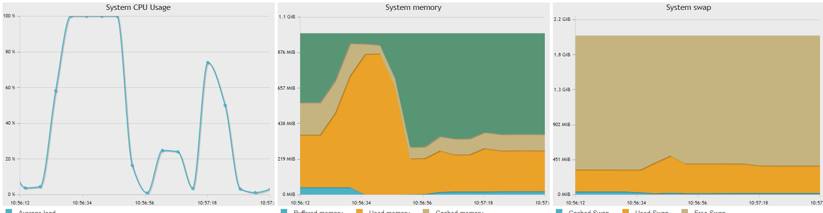

n_s_simpson Posted August 19, 2015 Author Share Posted August 19, 2015 (edited) in phpMyAdmin I've been monitoring what's going on while searching for just the word "A4" and then pressing show all. CPU goes 100$ and memory is almost all used up too. Swap isn't used that much though. When the white page appears everything settles back down. In there it as advisor section but it mainly talks about how the PS tables should be indexed differently, etc. If you click on the link in my previous post you'll see the following: 58820 ms - You'd better run your shop on a toaster I'm tearing my hair out so could really do with some help if someone has the time to spend I know that I should expect a slow speed due to my server but what's causing the white page? Surely the server can return and load the results eventually. Edited August 20, 2015 by n_s_simpson (see edit history) Link to comment Share on other sites More sharing options...
n_s_simpson Posted August 20, 2015 Author Share Posted August 20, 2015 (edited) In the monitor section of phpMyAdmin: Before pressing "Show All" the memory usage was around 550mb and processor was idol. Pressing "Show All" the memory usage jumps to almost use up the full 1GB the server has to offer and the swap memory jumps a little. Blank screen. Processor drops to idol, memory drops to around 400mb. Interestingly, when I use the search you can see the processor being used but the memory usage stays pretty level. It's only when I press "Show All" that it goes mental. There's nothing in syslog about mysql being killed and the website still functions normally. Does anyone have a clue about what's going on? Thanks Nick Edited August 20, 2015 by n_s_simpson (see edit history) Link to comment Share on other sites More sharing options...

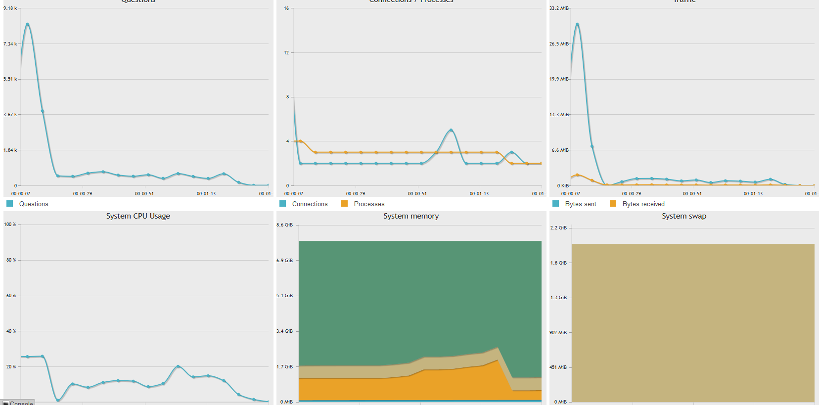

n_s_simpson Posted August 20, 2015 Author Share Posted August 20, 2015 (edited) I thought I should try 4 cores and 8GB RAM but searching for "the" and then Show All still causes 500 error. Take a look at the screenshot to see that the processors hardly did anything. Coincidentally, even will all that power larger searches were no quicker. Oh, and just to recap - turning on APC (aka APCu) doesn't speed anything up from what I can tell. However, instead of large searches eventually showing me a 500 server error page I just get a blank page instead. All fun and games. HELP!! Edited August 20, 2015 by n_s_simpson (see edit history) Link to comment Share on other sites More sharing options...

n_s_simpson Posted August 28, 2015 Author Share Posted August 28, 2015 (edited) HI Dh42, thanks for your time earlier. I've just spun up a DigitalOcean droplet with 16GB RAM and 8 CPUs. I changed the php.ini file so it could use all the RAM (for testing purposes). With APCu off in the PS BO I tried doing a search for "the" and pressing Show All but after 10 minutes it ate up all the RAM then crashed giving me a 500 error! With APCu turned on in the PS BO the memory stays still for about a minute, then creeps up to about 4.5GB before crashing at around the 3 minute mark with a white screen (maybe I have a timeout set somewhere for APCu). The total processor usage moves around the 0-10% mark so I guess it's not going to be any quicker than the cheaper options DigitalOcean have. I then tried to load the first 2000 products and it used 8GB RAM and after a long time it eventually loaded. I turned on profiling and ran it again so I have that info if that's useful (this time I got a complaint about a long running script located in /themes/default-bootstrap/cache so not sure what that's all about but I closed it and the page loaded). So does this mean that PS is incapable or returning over 3000 products and displaying them all on the one page? I can't get over how much RAM is used to do all the calculations and I wonder if that's normal. Cheers Nick Edited August 28, 2015 by n_s_simpson (see edit history) Link to comment Share on other sites More sharing options...
Dh42 Posted August 28, 2015 Share Posted August 28, 2015 In all reality what you are asking is a difficult question that depends on a lot of factors. Can it do it? Yes it can. Was it made to do it? No not really. On top of that your server set up is part of the problem as well. You are running fastcgi, which is like a drag racing car. It is great at small quick things like loading pages and other quick type requests like that. But it is not good at brute force tasks. That is why they have the wait timeouts built in by default, because the upper level memory handling is not that great. Not to say it is bad, it is actually very good. It is just not made to do what you are wanting to do. That is why I asked if you had suPHP installed. It is the brute force interpreter. It is made to handle really inefficient task like loading that much data. But the caveat to using it is you cannot use an opcache nor can it serve pages near as quickly as fastcgi. So there in lies your problem. One thing I would explore as well is your my.cnf file. I would increase the buffers on it by double and I would also look at your memory setting too. Because the wait time you are experiencing is coming directly from mysql, so it might be able to be tuned a bit to help. You might try installing mysqltuner.pl and see if it can give you any suggestions. If none of that works I would look at spinning another instance and running it with a brute force database for search results only. You could more than likely tap into PrestaShop's mysql slave and just return results from that database. Link to comment Share on other sites More sharing options...
n_s_simpson Posted August 28, 2015 Author Share Posted August 28, 2015 Cheers for the clarification. I'll be removing Show All over the weekend now I know it's not my server that's the problem. Interestingly phpMyAdmin has it's own Global Variables, which are different to those in my.conf. Any ideas which one is actually used? Cheers Nick Link to comment Share on other sites More sharing options...
