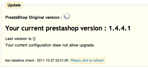

post-202354-0-84356200-1322221198_thumb.pngThis is really unfortunate that something that once worked in 1.4 is now broken. I am trying to go from 1.4.4.1 to 1.4.6
Only after changing the them to the Prestashop theme would the v0.2.2 autoupgrade module install. The module thinks my shop is up to date, and will not let me run the updater. I will wait for the fix.
