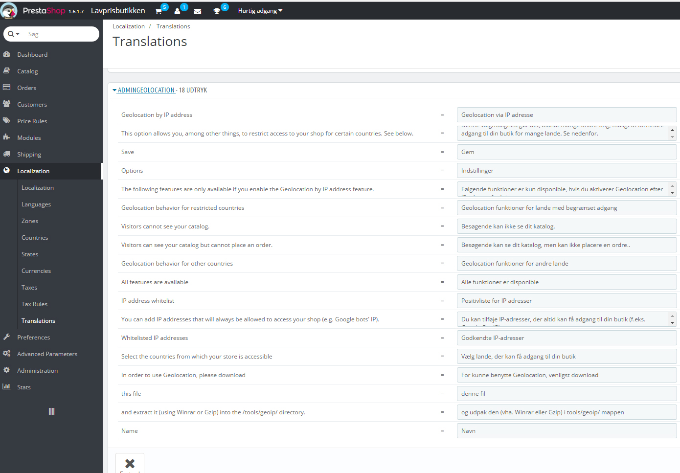

I am in the process of translation into Danish language and have imported the Danish languages and has translated BackOffice etc, but could not find any translation option for these (marked in red) - where can I find it?

Generally if you change the language of your user, they should come translated. Danish is translated in 94%, perhaps ther is something missing: https://crowdin.com/project/prestashop-official
The translations you will find at: localization -> translations -> back-office translations. See screen attached.

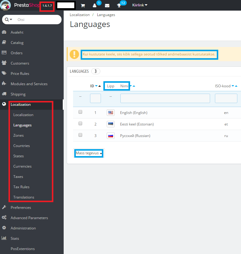

Same problem here. If I change BO language other than English, then BO menus are not translated and I'll have to do translating in DB. I can see, that http/translations/et/tabs.php are translated but in DB ps_tab_lang are all in English.

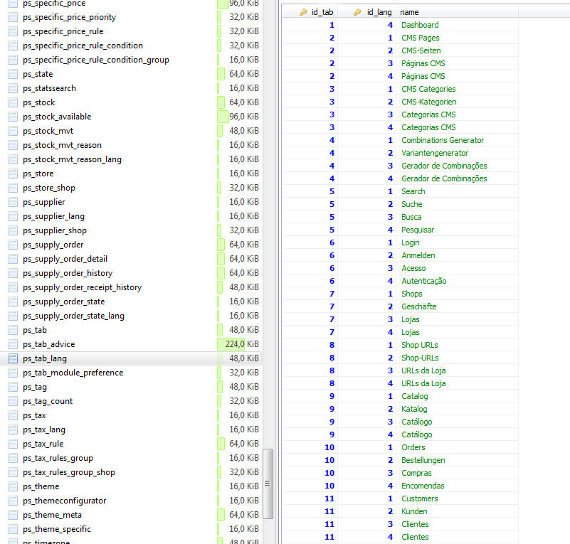

PS_tab_lang should be in English for the ID English. Of course you can change them there on database, but not for the ID EN. Cannot tell you which ID English is having for you, cause it depends on the localization pack, this means of the install pack you used. If you change the English translation there, it could be that your back-office translations will fail in some parts, and if you change employee language to whatever it is not your main language, than he will see them not in English, but in the language you changed directly on database. What you can do, is to add for the id_tab the specific id_lang and the translation, if it is missing.
Check your database ps_tab_lang if there are also other languages added than ONLY English. See sample I've attached. I'm mainly using English (which is ID 4 for me), Portuguese Portugal, Portuguese Brazil, and German. For each Tab there is added a translation with the specific language. (Dashboard is not translated to the other languages and only available for English in my case).

I checked it and in fact this is weird, because though Estonian translations are only completed to 87% (average for 1.7 and 1.6), this does not apply to tabs and admin translations. Both are 100% translated.
Did you clear cache and browser cache?
If this doesn't work and if you are a bit skilled, you should download a fresh translation directly from Crowdin (https://crowdin.com/project/prestashop-official), extract the Estonian translation from the 1.6 subfolder in the zip file and upload admin.php and tabs.php directly to your webspace.

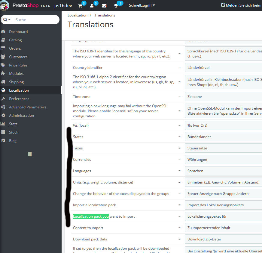

If you mean selectshop.at's last posted image, forget it! It shows part of the database.This is no solution for your problem.
What you need to do is this:
  • Go to Localization --> Translations
    Type of translation: Back office translations
    Select your language: Danish
  • Click Button Modify
  • Click Button Close all fieldsets
  • Click button once again, which now is renamed to Expand all fieldsets
  • Press CTRL+F to open the little search field in the bottom left of your browser (fastest way to find any item)
    Enter for example "behavior of the taxes" for a quick jump
    or
  • just search for section AdminLocalization
There you find the untranslated items shown in post #1 of this thread. :)

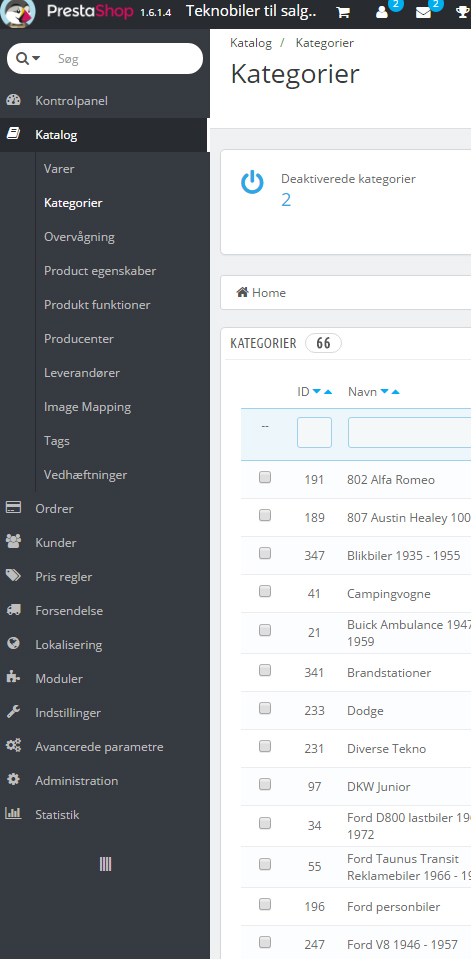

I deleted browser cache, examined all the fields in back office transilations and all the fields are correctly translated into Danish, so I still do not understand that it has not changed anything in the back office - all fields are still in English.
I have previously worked with 1.6.1.4 - see my netshop www.teknobiler.net where everything pretty much is as it should be and as I have not had the big problem with setting up or translate.
I have tried to import the language pack that I use here, but without any effect.
Can there be a mistake in 1.6.1.7?
I base my suspicions on it with translations and another problem - the new pictures in "Slide Show to your web site" will not be shown - it is they who are the new version which still appear.
I enclose a screen dump from my netshop www.teknobiler.net

Sorry for the late reply. I tested this behaviour and I hopefully found out what happens though I don't have any solution yet:
I tried to localize this bug: the wrong items (the German translation is about 2 years outdated) are part of /install/langs/de/data/tab.xml.
During the installation process the content of this file containing the tab names is stored in the database table ps_tab_lang.
In former releases Prestashop took the tab names from /translations/tabs.php. But currently it seems that the names are grabbed alone from the database table. That wouldn't be a problem, if automatic language updates via BO would alter the table fields. But exactly this doesn't happen. You may change translations as often as you want. If you don't do it directly in the database or the BO adminstrations menu, it doesn't change anything.
PrestaShop ignores the /translations/tabs.php. And this affects not only the main menu but the headlines in the called pages too. This causes a mix of two languages.
And just for the record: It is no longer possible to change the menu language of the BO. Even when choosing English language for an employee, the orginal default language tabs will not change. Which means, you need to change it in the DB or in BO Administration --> Menu Items.
And even more: When you import a new language, the menu items will be set to default language (e.g. import French into a shop with default language German, and the new menu items in the database will be set to the German translations!).
