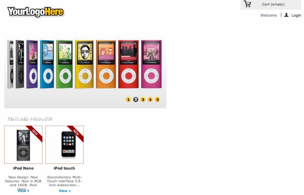

sughoi Posted July 24, 2013 Share Posted July 24, 2013 Hello everyone, I have some problems with custom template ... I want to ask how to change all the column to be in the middle? I've tried to remove the hook left and right but it makes the content is on the left. I hope some Master out there can advice on how to solve it .. Note: The products I sell and show only two items. Thank You Link to comment Share on other sites More sharing options...

vekia Posted July 24, 2013 Share Posted July 24, 2013 from the screens that you attached - it looks like default home slider module what you mean by "product" blocks ? can you explain a bit more? what element you want to "center" ? Link to comment Share on other sites More sharing options...
sughoi Posted July 24, 2013 Author Share Posted July 24, 2013 from the screens that you attached - it looks like default home slider module what you mean by "product" blocks ? can you explain a bit more? what element you want to "center" ? Sorry if I was not clear in explaining it. I am attaching some photos again and I hope it can explain my question Link to comment Share on other sites More sharing options...

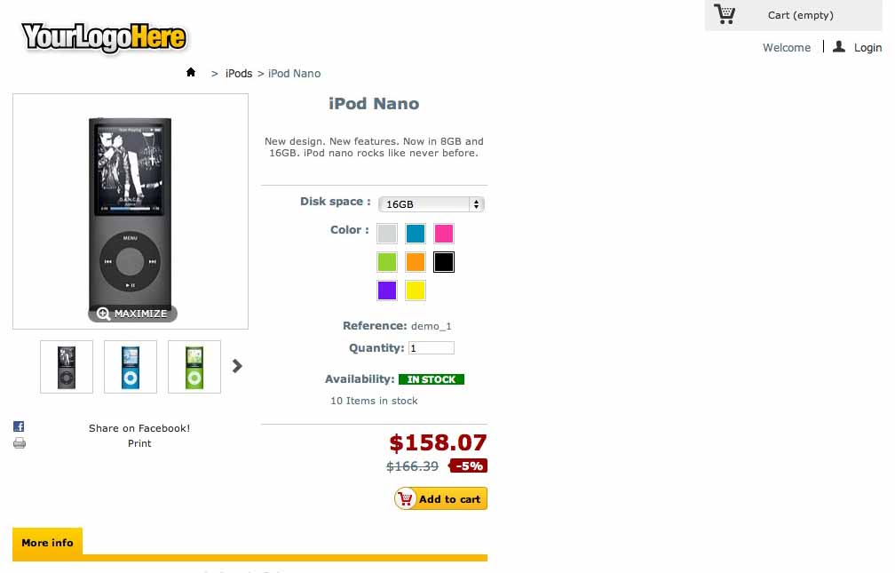

Jiten rash (away) Posted July 24, 2013 Share Posted July 24, 2013 to redirect better do fron cpanel or paste it to header.tpl <meta http-equiv="refresh" content="0; ,URL=URLHERE"> to move home featured in the center add this to home featured.css #featured-products_block_center {width:530px; margin-left:330px; } add this to global.css body#product #center_column {width:650px; margin-left:330px;} body#product #left_column,#right_column {display:none;} Link to comment Share on other sites More sharing options...

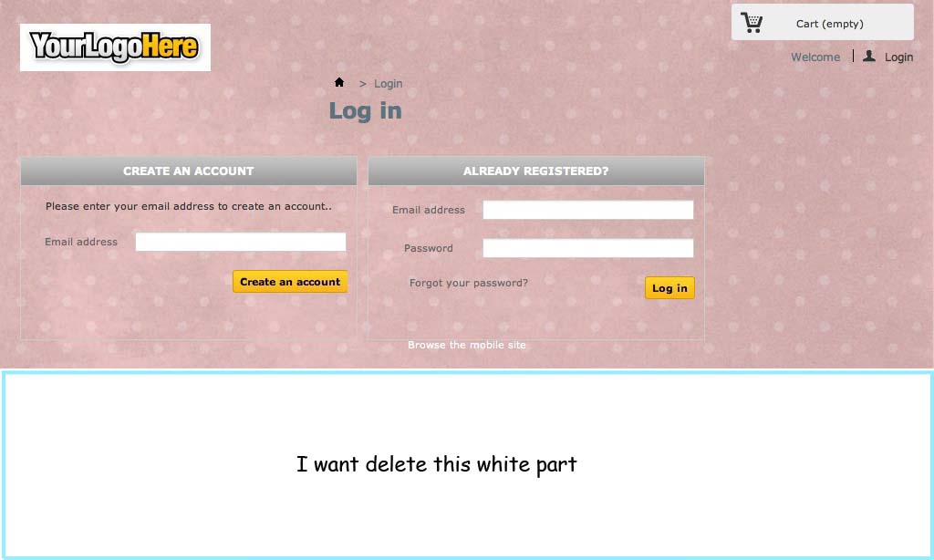

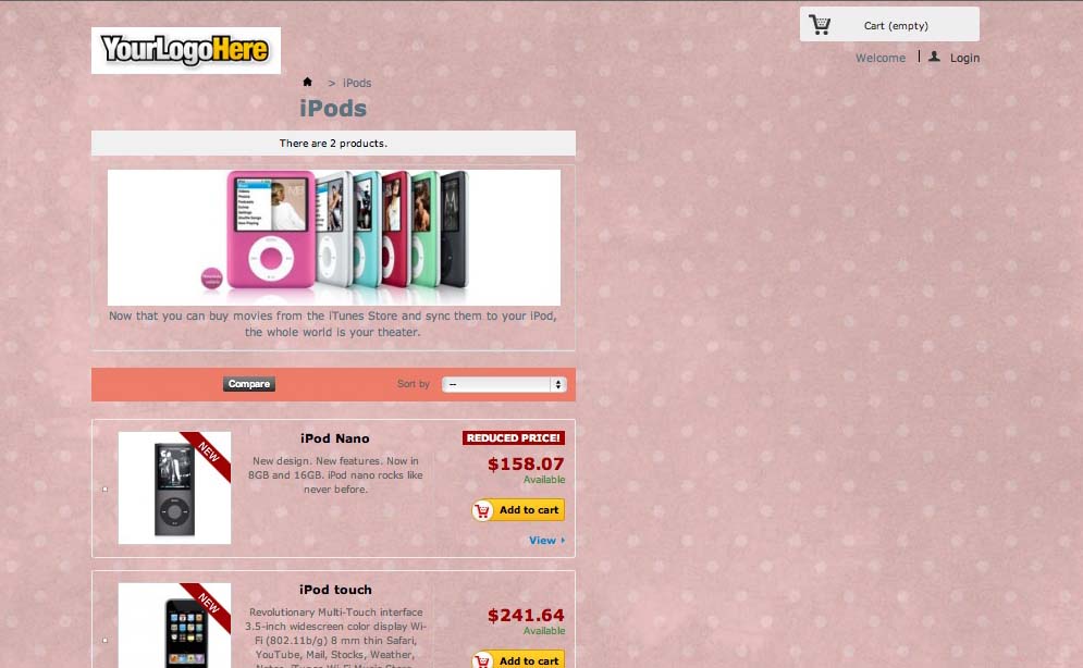

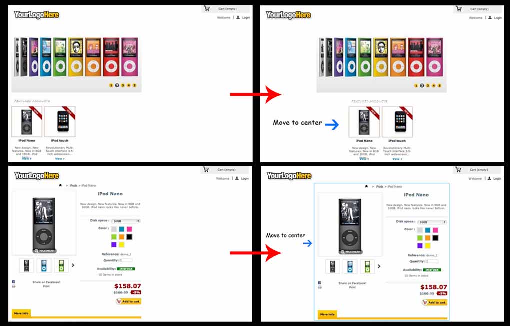

sughoi Posted July 25, 2013 Author Share Posted July 25, 2013 (edited) Thank you for Vekia and Jiten you guys are very helpful. I've tried that you suggest and it works the way I expected. But there was another problem, appears white block at the bottom (Pict - Untitled 3). Any idea how can I remove that white part, because I want it full height? Another question I want to make this part also is in the middle (Pict - Untitled 4). How I can make it at the center? Edited July 25, 2013 by sughoi (see edit history) Link to comment Share on other sites More sharing options...
Jiten rash (away) Posted July 25, 2013 Share Posted July 25, 2013 (edited) to put in the center column add to global.css body#category #center_column {width:650px; margin-left:330px;} body#category #right_column {display:none;} body#category #left_column {display:none;} to remove white space body#my-account #center_column {width:650px;} body#my-account #columns {height:300px;} body#my-account #account-creation {height:100%;} Edited July 25, 2013 by Jiten rash (see edit history) Link to comment Share on other sites More sharing options...
