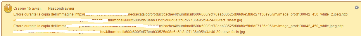

Importing pictures not working with CSV file
I have the URL correct, as I can click the link and see the photo, but when I put a link in a CSV file to import I always get the message "Error copying image: http://www.mydomain.com/image.jpg". Obviously this is along with the product details.
As I say, if I click the same link it goes to the picture fine, so I know it is there. Any ideas why it is happening ? I have made sure Prestashop sees the correct column as Image URL while importing. I have tried both a folder I made and the P folder. I have changed to 777 for permissions. I have tried a few different images.
Anything else I can try ? Thanks.
