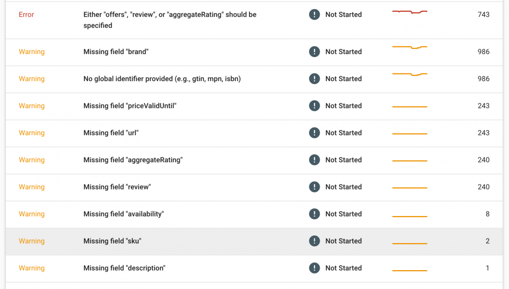

mattwilkie Posted February 24, 2019 Posted February 24, 2019 I have had a Prestashop site for around 8 years but recently got forced to upgrade (had left it alone since original install due to the amount of work transitioning to a newer version). However my host upgraded and the site stopped working forcing me to upgrade. I have lost a lot of my position with the SEO as I have had to rebuild the site. I have gone through the basics of Meta tags etc. But currently have this showing in Google Analytics and not sure what its asking me to do :- either "offers", "review", or aggregaterating should be specified Now I don't do offers, reviews and not sure what it means with aggregaterating. But my site is a basic setup with no additional modules that could effect the SEO side so not sure what it wants me to do any ideas appreciated. 1 Share this post Link to post Share on other sites More sharing options...

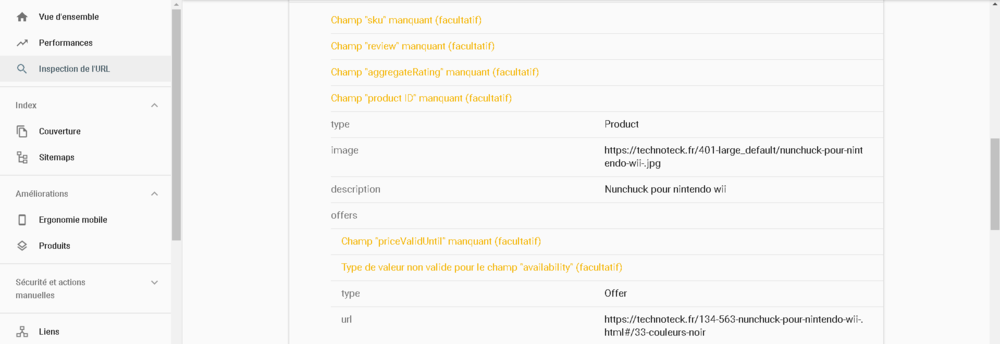

KamilPL Posted February 27, 2019 Posted February 27, 2019 Me to have this problem „offers”, „review” lub „aggregateRating” My developer say that on the https://search.google.com/structured-data/testing-tool everyting is ok Share this post Link to post Share on other sites More sharing options...

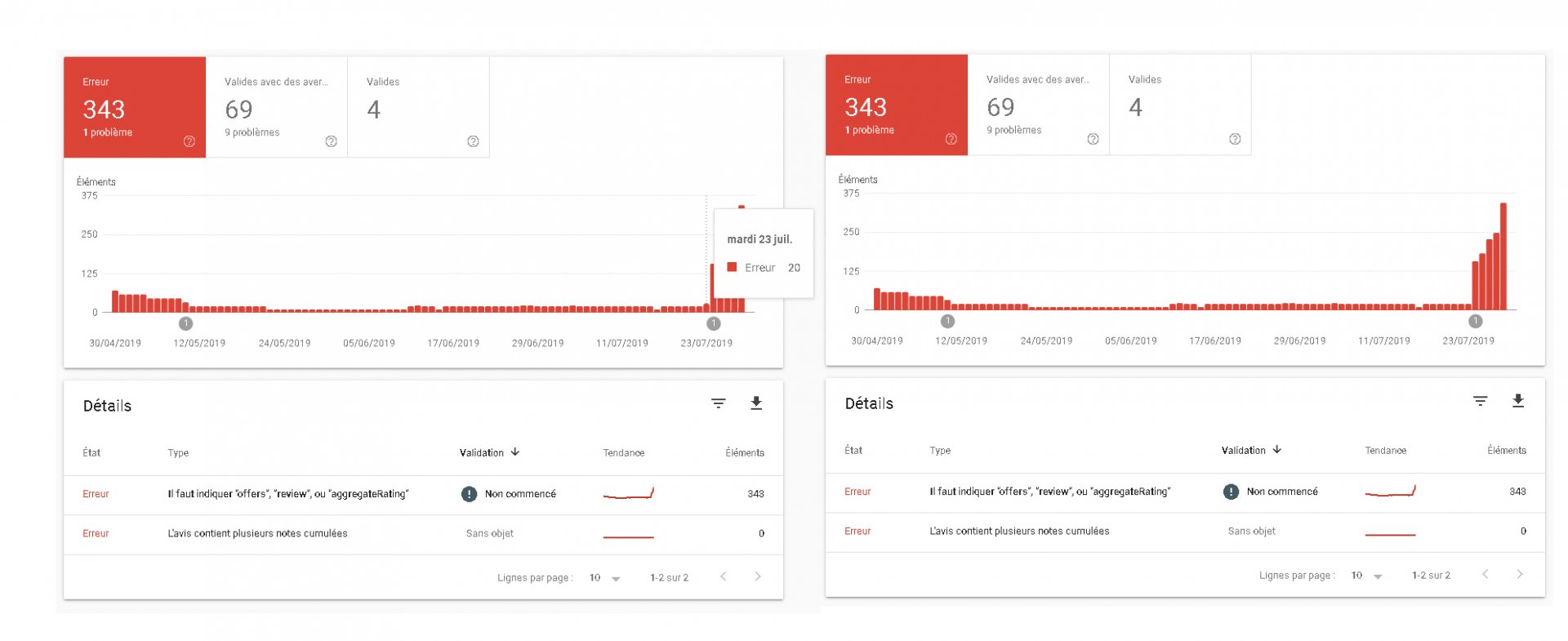

wess france Posted March 19, 2019 Posted March 19, 2019 Hello yes indeed this new error appeared 48 hours ago So, the method proposed by Jaep at the beginning Google has changed the conditions for the products again. I tried to see my webmaster that I have a solution on my side if anyone in I am a taker also thank you Share this post Link to post Share on other sites More sharing options...

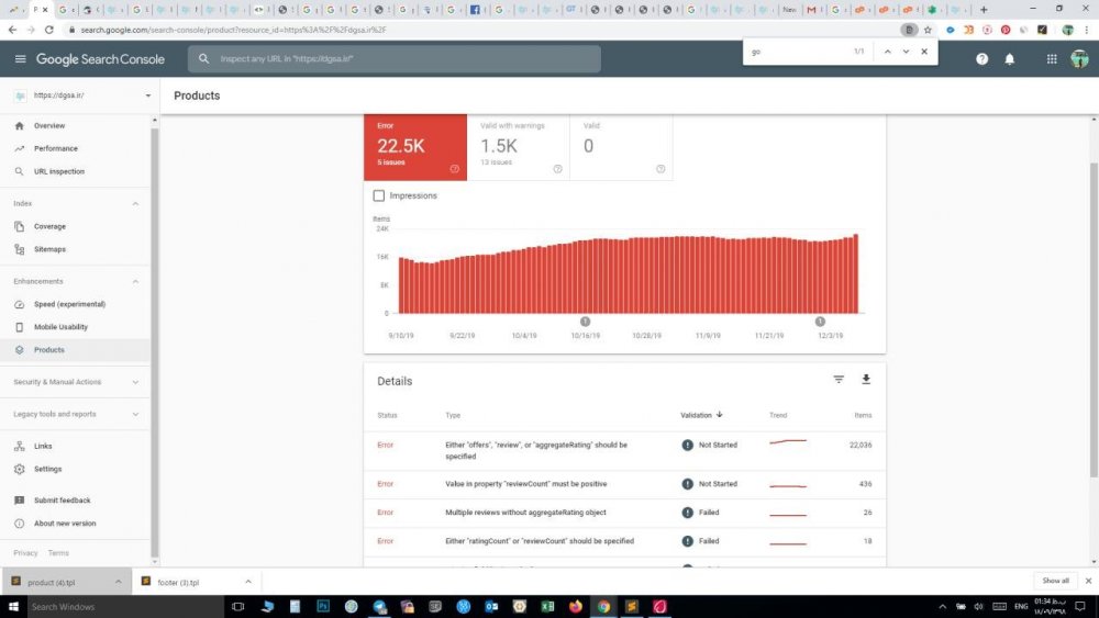

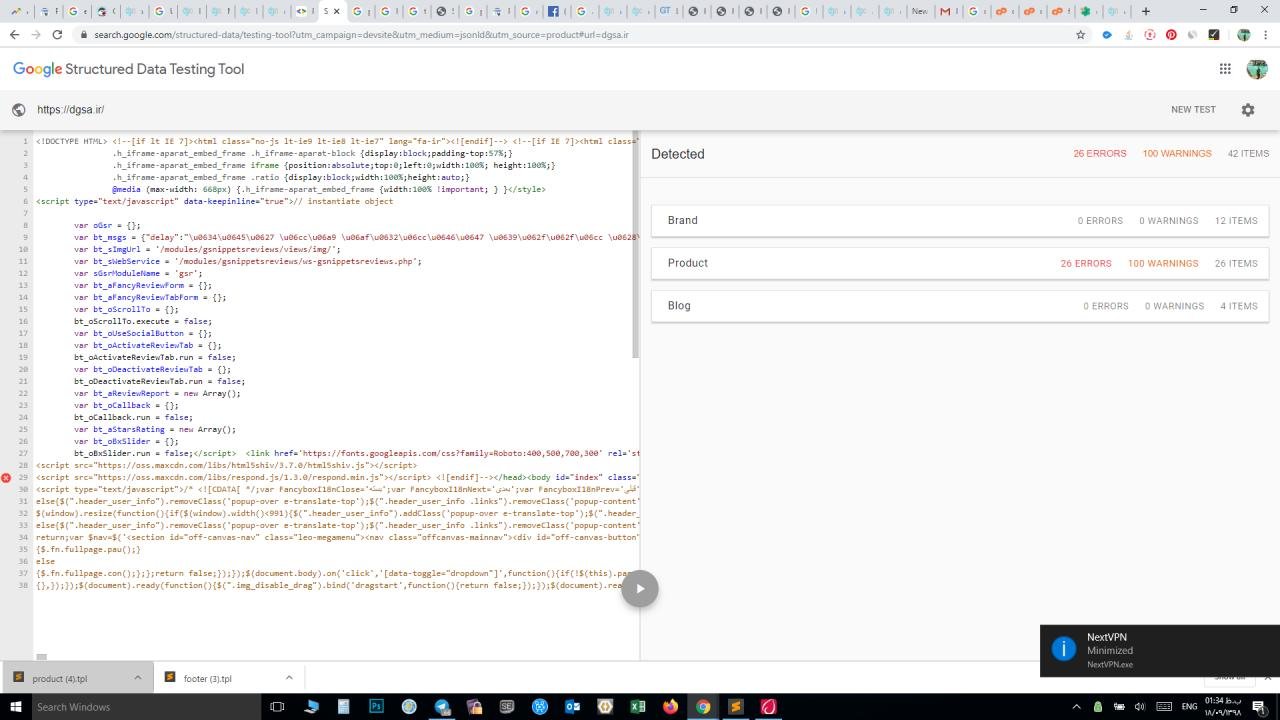

yama Posted September 17, 2019 Posted September 17, 2019 Did you try this fix? https://github.com/PrestaShop/PrestaShop/issues/12687 1 Share this post Link to post Share on other sites More sharing options...
ender666 Posted September 25, 2019 Posted September 25, 2019 this worked for me.. themes/########/templates/catalog /_partials /miniatures/product.tpl I modified this piece of code: {block name='product_price_and_shipping'} {if $product.show_price} <div class="product-price-and-shipping pricehv"> in this way: {block name='product_price_and_shipping'} {if $product.show_price} <div class="product-price-and-shipping pricehv" itemprop="offers" itemscope itemtype="https://schema.org/Offer"> 1 Share this post Link to post Share on other sites More sharing options...

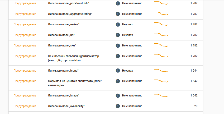

Velizar Vasilev Posted November 6, 2019 Posted November 6, 2019 Dear All, for the 1.7.6.1 the problem is the same. I found a video on youtube about the problem. Because I am beginner in the PS, may somebody with more experience check and send feedback are those changes in the .tpl looks OK or not? Hope for some replays. Best regards, Share this post Link to post Share on other sites More sharing options...

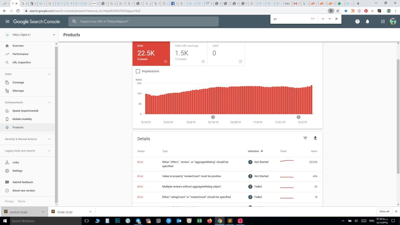

FoodAssets Posted February 10, 2020 Posted February 10, 2020 (edited) Our efforts to unravel the "instructions" above in this thread and fix our Google Search Console errors have failed (and broke our site). The problem for us is the instructions do not actually contain sufficient step-by-step information. We are running Prestashop 1.6.1.2 with modified product.tpl (no child themes). Google Search Console is producing over 700 errors: Error "Either "offers", "review", or "aggregateRating" should be specified There are also warnings on every product: Warning Missing field "brand" Warning No global identifier provided (e.g., gtin, mpn, isbn) Warning Missing field "priceValidUntil" Warning Missing field "url" Warning Missing field "aggregateRating" Warning Missing field "review" Warning Missing field "availability" Warning Missing field "sku" Warning Missing field "description" We are using Customer Ratings and Reviews Pro + Google Rich Snippets v4.1.6 - by Business Tech - which was a massive mistake in our opinion, this module has never worked properly for us, nor could we ever get it to update. It's also incredibly slow to load, or to perform any administrative functions (such as approve reviews), taking nearly 5 minutes to display the admin screens. We've contacted Biz Tech about these Search Console errors and they refused to help (their answer was buy the newer version). They refused to answer our specific questions regarding if they've actually solved each of these errors in their updated version of this module (we provided them with the entire list of errors asking if they fixed these - they chose not to respond to those questions). Why would we buy this crappy module again on a gamble like that? Needless to say, we're extremely frustrated with this company, but it has been our experience that Prestashop module support is among the worst in the world, so par for the course in our opinion. We have tried turning this module off, but that hasn't actually solved the Search Console errors either. Clearly, we need code corrections. Has anyone here resolved these Search Console errors in Prestashop 1.6x? If so, exactly what steps did you take, and which files were modified? Edited March 3, 2020 by FoodAssets (see edit history) Share this post Link to post Share on other sites More sharing options...

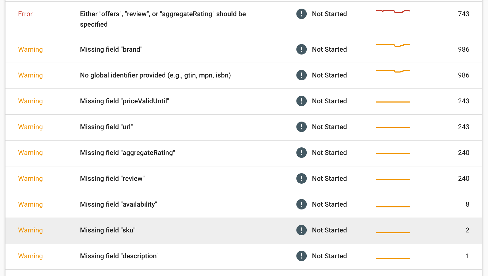

mkkorleone Posted February 12, 2020 Posted February 12, 2020 The same .I have not errors but i have to many warnings Prestashop 1.6.1.4 A solution must be found. Share this post Link to post Share on other sites More sharing options...
weixuan0710 Posted February 13, 2020 Posted February 13, 2020 Hi, guys The best way to get rid of these errors is to buy the relevant mircodata module which can make you web clean if you have no time and expertise to do the schema mark up. I did try many times to fix this problem before, but I failed. Finally, I purchase one module which almost cleared all the errors. Our business web is clean. The warnings are that important, but google will change its mind later probably. That means the current warnings could become errors in the near future. Still, try your best to get rid of warnings following the google advice. Share this post Link to post Share on other sites More sharing options...
FoodAssets Posted February 13, 2020 Posted February 13, 2020 (edited) That's definitely not going to work for us. Module developers rarely get things right in our experience, nor do they bother answering detailed questions (as explained in my post). They're more interested in just taking money versus providing well-coded modules. Prestashop is plagued with serious issues out of the box, and there seems to be a "module fix" for each of them (by design in our opinion). It's great way for them to take money - no thanks. You're "almost cleared all the errors" comment is a great example of how crappy module developers are in our experience and seem to be in the business of releasing poor quality "solutions". We're just not interested in supporting this kind of shady business activity. We tested your product page in Google's Structured Data Testing Tool (https://www.erenovation.com.au/in-wall-cistern-wall-hung-toilets/reno-302-rt-cistern-wall-hung-toilet#/59-button_option_rt-g3004109_square_chrome_12500/63-toilet_pan_color_option-gloss_white_toilet_pan) and it reports 4 warnings which I'm sure you know about. There is a difference we've noted in the Testing Tool warnings and errors, and what Google Tools shows (increased severity). They are not giving out the same errors and warnings in all cases, some warnings are now "Errors", which are more severe. We also suspect Google will (and has) changed its mind about how important these warnings and errors are. This is a code problem with the core files in Prestashop in our opinion and it needs to be fixed. Edited February 13, 2020 by FoodAssets (see edit history) Share this post Link to post Share on other sites More sharing options...
weixuan0710 Posted February 13, 2020 Posted February 13, 2020 Yeah, mate i know our product pages have 4 warnings, but it is normal. You should check products with reviews in my web, mate. Only the products without reviews will show the warnings related. Share this post Link to post Share on other sites More sharing options...
