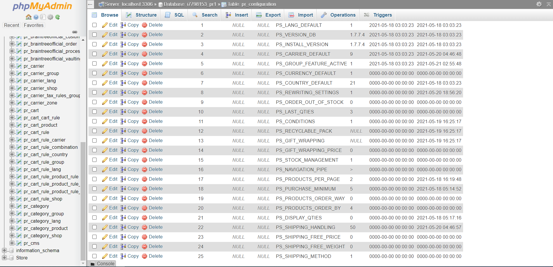

DouglasB16 Posted May 23, 2021 Share Posted May 23, 2021 44 minutes ago, Nickz said: All data is stored in the database, that is how most CMS and shops work. These are all the rows of my ps_configuration table. Can someone please allow me 30 mins of your time and I can provide snapshots of different files that can help you to have a better understanding of what I may be or have done wrong. The only thing I have done was add cloudflare ssl to my godaddy webhost. I have done nothing database wise within presatshop file. Another thing is, I installed prestashop through webhost cpanel and that is where I am left. Link to comment Share on other sites More sharing options...
