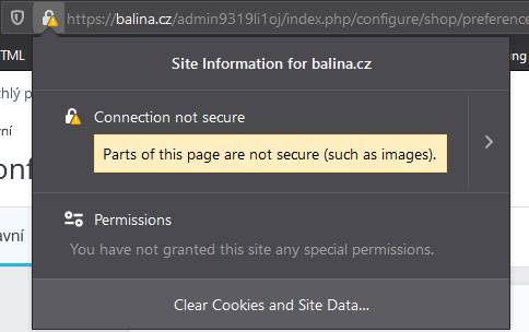

Ok, so today when I was about to take some screenshots, I got a step further by clicking the please click here to check if your shop supports HTTPS which actually redirected me to https version with slight limitation though, but before it didn't even redirect me.
So I got some screenshots here:
This one shows it's partly protected now after clicking the https test link, instead of staying on http.Capture1.thumb.PNG.5c025883ad2449c9d0e43908db4f57c3.PNG

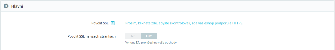

This one is in czech language but basically it doesn't matter since all I'm trying to show is that the option to allow SSL on all pages is still greyed out without any option to enable it.

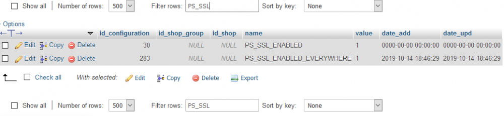

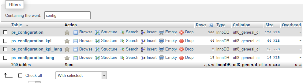

Now here in my database I could actually find the ps_configuration table but I'm not sure what exactly I should look for when you say there should be different table with similar name containing configuration, I search through it all but all I found near the configuration was exactly this one, what doesn't make much sense though is that the PS_SSL_ENABLED  and PS_SSL_ENABLED_EVERYWHERE values are already set to 1 but it makes no change to SSL settings as can be seen on the next screenshot.Capture3.thumb.PNG.1db6b8d0a53496819c9a7e97a57e3a8e.PNG

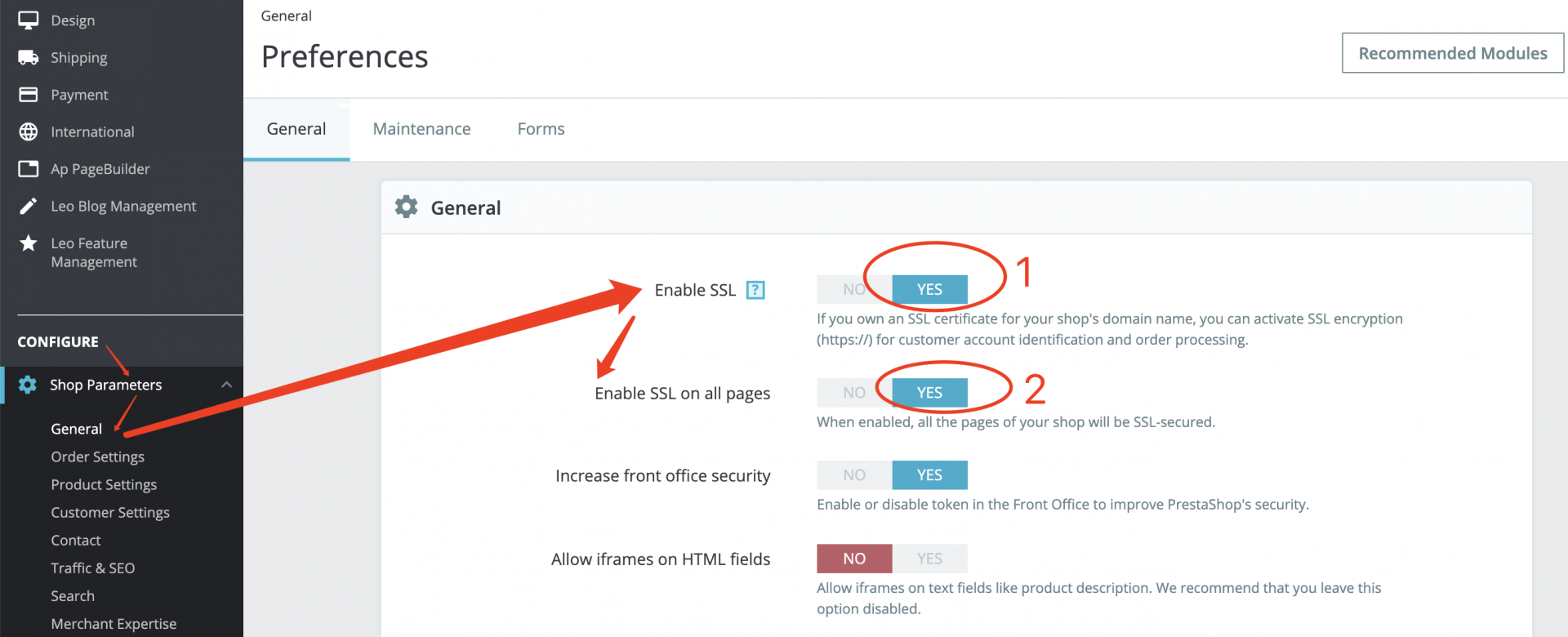

3. Turn on SSL
CONFIGURE ---> Shop Parameters ---> General ---> Preferences
  • Enable SSL:YES
  • Enable SSL on all pages:YES
Don't forget to save the settings, I wish you success, I have successfully turned on SSL.
