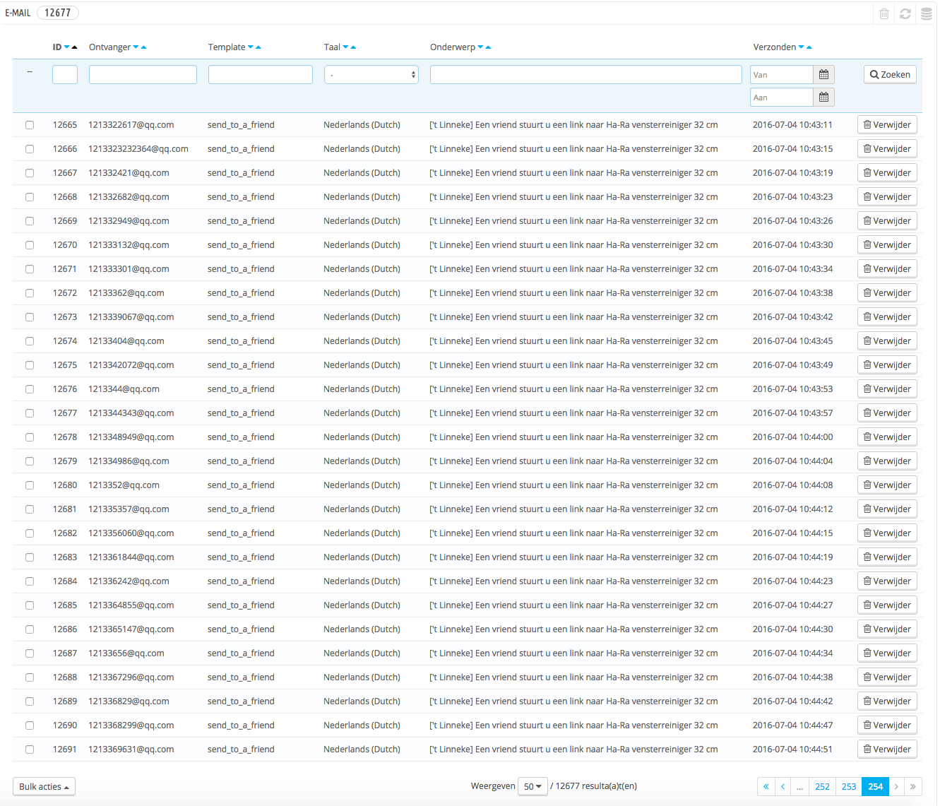

On a presashop 1.6.0.14 configuration we had an issue with the Send to a friend module on one particular product.
We got an endless stream of mails send from the module to *user*@qq.com mail addressess, see screenshot.
We are using a sendgrid account to send the email, we noticed this problem because sendgrid blocked the account because we reached the 12 000 mail limit a month.
I checked the Send to a friend module in the backend and it had to be updated.
I did that and know the triggers from the spam are stopped.
