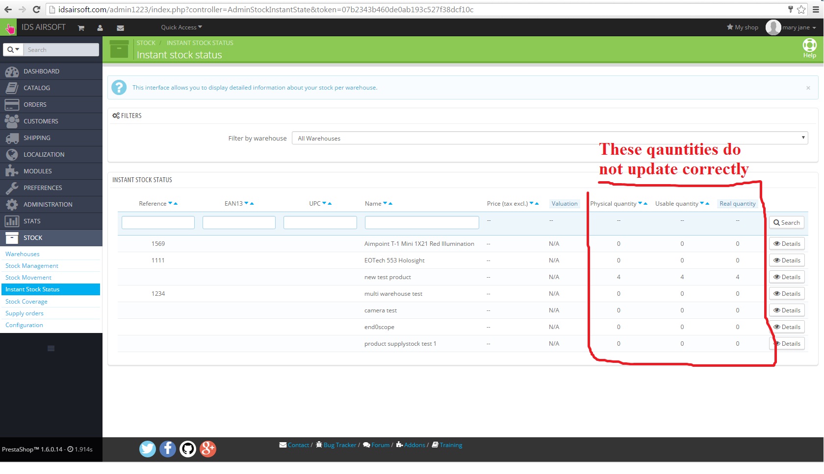

3)Pending receipt - Incorrect (Physical Qty and Usable Qty doesn't update. Real Qty updates correctly at this point)
4)Order received in part (Physical Qty and Usable Qty doesn't update. Real Qty updates but quantity shown is qty not received which is wrong)
5)Order received completely (Physical Qty and Usable Qty doesn't update. Real Qty becomes 0 which is incorrect)
6)Order canceled (Physical, Usable and Real Qty does not decrement)
After 3(Pending receipt) or 4(Order received in part), front end shows product in stock and able to add to cart. But during checkout returns error that buyer can't pay because the item is not in stock even though the product is still listed as in stock at front end.
In Warehouse>Insant stock status, real quantity shows correct quantity, but 0 in both physical qty and useable qty. Could be something to do with this. Also to note is that after clicking received in part, the "Real quantity" is updated reversed. For example, item A received 47pcs instead of Expected 50pcs from Supplier 1. After clicking save, in instant stock status it shows 3pcs. By right it should be 47pcs. Again, by this time under Physical Quantity it should be 47pcs (now it is 0 which is incorrect), and Usable quantity which should also be 47pcs(now it is 0 which is incorrect), assuming that Item A does not have any pending order in cart.

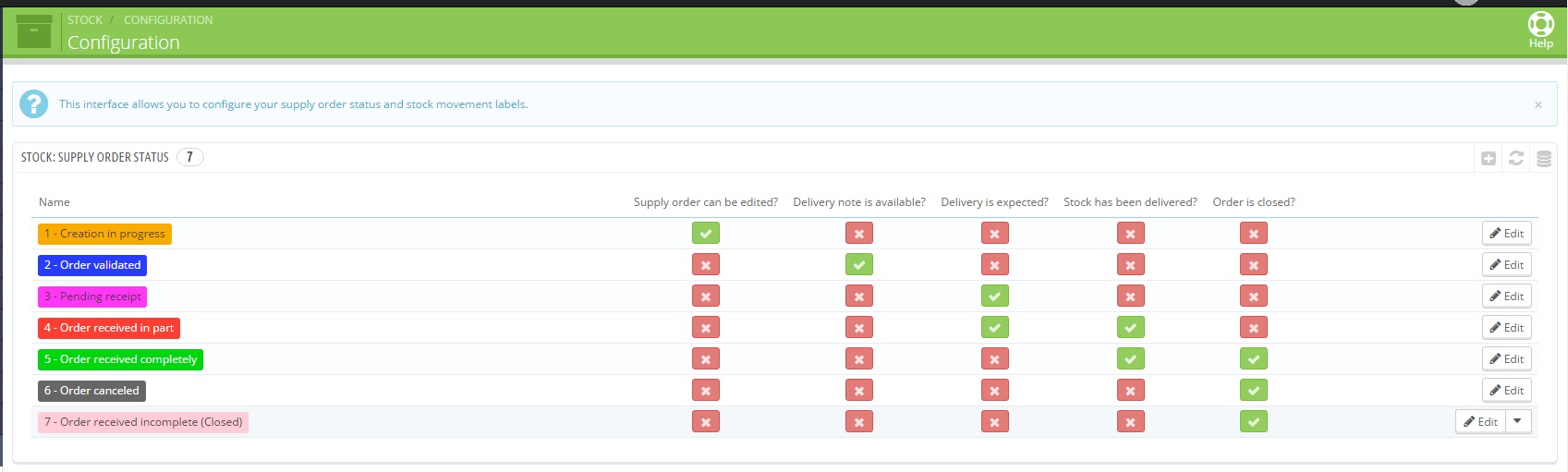

I created an extra status No.7 and called it  => 7 - Order received incomplete (Closed). This process should be selected if an order arrived incomplete or somewhat different than ordered. It should be selected right after 3 - Pending receipt. It's actually the same as 6 - Ordered canceled but I think it would be better to create a new status that had a more reasonable status naming. See attached picture:
Edit: Except for one little bug. Order valuation is not calculated based on the actual qty received but qty ordered.

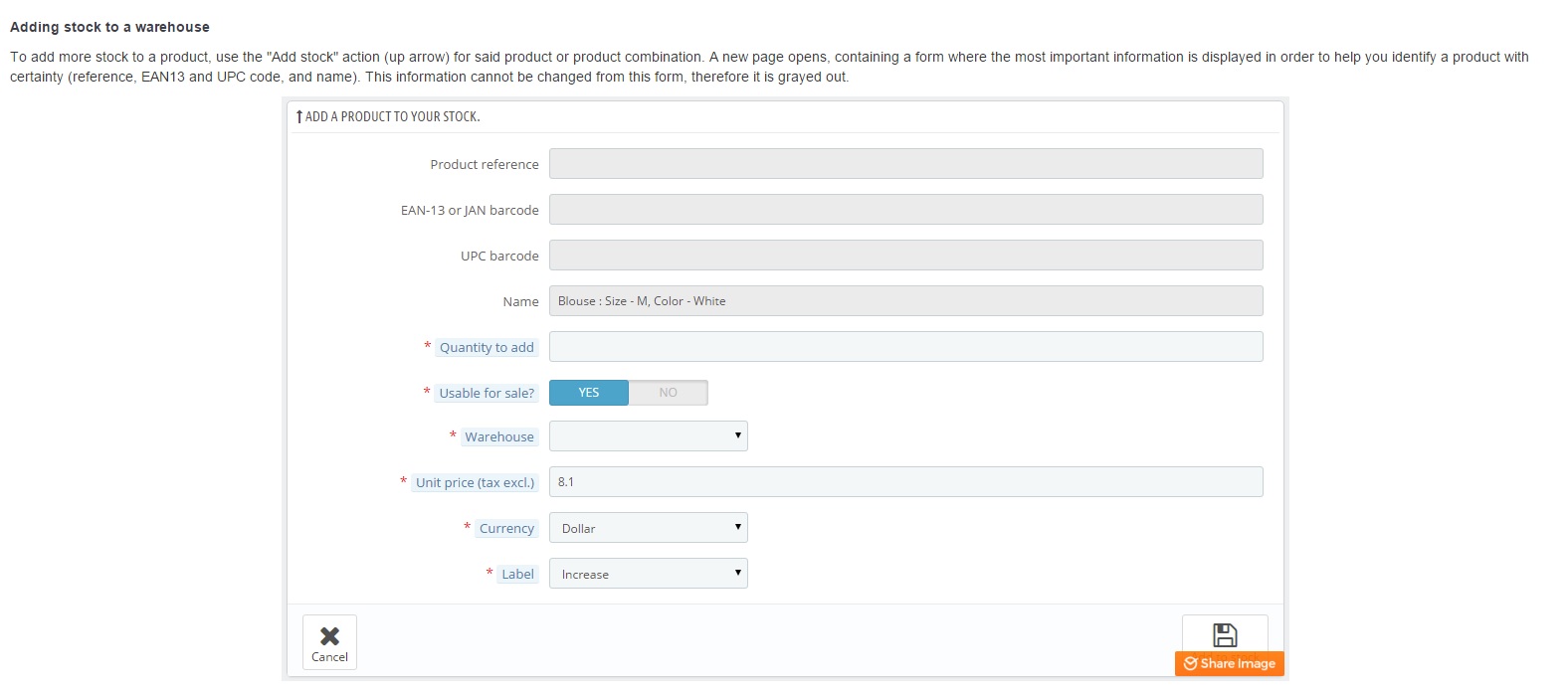

It is needed to specify an unit price for each product in your supplier order, if you let zero price for a product, its stock will not be updated!!
