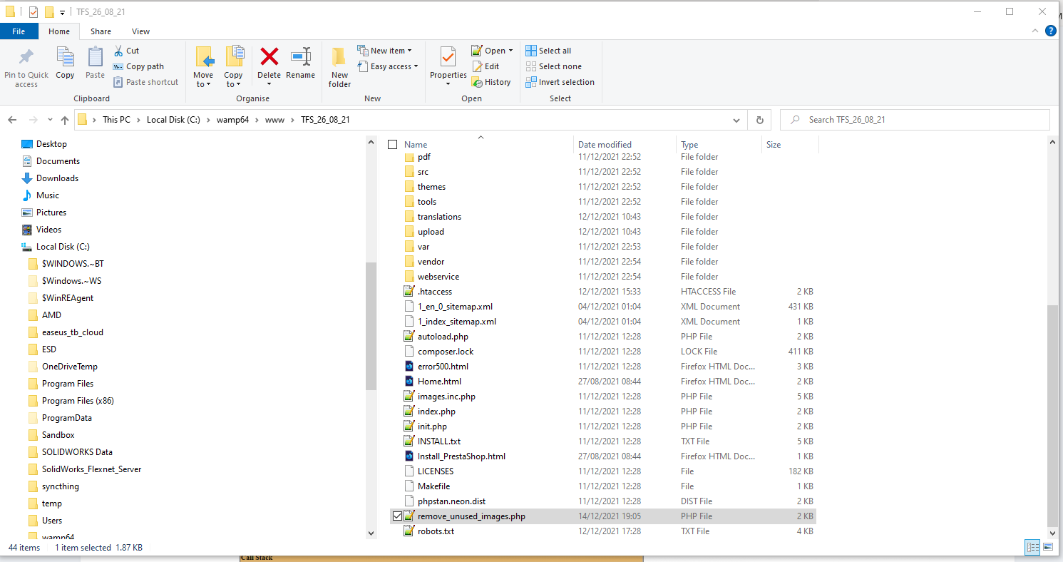

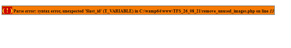

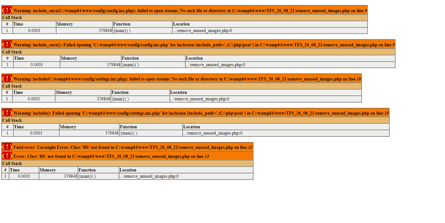

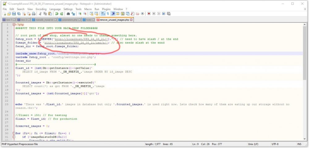

flowers_ph Posted December 11, 2021 Share Posted December 11, 2021 ive got something wrong when i changed the php file where indicated in the guide. Sorry ive not run a php script before and im working on wamp. Link to comment Share on other sites More sharing options...

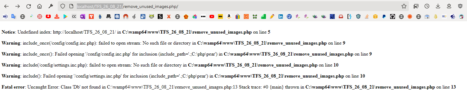

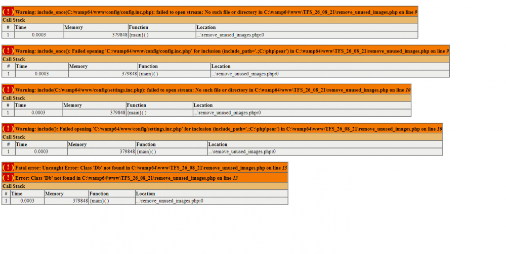

hakeryk2 Posted December 13, 2021 Share Posted December 13, 2021 On 12/11/2021 at 4:01 AM, bnadauld said: ive got something wrong when i changed the php file where indicated in the guide. Sorry ive not run a php script before and im working on wamp. Leave these variables as they are posted originaly. Just insert script file in the main folder of your shop and run it. You don't need to edit anything and it should run smoothly. 1 Link to comment Share on other sites More sharing options...
flowers_ph Posted December 14, 2021 Share Posted December 14, 2021 (edited) On 12/13/2021 at 3:47 PM, hakeryk2 said: Leave these variables as they are posted originaly. Just insert script file in the main folder of your shop and run it. You don't need to edit anything and it should run smoothly. I know you didn't want to support this. But thanks for the help! Edited December 14, 2021 by bnadauld (see edit history) Link to comment Share on other sites More sharing options...

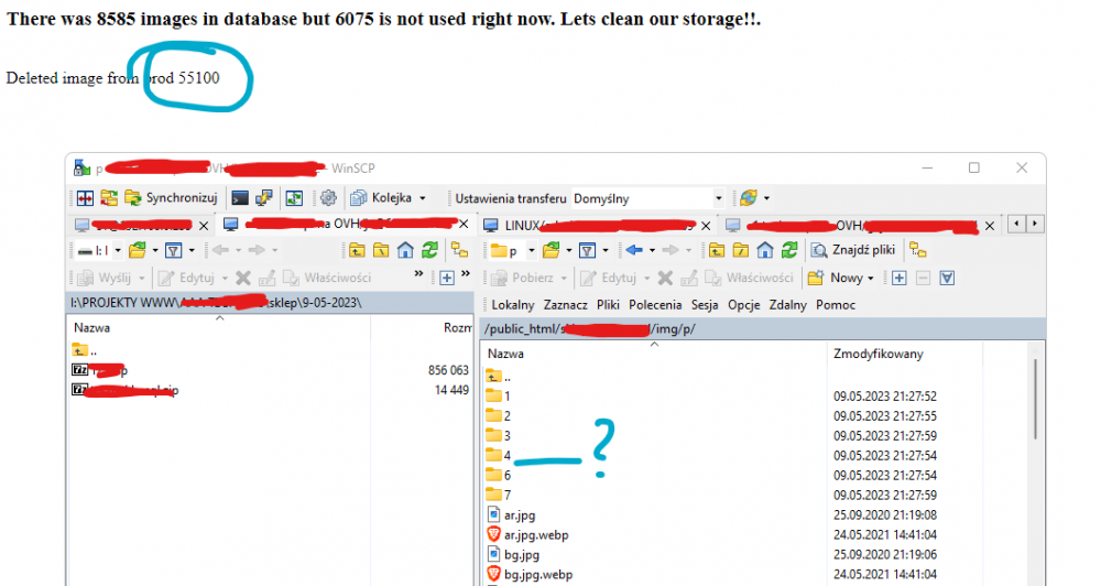

Sasni Posted May 14, 2023 Share Posted May 14, 2023 what if the script wants to remove an unused photo from a directory that doesn't exist? Link to comment Share on other sites More sharing options...
hakeryk2 Posted May 15, 2023 Share Posted May 15, 2023 Prestashop stores image with id 55100 in img/p/5/5/1/0/0 folder. 1 Link to comment Share on other sites More sharing options...
Sasni Posted May 15, 2023 Share Posted May 15, 2023 I know, but for some reason your script was getting stuck like in the picture above. I "wrote" my version -> https://github.com/Sasni/Delete_unused_images/blob/main/foton.php --- Wiem, ale z jakiegoś powodu twój skrypt mi się zacinał jak na obrazku powyżej. "Napisałem" swoja wersje -> https://github.com/Sasni/Delete_unused_images/blob/main/foton.php Link to comment Share on other sites More sharing options...
presta_jsM Posted May 16, 2023 Share Posted May 16, 2023 On 5/14/2023 at 10:31 AM, Sasni said: what if the script wants to remove an unused photo from a directory that doesn't exist? This ID "55100" is product id, not image id... Your script only searches at the '/img/p/3' directory, which will not clean all the images. You should search within the '/img/p/' directory. Link to comment Share on other sites More sharing options...
