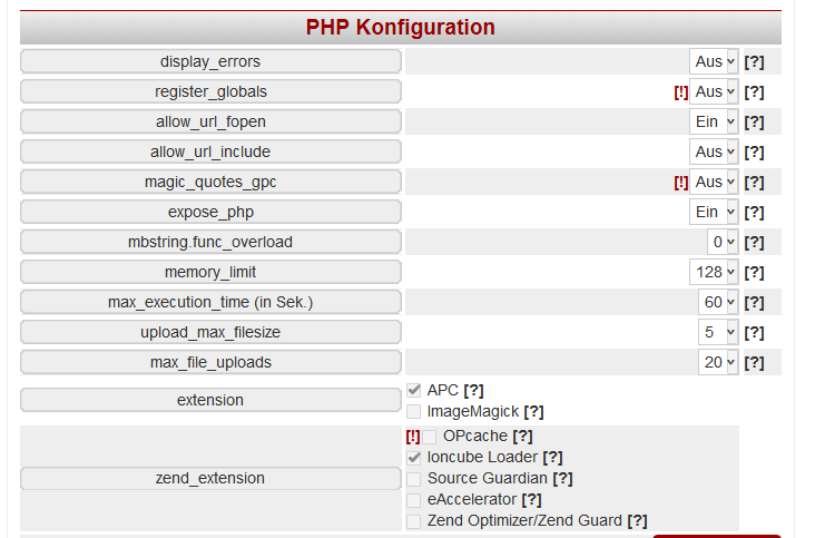

BoKr Posted June 22, 2014 Share Posted June 22, 2014 @DH42 Do you have apc cache enabled for user cache or only for file cache? I've tested it with user varaible cache but noticed that for example the "new user" and "new order" notifications in the back office are not cleared correctly after enabling user variable cache (in 1.6). Ehm, this is one of a handful problems I have with our productive site since it is running 1.6.0.6 (upgraded from 1.5.6.2 a week ago). I opened already two threads on the forum. One in English one in German but had no luck with responses. I had the cache in mind but am just a shop owner. Did some diggin in the forums and stumbled about some js issues with 1.6.0.6 (that was upgraded from 1.5.6.2), so I may have been mislead Anyway, as said I am just a shop owner who has no clue of caching mechanism but who wants to be able to use his shop... All the time I had CACHE ON with APC in BO. On my host I had APC activated and this eAccelerator since I once read that they do different things. Now following your thread here I disabled APC in BO and on the host and can not tell at the moment if things have improved. I hope so. Anyway, http://gtmetrix.com tells me now difference bewtween this settings. So, I assume Cache does not work anyways or I do not understand the concept of measureing speed though I read the nice explanations on DH42's site. Here I want to attach screens I have (it is php 5.4 . I could choose 5.5 on the host but then bo/fo remain blank). Before I wrote this I had eAcellerator and APC turned ON and in Presta/BO APC was set to APC not Filesystem as on the screen. I am just testing APC-Filesystem -- though I do not know what is means -- since in the last post above was mentioned sth about two APC variables.... The main problem I have is that many times , not always, I got the feeling that changes made in the BO as switching options on/off or assigning categories to products are not sent to the server's DB!!? In a nutshell, I can make changes in BO but when I refresh the page, the previous settings are still there. At the moment it is more than hard to work with Prestashop 1.6.0.6 and we have alot of problems due to this. Link to comment Share on other sites More sharing options...

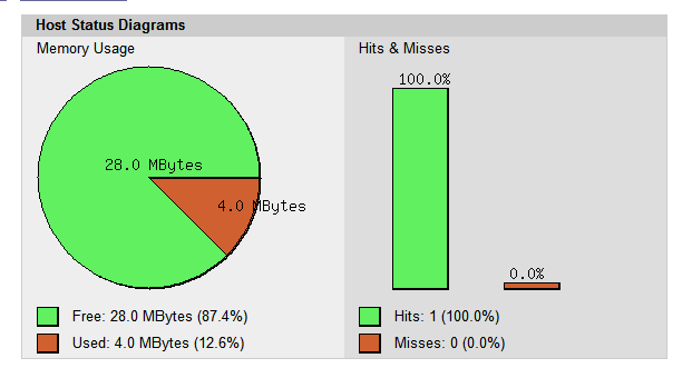

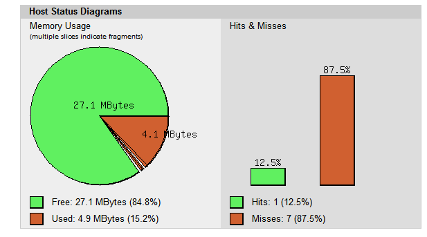

Trip Posted June 22, 2014 Share Posted June 22, 2014 Hello Herr Köring. I've attached a file apc.php. When you upload it to your webspace and open the url www.your-site/apc.php can see what apc is caching. When apc is installed it works as a cache afaik which converts php files into so called opcode with the intention that this must not be done in runtime and everytime a file is called. Additional it stores everything in RAM memory so it reduces disk reads. When you enable apc in the performance options than variables are stored in apc cache too. The result is eveytime the database is called those queries (results) can now be read from apc. In theory this reduces the database reads from a couple hundrets to maybe 20 or 30. On my local test install this is remarkably faster (we are talking here about 200ms to 300ms on my server) but when you have a slow database the effect might even be better. I think the dh42 article is only covering file opcode cache and not the variables cache and I would like to differ. I would definetly set apc.stat=1 as apc will check if a file is updated. This is slightly slower but in case you change a file or you update the software you can be sure that apc does not serve old files with maybe terrible consquences. With apc in opcode/normal mode I had no issues (with apc.stat=1) but question remains if anybody uses the user variables cache too without problems? All the best, Trip apc.php Link to comment Share on other sites More sharing options...

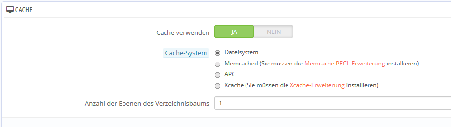

BoKr Posted June 23, 2014 Share Posted June 23, 2014 (edited) Thank you for the file and detailed informations! I hope I understand you right and I want to recapitulate it - please correct me: There are basically foure options to run APC with Prestashop. ON / OFF - in back office/performance/Cache & in "BO Console php settings of your hoster" OFF / OFF - in back office/performance/Cache & in "BO Console php settings of your hoster" ON / ON - in back office/performance/Cache & in "BO Console php settings of your hoster" OFF / ON - in back office/performance/Cache & in "BO Console php settings of your hoster" Where I think the 1. options is not choosable in Presta's BO since it will warn you it did not detect APC on the host's site. For options 2,3 and 4 we need to know the settings of the host or we can make use of your linked apc.php checker file. You mentioned in you post 2 methods to use APC. I think you meant options 3 and 4. Where option 4 is in most cases an option to go without problems (if you host has set up APC correctly) and option 3 is problematic?! I had option 3 when all the problems occured I mentioned above. Now I am running option 4. BUT another variation of option 4. I have in Presta/BO/performanc/cache activated the setting FILESYSTEM. I do not know if it ok to do so or not and what it means performancewise. Thank you for further helping me to understand to run Presta 1.6.0.6 on my host HETZNER properly. CACHE: file system (apc therefore off) - ON on Host CACHE: APC - ON on Host Edited June 23, 2014 by B.Köring (see edit history) Link to comment Share on other sites More sharing options...
