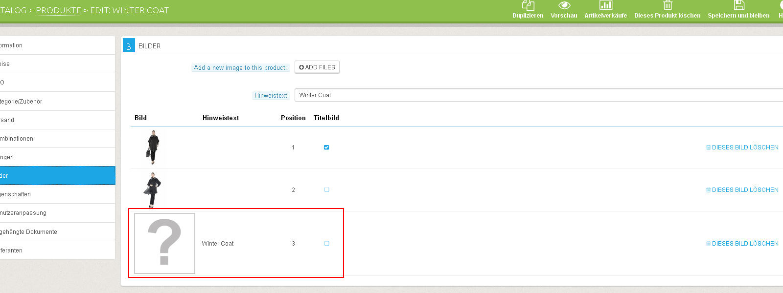

Superserver Posted December 10, 2013 Share Posted December 10, 2013 Upload product images on the local XAMPP works fine! The upload of product images on 1&1 server does not work. After upload a blank image subdirectory is created. The server does not report a PHP error. (Directory permissions are correct and the upload of logos or other images works!) Version der Server-Software: Apache PHP-Version: 5.4.21 PrestaShop-Version: 1.6.0.1 (Alpha) 1 Link to comment Share on other sites More sharing options...
Radu Posted December 10, 2013 Share Posted December 10, 2013 can you please tell me what do you mean by "blank image subdirectory"? Link to comment Share on other sites More sharing options...

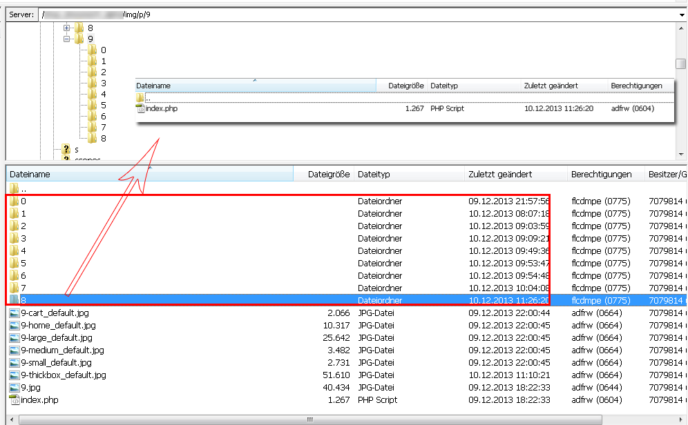

Superserver Posted December 10, 2013 Author Share Posted December 10, 2013 (edited) presta 1.6.1 generated after the upload only empty directories. (without images) look at this > Edited December 10, 2013 by Superserver (see edit history) Link to comment Share on other sites More sharing options...

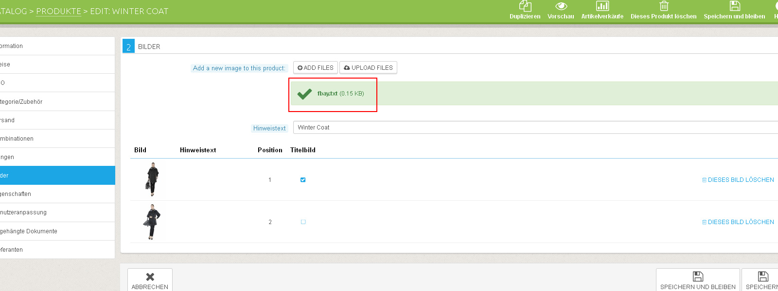

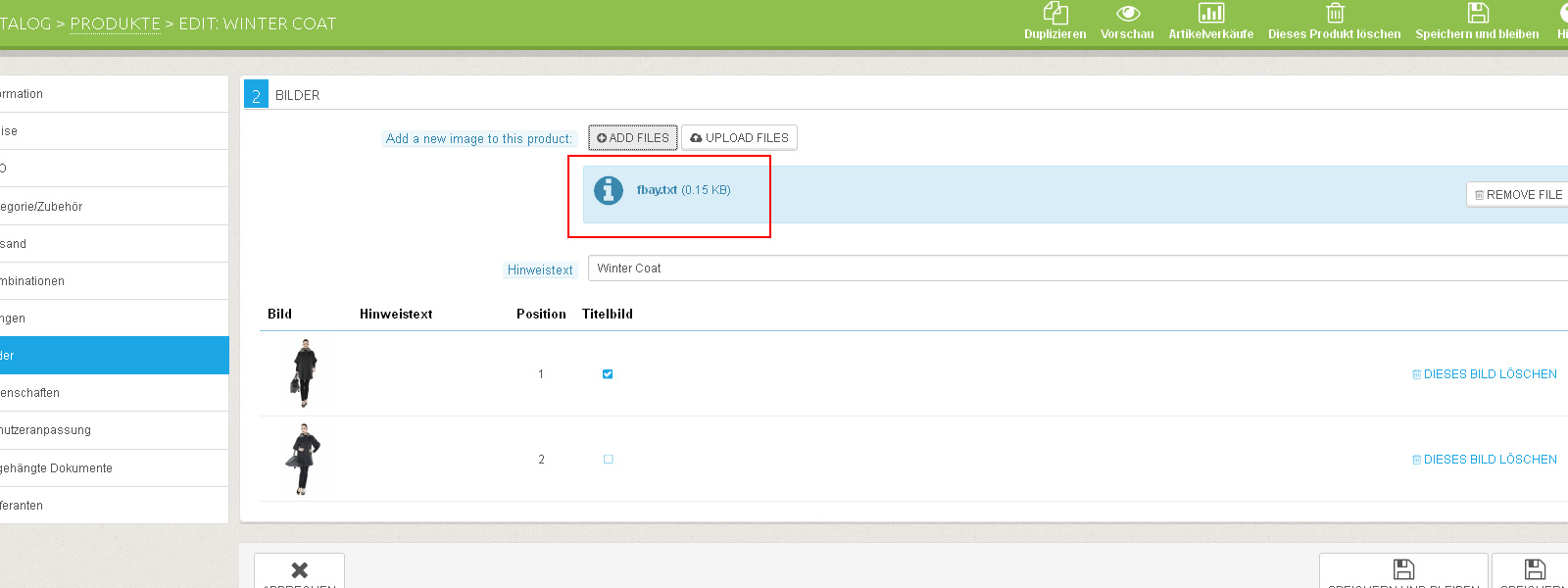

Superserver Posted December 10, 2013 Author Share Posted December 10, 2013 the same problem in other size. my server limit is high. (test images for upload 70-160kb) look at this > Link to comment Share on other sites More sharing options...

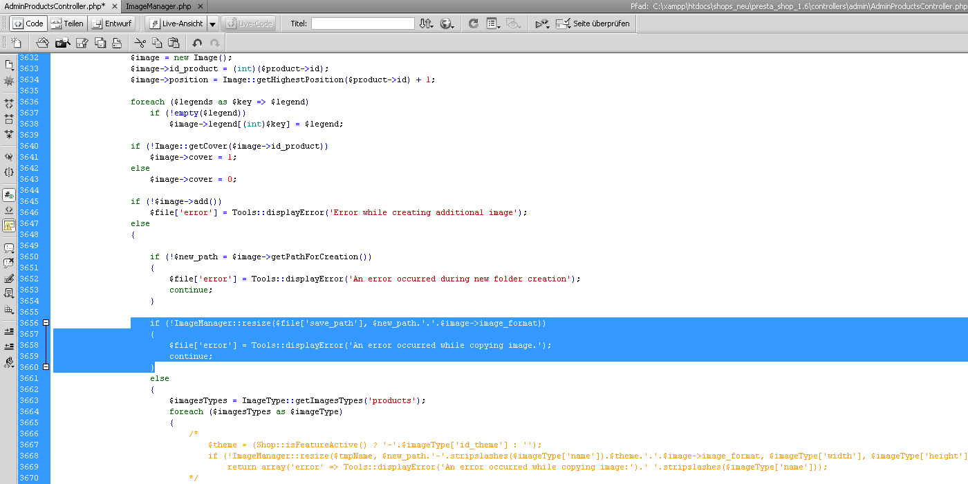

Superserver Posted December 11, 2013 Author Share Posted December 11, 2013 (edited) Strange, the referenced line 3655 in AdminProductsController.php is if ($this->product_exists_in_shop) Can you view the product you want to upload images to? sorry, this is not correct, the first call of the undefined variable (save_path) is >>> [AdminProductsController.php] public function ajaxProcessaddProductImage() { ... if (!ImageManager::resize($file['save_path'], $new_path.'.'.$image->image_format)) <<< LINE 3655 { $file['error'] = Tools::displayError('An error occurred while copying image.'); continue; } ... } Edited December 11, 2013 by Superserver (see edit history) Link to comment Share on other sites More sharing options...
Superserver Posted December 11, 2013 Author Share Posted December 11, 2013 (edited) I have the bug isolated.the problem: (the validation of upload file will not run)you look at this >the problem > the resize function is called before the uploaded file is validated. this error is the cause of my previous upload trouble my english is not so good but the problem is found and I am tired after 12h presta core When can I report errors for v1.6 Alpha in PrestaShop bug tracker? Edited December 11, 2013 by Superserver (see edit history) Link to comment Share on other sites More sharing options...

Superserver Posted December 12, 2013 Author Share Posted December 12, 2013 (edited) the bug has nothing to do with the file size !!! the validation of upload file does not run correctly. I can upload all file types. This bug also give rise to problems with uploading images on my 1&1 server. I have done a simulation, it is tried first resize without running the file validation and check file type. the correct way would be (anything else very unsafe!): 1 > product image upload 2 > upload file validation (size, type, ...) 3.1 > is true then copy file into the presta image directory 3.2 > is false then return and show error message 4 > calling on success the resize function and more the validation should be at the beginning without any further calls of functions. only then should follow more functional calls (eg resize). I hope this information will pass on to the developer team ... Edited December 12, 2013 by Superserver (see edit history) Link to comment Share on other sites More sharing options...
