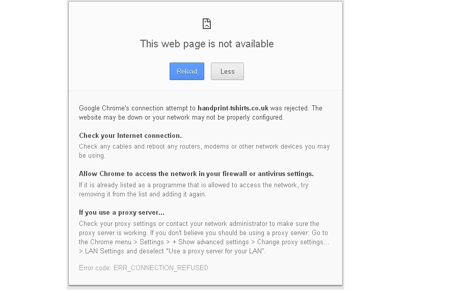

jonmig Posted September 5, 2013 Author Share Posted September 5, 2013 hi vekia when I try to get into the back office or even just enter my domain name into the url I get the attached error message cheers Mike Link to comment Share on other sites More sharing options...

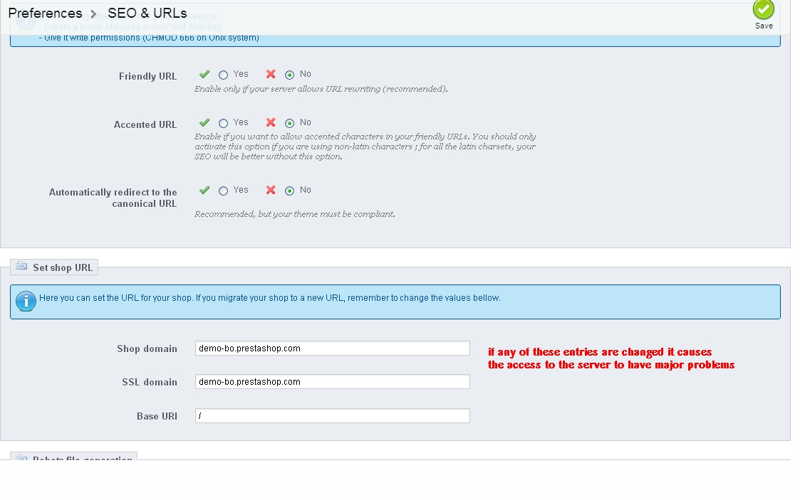

jonmig Posted September 6, 2013 Author Share Posted September 6, 2013 (edited) I must add that this problem seems to be a common error in both Prestashop and Word press ,one where the user goes into the back office and is faced with an error flag pointing to a problem with one of the url entries ,the immediate response seems to be (as I personally did) to adjust the domain name ,ssl or base just to get rid of the warning however doing this seems to cause the programme to lose connection with the server ,I can't believe that there isn't an easier way to sort this problem as it basically shuts everything down and causes many sleepless nights ,the only way around it would be to re-install the whole programme which is not an option if your whole site is fully configured already. any ideas guys ? Edited September 6, 2013 by jonmig (see edit history) Link to comment Share on other sites More sharing options...

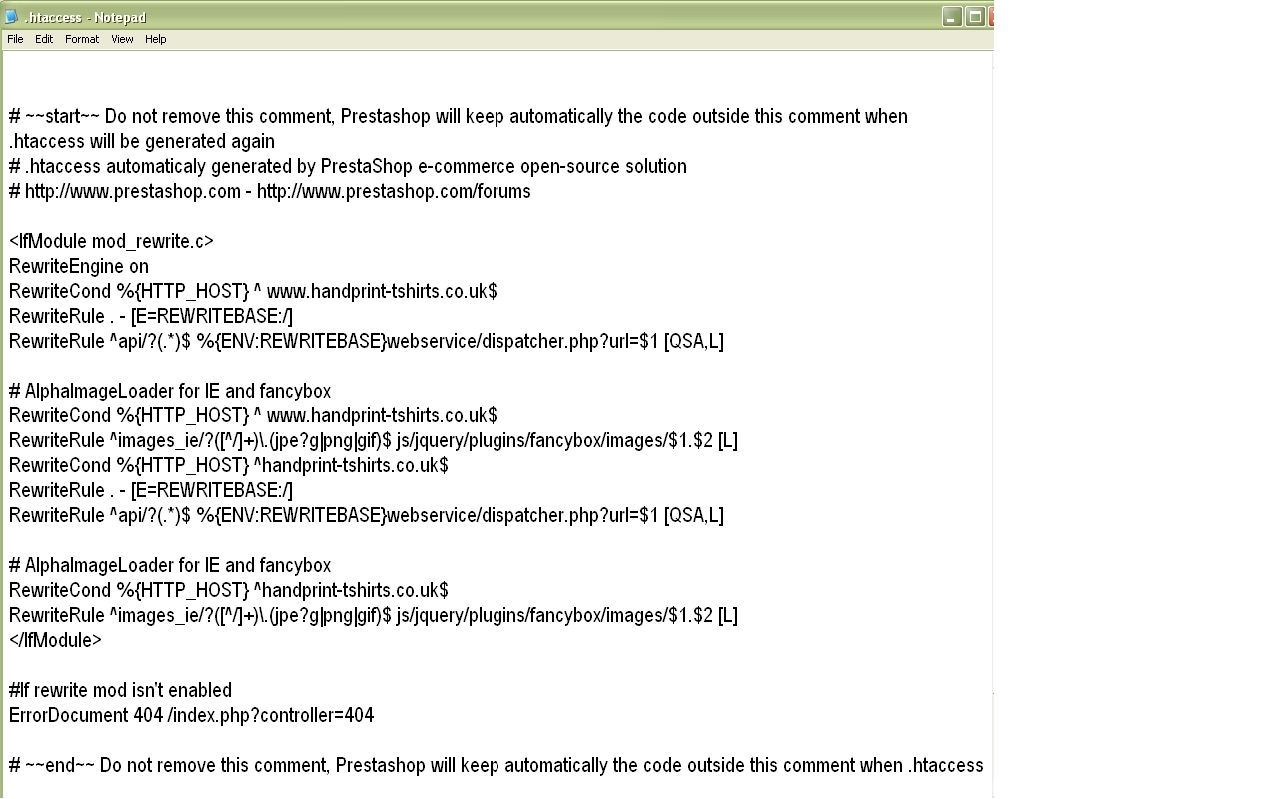

J.Sahu Posted September 6, 2013 Share Posted September 6, 2013 it feels like there is some modification done in the .htaccess file, but since you have not changed anything then there might be some other problem. 1 Link to comment Share on other sites More sharing options...
bellini13 Posted September 6, 2013 Share Posted September 6, 2013 have you deleted the .htaccess file or modified it? If it still references your old domain, that is likely your problem also you don't say what you have done specifically with the domain. are you saying you went from google.com to yahoo.com, or are you saying you went from www.google.com to subdomain.google.com you also don't mention the version of Prestashop you are using. Have you removed any smarty cache files? 2 Link to comment Share on other sites More sharing options...
jonmig Posted September 6, 2013 Author Share Posted September 6, 2013 (edited) hi guys thanks for your help ... No I personally haven't edited or deleted the .htaccess file unless Prestashop has written anything to it ? (please see attached pic) I saw the error flag within the back office referring to the url's being incorrect somewhere, so what I did was copy the entry from the ssl line to the domain. I accessed the back office from google chrome. Installed Version 1.5.5 (latest version)... looked at the sql db shop_url and this has the correct address entered. I have also viewed the config/settings.php file and this has the data base address in it. cheers Mike Edited September 6, 2013 by jonmig (see edit history) Link to comment Share on other sites More sharing options...
bellini13 Posted September 6, 2013 Share Posted September 6, 2013 so does the htaccess file that you provided have the correct domain in it? 1 Link to comment Share on other sites More sharing options...
jonmig Posted September 6, 2013 Author Share Posted September 6, 2013 hi yes apart from the $ sign www.handprint-tshirts.co.uk cheers Mike Link to comment Share on other sites More sharing options...

benjamin utterback Posted September 6, 2013 Share Posted September 6, 2013 I must add that this problem seems to be a common error in both Prestashop and Word press ,one where the user goes into the back office and is faced with an error flag pointing to a problem with one of the url entries ,the immediate response seems to be (as I personally did) to adjust the domain name ,ssl or base just to get rid of the warning however doing this seems to cause the programme to lose connection with the server ,I can't believe that there isn't an easier way to sort this problem as it basically shuts everything down and causes many sleepless nights ,the only way around it would be to re-install the whole programme which is not an option if your whole site is fully configured already. any ideas guys ? Are both the wordpress and PrestaShop store on the same hosting server? Have you contacted your hosting provider because most Internal Server Errors can be investigated through your hosting provide, apache error logs, php error logs etc. 1 Link to comment Share on other sites More sharing options...

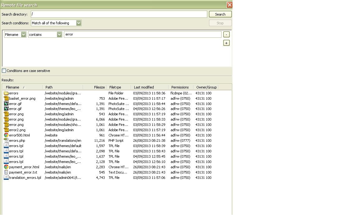

jonmig Posted September 6, 2013 Author Share Posted September 6, 2013 (edited) just did a search of all .htaccess files through Filezilla in my Prestashop website folder and after viewing them all I came across one in website/docs folder which says Deny from ALL is this anything important guys could this affect the connection with the server ? cheers Mike re the wordpress was a reference only ! I have been researching this problem Benjamin and it is not only experienced by Prestashop users but also Wordpress users too ...I have personally only installed Prestashop not Wordpress and yes I have spoken with my hosting team however they don't seem to have a solutution to the problem . Edited September 6, 2013 by jonmig (see edit history) Link to comment Share on other sites More sharing options...

bellini13 Posted September 7, 2013 Share Posted September 7, 2013 The htaccess in your docs folder would not be causing the issue, unless you are trying to access the docs folder. It is there to prevent visitors from accessing the docs folder 1 Link to comment Share on other sites More sharing options...

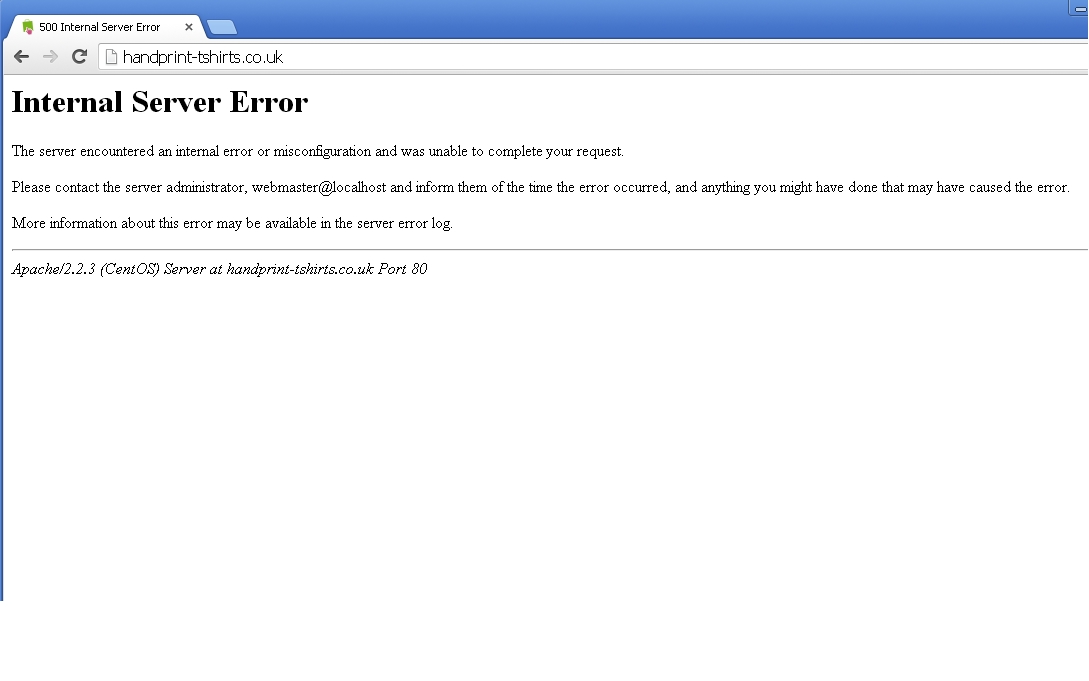

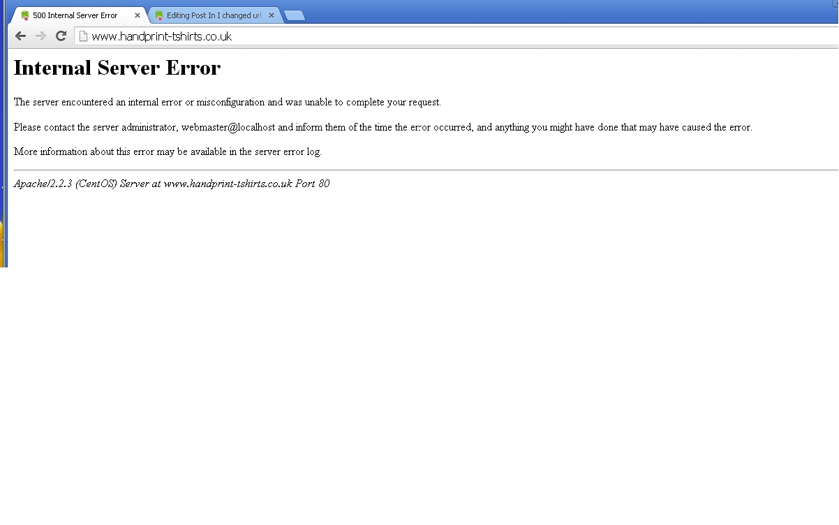

PrestaHeroes.com Posted September 7, 2013 Share Posted September 7, 2013 hi El Patron I can't get into the shop atall ,the url www.handprint-tshirts.co.uk just comes back with a 500 server configuration error everything was working correctly until I edited one of the SEO url lines and now it can't be found again in the domain search then this problem needs to be resolved before doing anything else, you need to get the actual 500 error http://www.prestashop.com/forums/topic/224525-how-to-turn-on-error-reporting-for-debug-information-500-error-or-blank-page/ 1 Link to comment Share on other sites More sharing options...
jonmig Posted September 7, 2013 Author Share Posted September 7, 2013 (edited) hi El Patron error reporting is already turned on as I initiated it after following those instructions to work my previous error out which was corrected by increasing the allowable data per page... The search just comes back now as website can't be found (please see attached). cheers Mike Edited September 7, 2013 by jonmig (see edit history) Link to comment Share on other sites More sharing options...
PrestaHeroes.com Posted September 7, 2013 Share Posted September 7, 2013 hi El Patron error reporting is already turned on as I initiated it after following those instructions to work my previous error out which was corrected by increasing the allowable data per page... The search just comes back now as website can't be found (please see attached). cheers Mike thats not what I am seeing...but I'm the oldest mod on her...and I confuse myself and others easily http://screencast.com/t/B0EoARH4 1 Link to comment Share on other sites More sharing options...
jonmig Posted September 7, 2013 Author Share Posted September 7, 2013 (edited) thats not what I am seeing...but I'm the oldest mod on her...and I confuse myself and others easily http://screencast.com/t/B0EoARH4 hi El Patron apologies no you are quite right that screen is what I have been seeing for days now however today after trying a few different suggestions I was getting the previous attached page example , but now it has come back ... cheers Mike Edited September 7, 2013 by jonmig (see edit history) Link to comment Share on other sites More sharing options...
PrestaHeroes.com Posted September 7, 2013 Share Posted September 7, 2013 if you can not get the exact error by turning on error reporting then look at the error log from your hosting account control panel you can not move forward on this without the error also make sure your hosting company does not have varnish cache turn on.... 1 Link to comment Share on other sites More sharing options...
