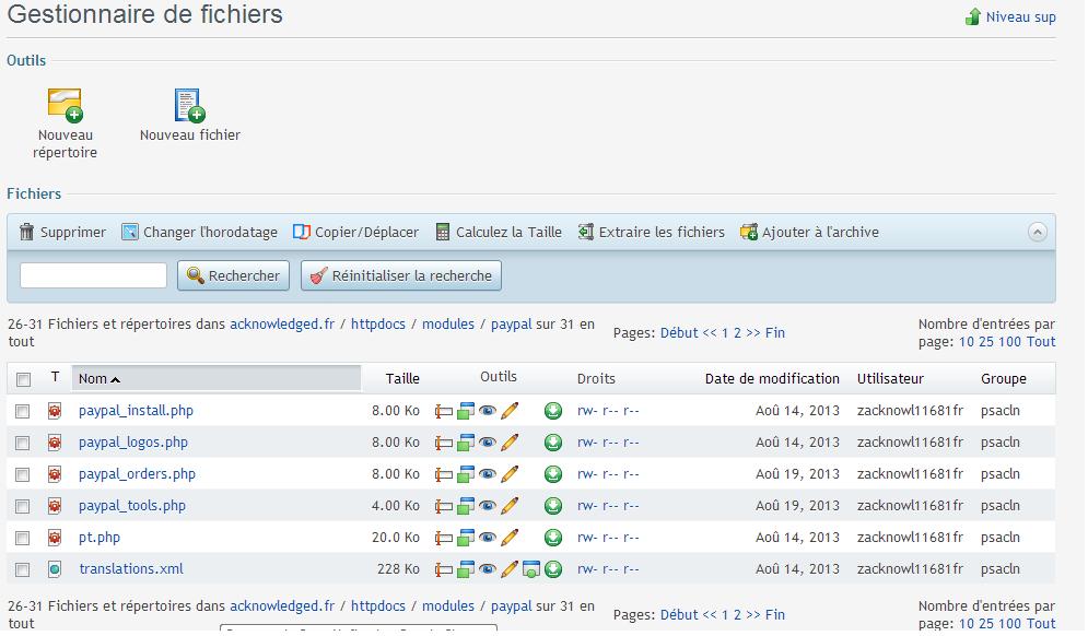

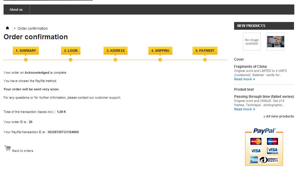

Oliforum Posted August 20, 2013 Author Share Posted August 20, 2013 (edited) Thanks for your effort and patience. I have checked again and no, there is no controllers directory in the Paypal module (See attached image). There is no also trace of Paypal in the controllers main directory. I do not see why it would be the PayPal module that displays the right column. Before creating this topic in the forum, I searched online for clues and there is a file that I suspect to be responsible for that : It is the "order-confirmation.tpl" in the Theme directory (here prestashop). (See attached image) When I compare the code to the page (see attached image) , I suspect they are related. Is it this file that we should consider ? 1. To remove the right column. 2. To remove the yellow bar of the order steps. There are some "hook" and I don't know where it points to. Thank you. What we have managed to do so far is already great for me. Edited August 20, 2013 by Oliforum (see edit history) Link to comment Share on other sites More sharing options...

Shad86 Posted November 5, 2013 Share Posted November 5, 2013 Hello guys, I have the same problem and I would like to fix it. after the Paypal checkout is the order confirmation page. There is only the right column and i want to hide it. And if it´s possible, the 5 order steps too. I´ve tried to change the confirm.php in modules/paypal/controllers/front but nothing happens. Same with the bill payment. All others are ok. No left and no right column. I hope anyone can help me, it seems like the last problem before getting online with the shop... Link to comment Share on other sites More sharing options...

Shad86 Posted November 5, 2013 Share Posted November 5, 2013 Sorry for the double post but I´ve got it. It´s the submit.php in modules/paypal/controllers/front Just add the "public $display_column_right = false;" in line 35 and it´s away. Now only same make-up with css and everything is fine. Link to comment Share on other sites More sharing options...
