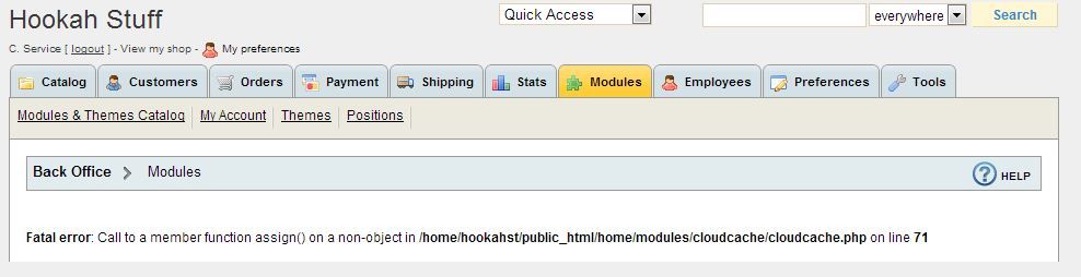

barrenwizard Posted April 16, 2013 Share Posted April 16, 2013 Hi Guys & Girls! Sorry to disturb on such a minor or insignificant issue for some. There's a problem where I'm not able to view my modules through back office. Here's a screen cap for an easy understanding. Can't seem to figure out what went wrong. Please advice. Thanks & Appreciate it in advance! Link to comment Share on other sites More sharing options...
PrestaHeroes.com Posted April 16, 2013 Share Posted April 16, 2013 to get info (which module is bad) try this http://www.prestashop.com/forums/topic/224525-how-to-get-debug-information-for-500-error-or-blank-page/ Link to comment Share on other sites More sharing options...
barrenwizard Posted April 16, 2013 Author Share Posted April 16, 2013 to get info (which module is bad) try this http://www.prestasho...-or-blank-page/ Hi, Thanks for the quick reply. I'll be sure to try it out and if I need help or anything I'll report back as soon as possible. Thanks again! Link to comment Share on other sites More sharing options...
benjamin utterback Posted April 16, 2013 Share Posted April 16, 2013 Hello all, thank you Fred for the awesome guide. barrenwizard, let us know what error, if any, show up on the front end. You need to change the config.inc.php file and follow the instruction on the guide. Once we have more information, we will solve this. Link to comment Share on other sites More sharing options...
barrenwizard Posted April 16, 2013 Author Share Posted April 16, 2013 (edited) Hello all, thank you Fred for the awesome guide. barrenwizard, let us know what error, if any, show up on the front end. You need to change the config.inc.php file and follow the instruction on the guide. Once we have more information, we will solve this. Hi Benjamin! Yes, I did what "Elpatron" told me and it really helps! Now I've got the error message. Here's the screen cap: Hope this would help out a lot to their seniors in helping us newbies. Thanks in advance! NOTE: I have never touch the internal codes of any modules before but only cloning it. Edited April 16, 2013 by barrenwizard (see edit history) Link to comment Share on other sites More sharing options...
PrestaHeroes.com Posted April 16, 2013 Share Posted April 16, 2013 what is your prestashop version? and did you search for the error message as suggested in the tip link? 1 Link to comment Share on other sites More sharing options...
barrenwizard Posted April 16, 2013 Author Share Posted April 16, 2013 Hi Fred, I've not do anything to it yet as I wouldn't know what to change even if I did find the codes. Its my first time facing this issue. Sorry for being so helpless. Link to comment Share on other sites More sharing options...
benjamin utterback Posted April 16, 2013 Share Posted April 16, 2013 Hi barrenwizard, are you using cloudcache? Link to comment Share on other sites More sharing options...
barrenwizard Posted April 16, 2013 Author Share Posted April 16, 2013 Hi barrenwizard, are you using cloudcache? Not so sure myself Ben, do you think its because of that? Link to comment Share on other sites More sharing options...
PrestaHeroes.com Posted April 16, 2013 Share Posted April 16, 2013 are you comfortable with ftp? 1. download moudles/cloudcache (back up) 2. delete the cloudcache folder on your remote site. see if you can then visit your moudles...in the back office... Link to comment Share on other sites More sharing options...
benjamin utterback Posted April 16, 2013 Share Posted April 16, 2013 If you are not comfortable with FTP, then make sure you have a backup of both your PrestaShop files and your SQL Database... These two things are needed to have a working store. Link to comment Share on other sites More sharing options...

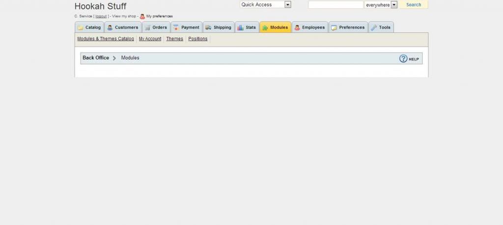

Pitty Aponte Posted July 12, 2013 Share Posted July 12, 2013 PLEASE i need helpppp module page missing i have this error Link to comment Share on other sites More sharing options...
PrestaHeroes.com Posted July 12, 2013 Share Posted July 12, 2013 PLEASE i need helpppp module page missing i have this error What version of PS are you using? Link to comment Share on other sites More sharing options...
Pitty Aponte Posted July 12, 2013 Share Posted July 12, 2013 (edited) version is 1.3.6. please I really need help I need to update my prestashop to the last version but i am scared of lost all my products, info and pictures Edited July 12, 2013 by Pitty Aponte (see edit history) Link to comment Share on other sites More sharing options...
PrestaHeroes.com Posted July 15, 2013 Share Posted July 15, 2013 version is 1.3.6. please I really need help I need to update my prestashop to the last version but i am scared of lost all my products, info and pictures honestly I have 'very little' experience in 1.3. What I found odd is that there is no 'FrontController' in 1.3.6. This using my search in DreamWeaver. Ave Maria Pues! Ok...so assuming there is not FrontController in 1.3.6, then it would seem that you loaded a module that expects the 'FrontController', I've pm'ed you for access to your site. I can then do some poking around to see what modules you have loaded...and if they call FrontController... weird! Link to comment Share on other sites More sharing options...

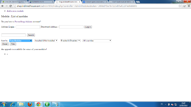

Mike Rafael Jr. Posted September 10, 2014 Share Posted September 10, 2014 Dear Members, Need help, I have some trouble when i click module from back office.. Please check the attached files below: PS v. 1.5.4.1 Link to comment Share on other sites More sharing options...
PrestaHeroes.com Posted September 11, 2014 Share Posted September 11, 2014 Dear Members, Need help, I have some trouble when i click module from back office.. Please check the attached files below: PS v. 1.5.4.1 turn on prestashop debug mode... http://www.prestashop.com/forums/topic/224525-how-to-turn-on-error-reporting-for-debug-information/ this will help you find the module that has issue tip: try not to post on old posts like this as it does not get seen by many community members, new post is better. Link to comment Share on other sites More sharing options...
