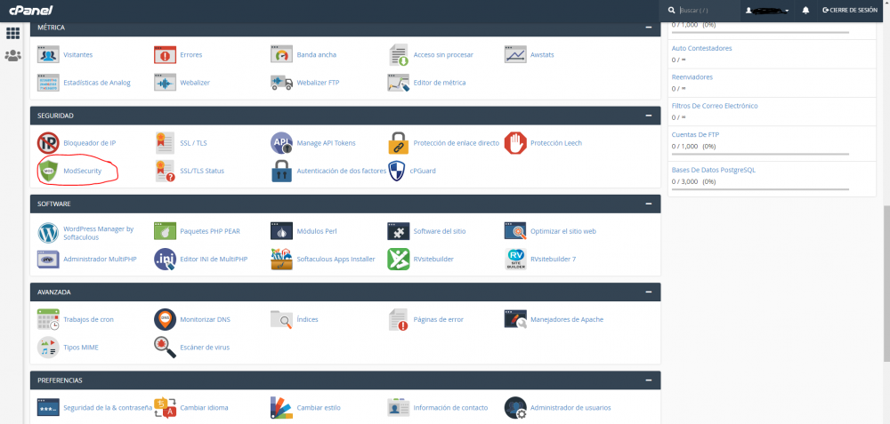

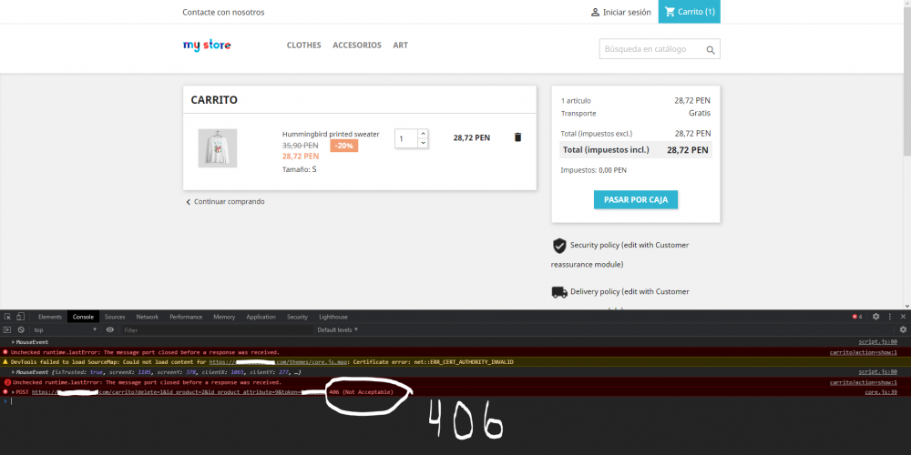

first notice the error displayed when you click on remove a product from the shopping cart
if the error is 406 as in the following image solve the problem in the following way otherwise look for solutions with the error shown in the console

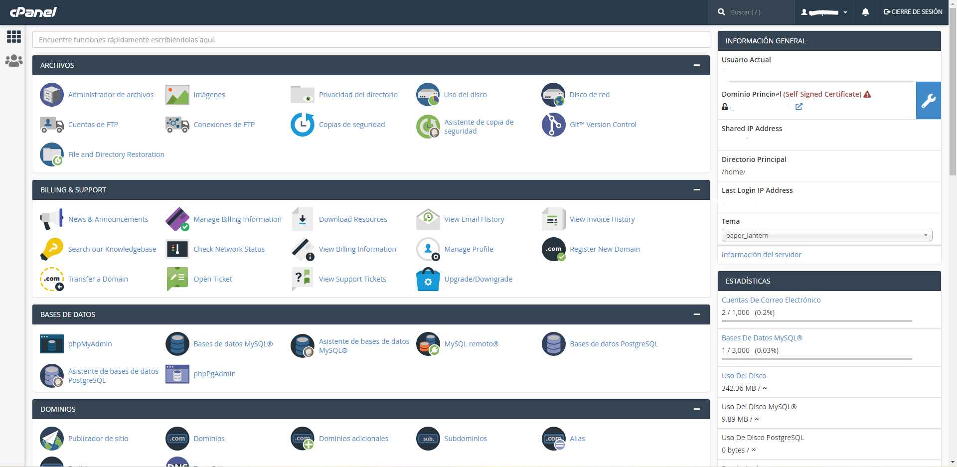

1.- enter your Cpanel
2.- select mod security

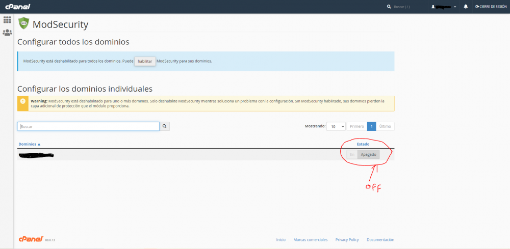

3.- Disable domain status
Edited by ericksonrqc99 (see edit history)
