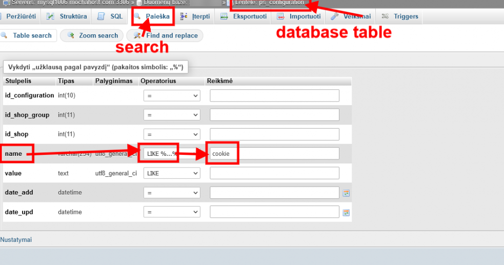

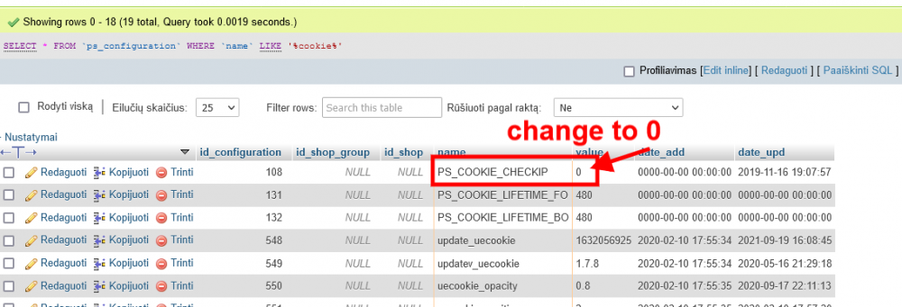

SahinSOLMAZ Posted December 18, 2019 Share Posted December 18, 2019 Hi Guys, This problem is still contiune for some people. For solution try this: - Open; phpMyadmin, ps_configuration table - Find, PS_COOKIE_CHECKIP and set it as 0 - Clear cache then try again, probably it will be solved. You can think that it is related to IP/network issue. 1 Link to comment Share on other sites More sharing options...

dvd2org Posted August 11, 2020 Share Posted August 11, 2020 d On 12/19/2019 at 1:00 AM, El Patron said: this happened to my original module shope, etiendsa.co....drove me bloody crazy as I could not login from my home office ip, like for months one day I emptied via phpmyadmin the three _connections table and bam, I could log in. there is not big issue empyting these tables.... hopefully this helps someone as well el hi i have same problem but in my phpadmin i cant find PS_COOKIE_CHECKIP plz help 1 Link to comment Share on other sites More sharing options...
Inter Svetainė Posted September 20, 2021 Share Posted September 20, 2021 On 8/11/2020 at 10:59 PM, dvd2org said: d hi i have same problem but in my phpadmin i cant find PS_COOKIE_CHECKIP plz help Link to comment Share on other sites More sharing options...
