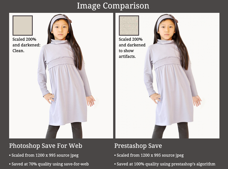

eternalc Posted June 13, 2012 Author Share Posted June 13, 2012 Hi again Heres a comparison image - I darkened a section of the BG to show the extent of the artifacting. Cheers Rory 1 Link to comment Share on other sites More sharing options...
Carl Favre Posted June 13, 2012 Share Posted June 13, 2012 Hi Rory, It is more striking with the images comparison. I will forward it to the developers. Link to comment Share on other sites More sharing options...
