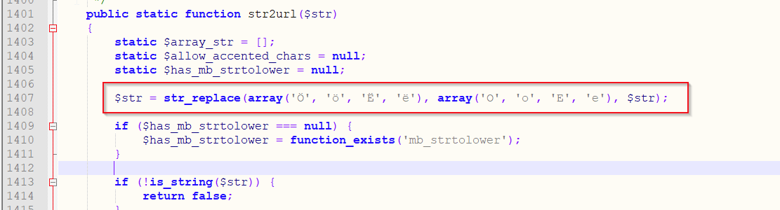

ps8modules.com Posted January 18, 2022 Share Posted January 18, 2022 static $allow_accented_chars = null; $str = str_replace(array('Ö', 'ö', 'Ë', 'ë'), array('O', 'o', 'E', 'e'), $str); Link to comment Share on other sites More sharing options...
oklok Posted January 18, 2022 Author Share Posted January 18, 2022 9 minutes ago, 4you.software said: static $allow_accented_chars = null; $str = str_replace(array('Ö', 'ö', 'Ë', 'ë'), array('O', 'o', 'E', 'e'), $str); Thx. Am I doing something wrong here? did not get it to work... Link to comment Share on other sites More sharing options...
ps8modules.com Posted January 18, 2022 Share Posted January 18, 2022 Where is it not visible? You have to open where the badly generated url is and have it generated again, or write a script to change all the urls stored in the database. Link to comment Share on other sites More sharing options...
