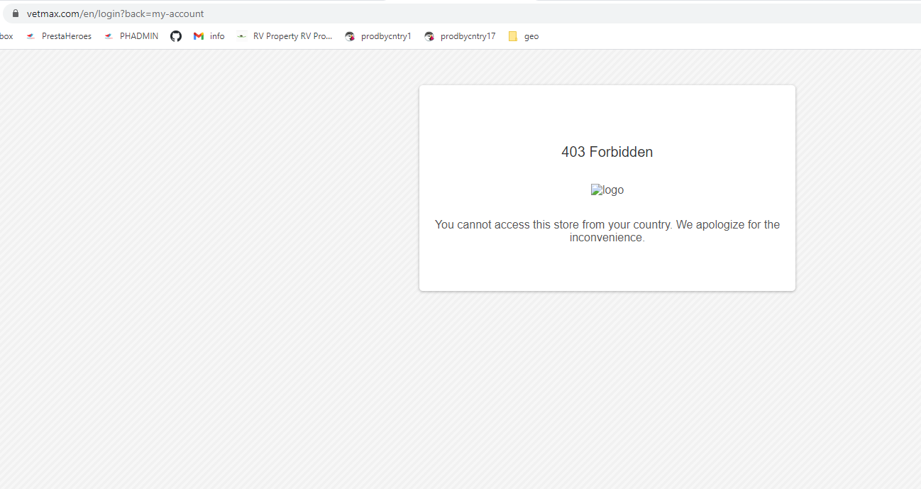

PrestaHeroes.com Posted May 30, 2021 Share Posted May 30, 2021 Hi when I try to view your shop I get 403 forbidden. You have native geo location enabled so if originating country not allowed or IP does not resolve (the free maxmind is not very accurate) your shop will deny either 1) a 403 forbidden or 2) show shop but disallow shopping. I recommend turning this off unless, else you will never know who is blocked and they could be valid customers. without access I cannot say what issue is but this link might be useful. https://www.prestashop.com/en/blog/404-not-found-error-how-to-fix-it this is what I see when I try to access, i.e. as described above Link to comment Share on other sites More sharing options...

clubbuilder Posted May 30, 2021 Author Share Posted May 30, 2021 14 minutes ago, El Patron said: Hi when I try to view your shop I get 403 forbidden. You have native geo location enabled so if originating country not allowed or IP does not resolve (the free maxmind is not very accurate) your shop will deny either 1) a 403 forbidden or 2) show shop but disallow shopping. I recommend turning this off unless, else you will never know who is blocked and they could be valid customers. without access I cannot say what issue is but this link might be useful. https://www.prestashop.com/en/blog/404-not-found-error-how-to-fix-it this is what I see when I try to access, i.e. as described above I have disabled> Geolocation by IP address set to no for access. Link to comment Share on other sites More sharing options...
