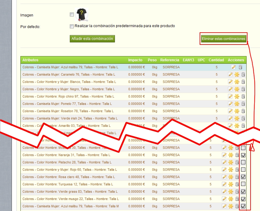

Currently testing Prestashop and Magento, and even though the generator in itself is good, I am truly baffeled over not being able to delete more than one combination at a time. The tick boxes are everywhere else, why not here as well? Deal breaker for me, but this must be fixable?
