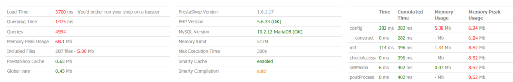

A Bit of Home Posted February 9, 2018 Author Share Posted February 9, 2018 On 2/8/2018 at 3:15 AM, musicmaster said: I am not sure whether it will help but you can at least try profiling. In config/defines.inc.php you set: define('_PS_DEBUG_PROFILING_', true); After you do that you will below each page that you load an overview of the sql queries and how long they took. Thank you for the tip! It tried the setting and I see a massive amount of information. I will have to study this because I am not to sure what I am looking for. To answer your earlier question about our homepage, I am including a snip of part of the debug info from our home page. thanks, Henry Link to comment Share on other sites More sharing options...

bellini13 Posted February 21, 2018 Share Posted February 21, 2018 Seems you are using PHP 5.6, however PS v1.6.1.17 supports PHP 7.0, which will really help with performance. As for page caching modules, I tend not to trust or use them. If they are not designed properly, then the wrong information gets cached and leads to bigger issues. I would uninstall it after switching to PHP 7.0 As for the random slowness, your profile screen shot shows that 1.5 seconds were spent querying the database. That is a very long time to wait, and suggests that either your server or mysql server is not performing well. Could be something to explore with your hosting provider. Link to comment Share on other sites More sharing options...
A Bit of Home Posted February 21, 2018 Author Share Posted February 21, 2018 5 hours ago, bellini13 said: Seems you are using PHP 5.6, however PS v1.6.1.17 supports PHP 7.0, which will really help with performance. As for page caching modules, I tend not to trust or use them. If they are not designed properly, then the wrong information gets cached and leads to bigger issues. I would uninstall it after switching to PHP 7.0 As for the random slowness, your profile screen shot shows that 1.5 seconds were spent querying the database. That is a very long time to wait, and suggests that either your server or mysql server is not performing well. Could be something to explore with your hosting provider. Thank you for the advice. I will approach the technical support at A2 Hosting to see if they can test the PHP 7 configuration and look into what could be happening with the database. Link to comment Share on other sites More sharing options...
