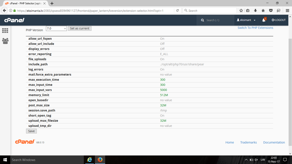

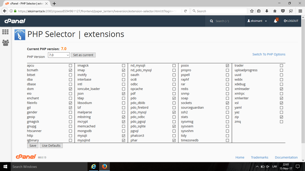

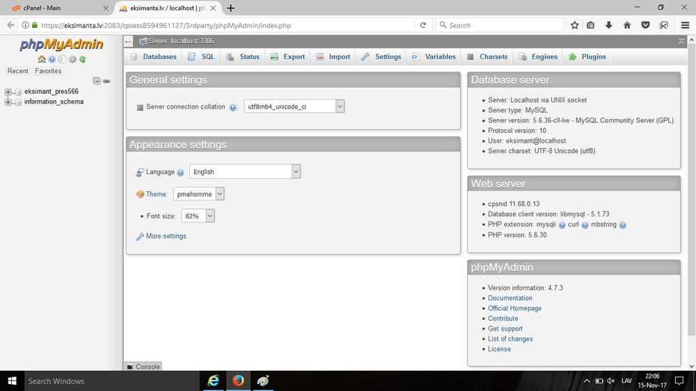

johnxl Posted November 15, 2017 Author Share Posted November 15, 2017 Thanks for answer . On fresh installation without any third party modules on my test domain add to cart button works slow too . 4 seconds to popup . I attached some screenshots from my server configurations . Maybe there you can see where is problem ? Link to comment Share on other sites More sharing options...
bellini13 Posted November 16, 2017 Share Posted November 16, 2017 server performance cannot be rated based on the information you provided. You should contact your hosting provider for support Link to comment Share on other sites More sharing options...

bellini13 Posted November 21, 2017 Share Posted November 21, 2017 i would suggest updating from PHP 5.4, and perhaps updating your database as well. PHP 5.4 is the minimum requirement, but will not provide any performance or speed benefits. Have you explored upgrading PHP to PHP 7.0.x ? Link to comment Share on other sites More sharing options...
west28 Posted November 22, 2017 Share Posted November 22, 2017 First we install this shop on PHP 7.x and nothing in speed happens So we have dedicated server and MariaDb as a Mysql engine. So if you look at screen you can see problem. As I said there is a bug in PS take a look closer in sql query. Why is a doubles for example in: SELECT SUM(`quantity`) FROM `ps_cart_product` WHERE `id_product` = XX AND `id_cart` = XX LIMIT XX I check "cartpresenter" no have idea why sum of quantity is required in cart on product page. Second thing shop is slow down only when you have product with attributes [in my example 55 colors in only one product]. So I thing that is a bug in PrestaShop 1.7 Link to comment Share on other sites More sharing options...
bellini13 Posted November 22, 2017 Share Posted November 22, 2017 3 hours ago, west28 said: First we install this shop on PHP 7.x and nothing in speed happens First, your screen shot says PHP 5.4. And if you enable opcache and actually test the store under load, you will see a huge improvement as compared to PHP 5.4 under load. 4 hours ago, west28 said: So if you look at screen you can see problem. As I said there is a bug in PS take a look closer in sql query. Why is a doubles for example in: Could be a bug, perhaps not. The beauty of open source is that you can change it yourself. If you don't think the sum of products in the cart is needed somewhere else, then change the query and move on. However there is likely a sentence in the front office that tells the customer how many products are in the cart, which would be a sum of the quantity from the cart_product table. (so perhaps its used) Note: The query that you have highlighted would not be affected by the number of products in your store, or the number of product attributes/combinations for a product. The query only selects data from ps_cart_product, and that table stores only the products that customers have added to their carts. SELECT SUM(`quantity`) FROM `ps_cart_product` WHERE `id_product` = XX AND `id_cart` = XX LIMIT XX So the question to ask is, how many records are in the ps_cart_product table, and what are the indexes on that table? Have you executed this query using phpmyadmin to confirm how long it takes, or use any tools that would explain the query or analyze the table data? Link to comment Share on other sites More sharing options...
