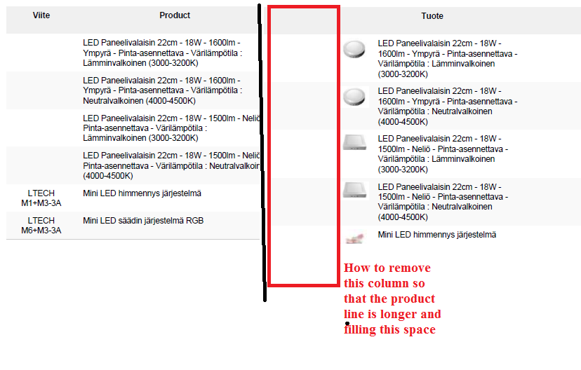

Valoilmio Posted August 11, 2015 Share Posted August 11, 2015 (edited) Hi As defaul the first box in product box is reference. If i remove the reference line from Invoice_product_tab.tpl the invoice then does not add the product name to the full area and the whole invoice gets messed up. Not so familiar with these layout modifications. Maybe the picture shows better what i mean. ( I was able to remove the texts "reference" and the individual printouts of the references) but not the column) Edited August 11, 2015 by Valoilmio (see edit history) Link to comment Share on other sites More sharing options...
tuk66 Posted August 12, 2015 Share Posted August 12, 2015 Remove the columns (<td> ... </td>) from both the table header and the table body. 1 Link to comment Share on other sites More sharing options...

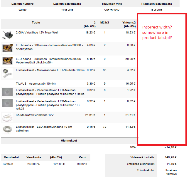

Valoilmio Posted August 17, 2015 Author Share Posted August 17, 2015 Hi. Thank you , it helped but revealed another problem. now the table of products is incorrect size. the width is 100% but. dont know where to change this. (product name would be max size and rest in the right side) -Mikko Link to comment Share on other sites More sharing options...
