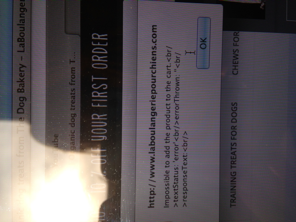

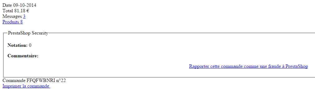

LBPC Posted October 14, 2014 Share Posted October 14, 2014 Hi all Desperately need your help. I've has lots of problems with my site not working with 1&1 (very slow, pages not loading fully, server time outs..) So I upgraded to another contract with them and its been working fine for about a month. Now the same problems are back. Can you guys pls have a look and tell me if the site is working at your end? It's the default theme. Is the home page image to the right, with the coloumn to the left? Can you add products to the basket? Is the basket showing "delivery: 3.90€" once it has a product? Error messages? http://tinyurl.com/o6ap6b8PrestaShop™ 1.6.0.9 From the BO - it loads quickly, I can see all my orders, but can't get into any of them. Nothing was changed since last nite and this morning. Nothing in the logs. Thankyou so much, I need to find out if the problem is a 1&1 server issue again or on the prestashop side. Link to comment Share on other sites More sharing options...
