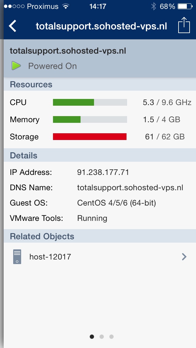

deonderd Posted July 7, 2014 Share Posted July 7, 2014 Hi Guys I have some peformance issues that concerns me. Sometimes my VPS crashes.. because the site is making to many queries any suggestions why this is the case? and what i need to do to be sure it not happens again? Do i need more resources on the vps? or are my settings wrong? And also how can i speed up the sites for visiting customers? my situation is as follows 1 prestashop multistore installation with 15 domains..using the same catalog but in different languages and countries example site http://www.deonderdelenshop.com the shop contains +/- 8000 products VPS 4 CPUS mem 4Gb HarDisk SSD -> 60 GB VMWARE CentOS 4/5/6 (64 bit) Directadmin in attachement U can find printscreens of VPS and debugging on site Link to comment Share on other sites More sharing options...

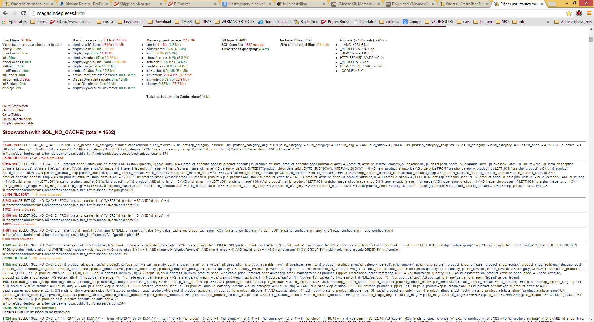

Dh42 Posted July 7, 2014 Share Posted July 7, 2014 What version of Prestashop are you using and is caching turned on? The main query that is killing your shop is because of your block categories module, it seems to be throwing lots of queries out. At the same time it looks like your carrier language has too many rows as well, how many carriers are you running in your shop? Link to comment Share on other sites More sharing options...

deonderd Posted July 7, 2014 Author Share Posted July 7, 2014 (edited) Beneed config info provided by prestashop What do u mean with carrier language? There are 11 languages in the script.. Every domain is set to use 2 or three languages for example belgian site (french, dutch, english) Spanish site (spanish, english) Italian site (Italian, english) Server information Server information: Linux #1 SMP Tue Apr 23 19:29:00 UTC 2013 x86_64 Server software version: Apache/2 PHP version: 5.3.24 Memory limit: -1 Max execution time: 3000 Database information MySQL version: 5.5.31 MySQL engine: InnoDB Tables prefix: prstshp_ Store information PrestaShop version: 1.5.6.2 Shop URL: http://deonderdelenshop.nl/ Current theme in use: default Mail configuration Mail method: You are using the PHP mail function. Your information Your web browser: Mozilla/5.0 (Windows NT 6.3; WOW64) AppleWebKit/537.36 (KHTML, like Gecko) Chrome/35.0.1916.153 Safari/537.36 Ps i will El Patron.. Listen to you .. the pro's... to learn more myself Edited July 7, 2014 by deonderd (see edit history) Link to comment Share on other sites More sharing options...
Dh42 Posted July 7, 2014 Share Posted July 7, 2014 Taken from your screen shot, http://screencast.com/t/VT9iTq1bp You can see there are 14025 rows in that table, something is wrong there should really not be that many rows there, but at the same time I am seeing something similar in other tables as well. Link to comment Share on other sites More sharing options...

deonderd Posted July 7, 2014 Author Share Posted July 7, 2014 i'm not sure.. but when i check in phpadmin.. i noticed before.. that every shop in the multistore setting .. has all the languages in the database.. the logical would be that u have all the languages.. and that every shop uses from those the once they need.. but instead if that .. every shop in multistore has all the languages in the settings not every store can access all the languages in the shop itself.. i asked myself before .. what the use of it is.. tohave all languages for every shop i exported the tabel prstshp_carrier_lang u can find it here https://www.dropbox.com/s/nbel3bhob8s2h0c/deonderd_belgium.xml Link to comment Share on other sites More sharing options...

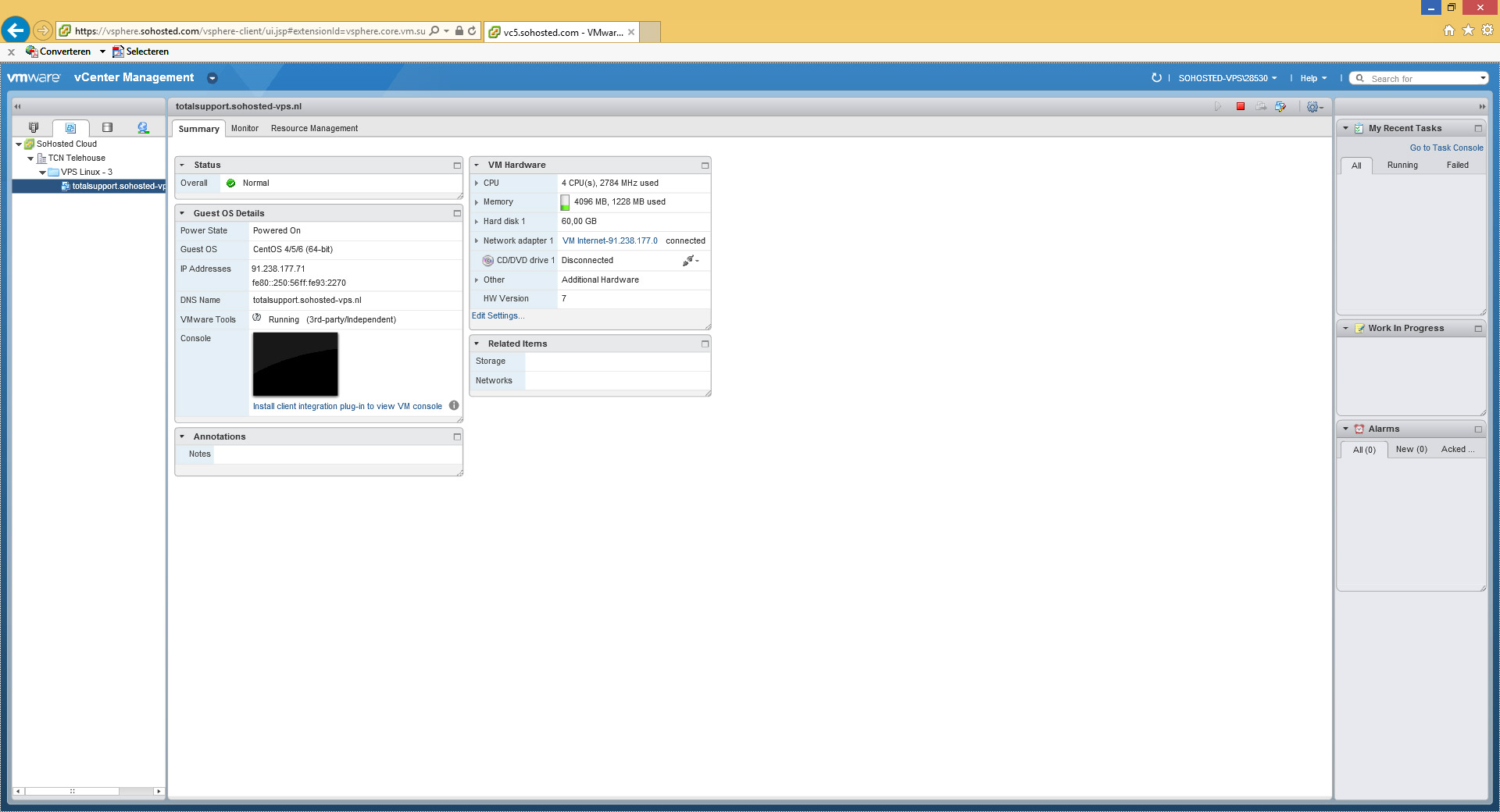

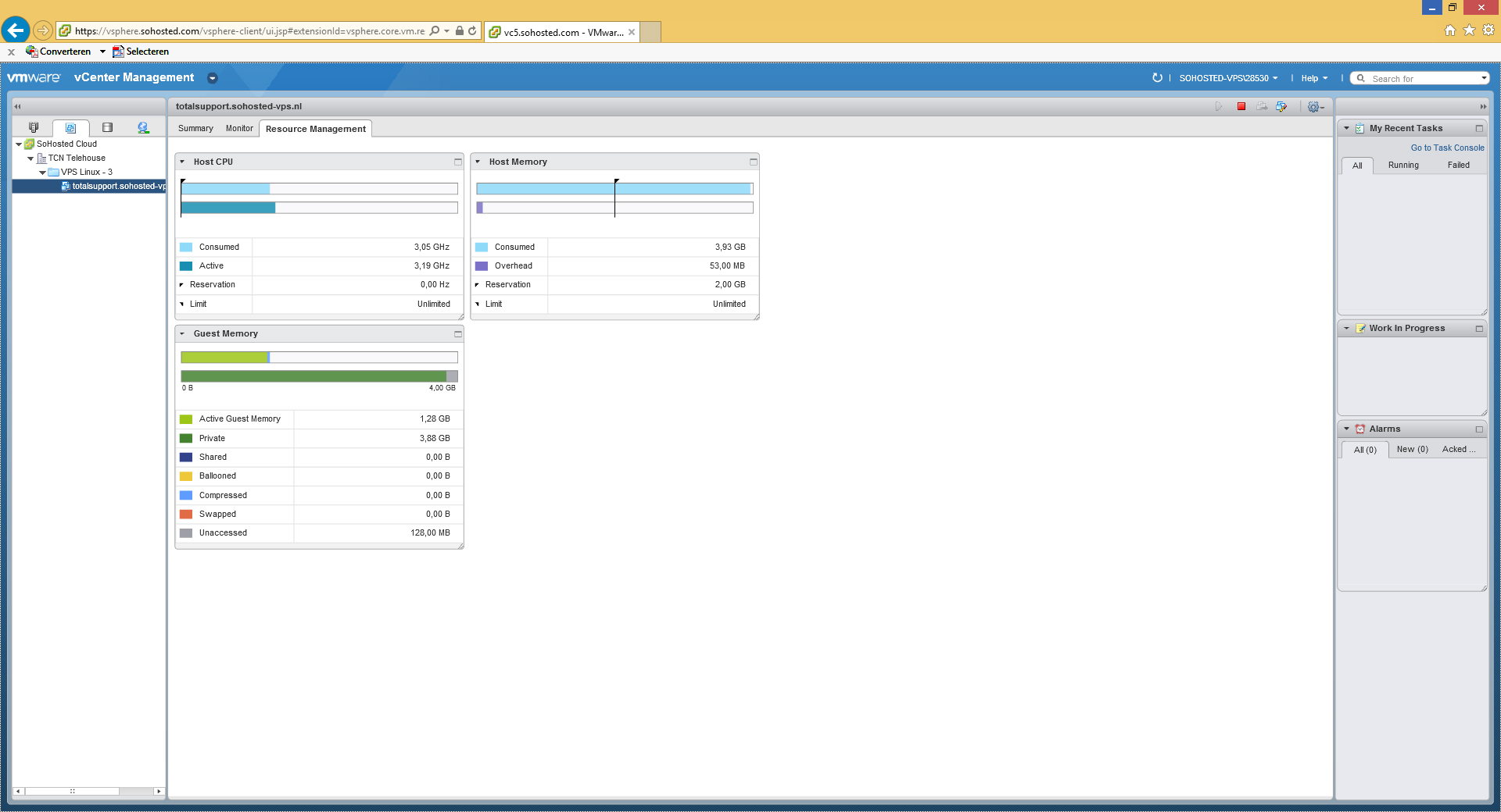

deonderd Posted July 9, 2014 Author Share Posted July 9, 2014 FYI i upgraded my hosting package to 8gb ram and 100 gb HD site seems to run good now during the crash there were some peek moments on disk and ram.. but i dont know where they are comming from.. Do U know anyone with multistore setting and more then 4 languages.. i need to know if the lang query that Dh42 is mentioning is normal or not in my kind of setup thnx mark Link to comment Share on other sites More sharing options...
