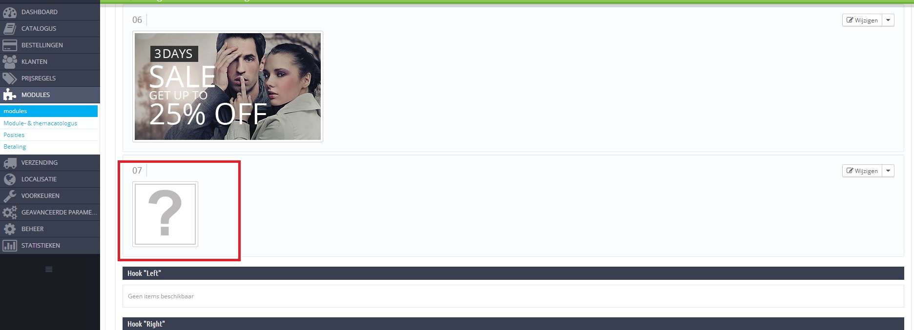

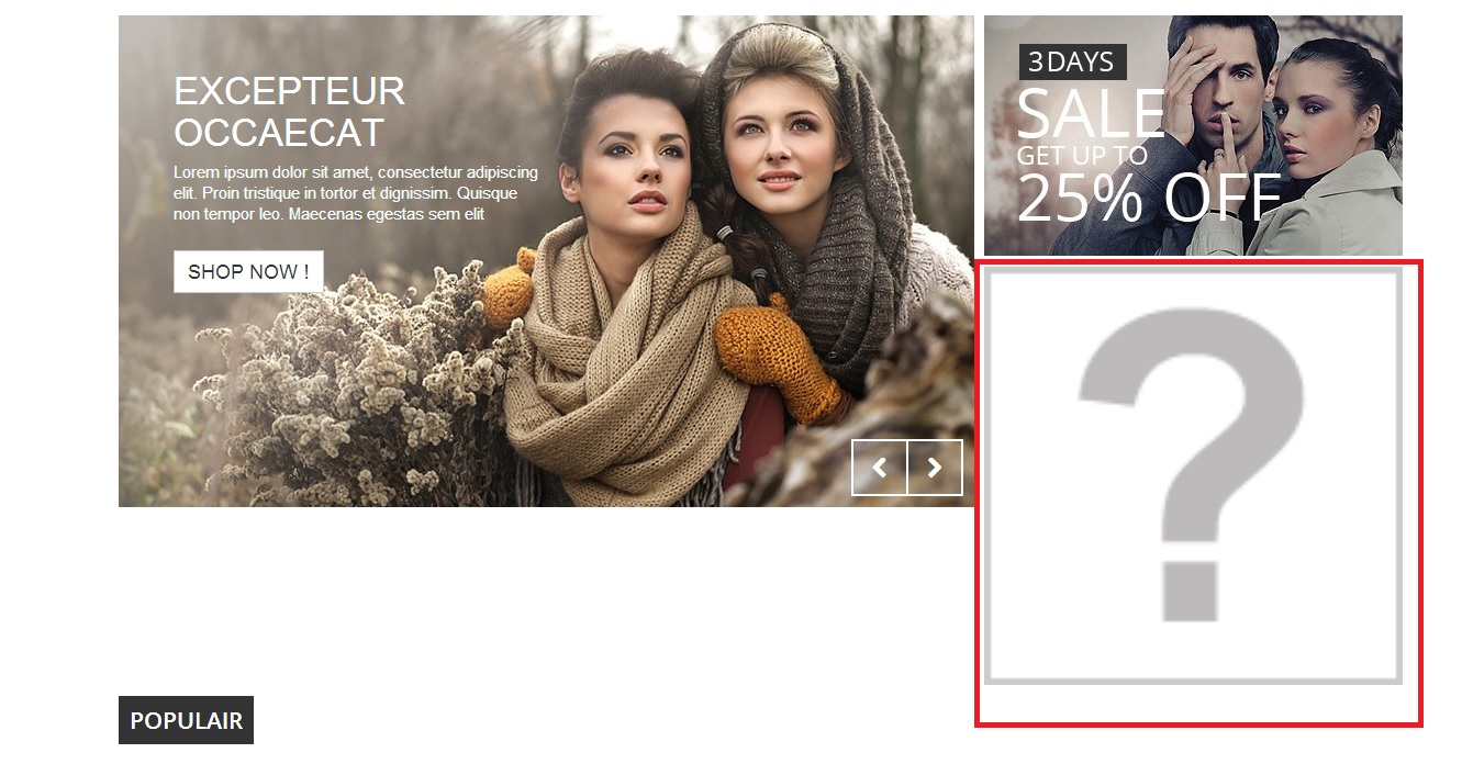

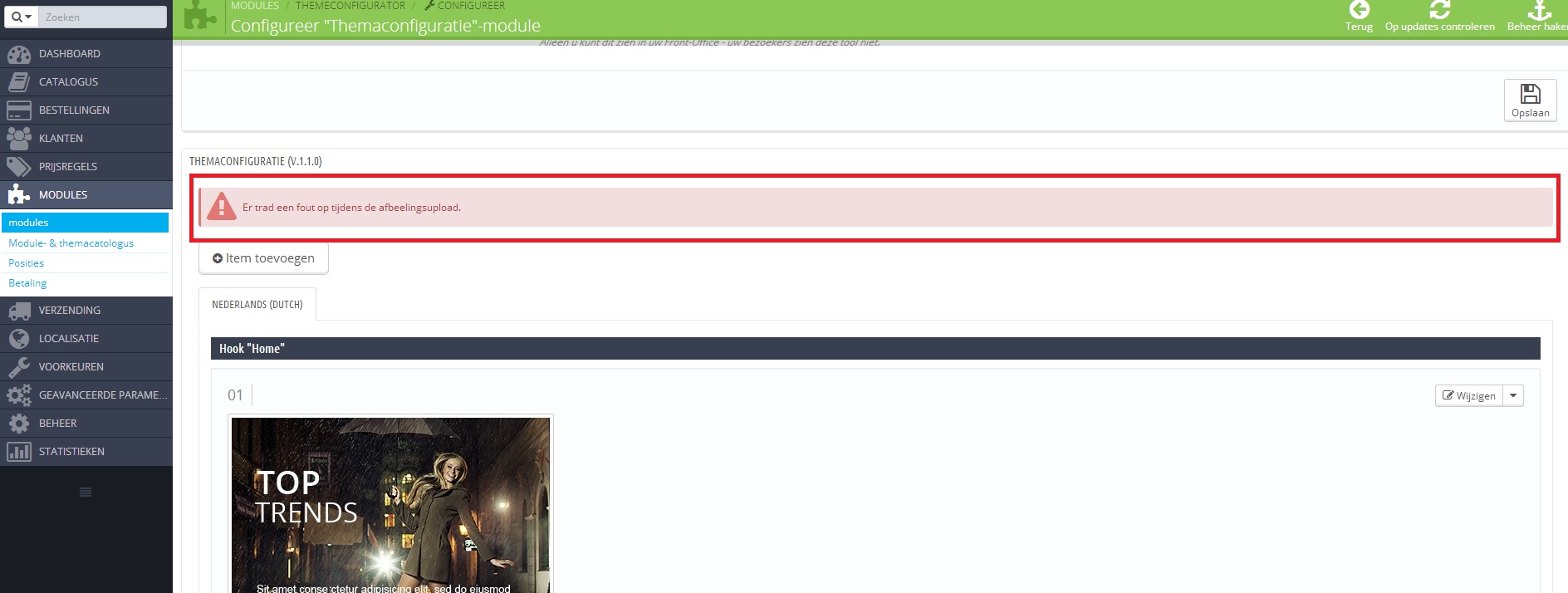

chicaneparts Posted June 6, 2014 Share Posted June 6, 2014 (edited) Hello, I getting this error(img1) error during imageupload and i get a questionmark instead of the image. In all modules and it was working fine before. so i did a fresh install of prestashop 1.6 and tried it right away and still the same error.... What happend because it works just fine before. I get this error in all modules (theme configurator, Image Slidebar etc.) I added some images to this post with the error but the text is in dutch. Error in all prestashop versions 1.5/1.6 Other webshop platforms i dont have any problems uploading images. It worked till a few days ago.... image format not recognized allowed formats are .gif .jpg .png solution is in reply #16 - http://www.prestashop.com/forums/topic/335789-solved-upload-images-error-image-format-not-recognized-allowed-formats-are-gif-jpg-png/?do=findComment&comment=1698739 Edited June 9, 2014 by chicaneparts (see edit history) Link to comment Share on other sites More sharing options...

chicaneparts Posted June 6, 2014 Author Share Posted June 6, 2014 (edited) no the slider wont work either sadly there i get a error that the image format needs to be jpg, gif or png and my image that worked before is jpg.... Edited June 6, 2014 by chicaneparts (see edit history) Link to comment Share on other sites More sharing options...
chicaneparts Posted June 6, 2014 Author Share Posted June 6, 2014 (edited) this is very strange i just did a fresh install of prestashop but i still get this error didn't mesh with anything did the isntall and went straight to the modules same error...... Also its not only the modules its on all upload images in prestashop.... Edited June 6, 2014 by chicaneparts (see edit history) Link to comment Share on other sites More sharing options...
chicaneparts Posted June 6, 2014 Author Share Posted June 6, 2014 well i installed PS 1.5.6.2 and even there i got this error what is this? Can someone help me out with this? Link to comment Share on other sites More sharing options...

chicaneparts Posted June 8, 2014 Author Share Posted June 8, 2014 Well thanks for all the help and lots of reply's....... I found the problem myself so this is solved few bad lines in imagemanager.php Link to comment Share on other sites More sharing options...

gavz Posted June 11, 2014 Share Posted June 11, 2014 I attach the file that i changed hope it works for you guys Also make a backup of the original imagemanager.php incase it didnt work for you. Also this only works for the "image format not recognized allowed formats are .gif .jpg .png error" Works for 1.5 and 1.6 prestashop. Upload it to "your-site.com/classes/ImageManager.php" Thank you for the attachment. After uploading it I'm not getting to following error "Error while uploading image; please change your server's settings. (Error code: 6)". IF some one could offer some advise that would be great, thank you. Link to comment Share on other sites More sharing options...
gavz Posted June 11, 2014 Share Posted June 11, 2014 Thank you for the attachment. After uploading it I'm not getting to following error "Error while uploading image; please change your server's settings. (Error code: 6)". IF some one could offer some advise that would be great, thank you. I've managed to restore image uploading by combining you fix with disabling "php5.ini" / making it a .bak file. Link to comment Share on other sites More sharing options...
gavz Posted June 11, 2014 Share Posted June 11, 2014 I've managed to restore image uploading by combining you fix with disabling "php5.ini" / making it a .bak file. It seems tis solution only lasted a moment. I'm receiving "Error code: 6" again. Any advise would be great appreciated! Link to comment Share on other sites More sharing options...
chicaneparts Posted June 11, 2014 Author Share Posted June 11, 2014 It seems tis solution only lasted a moment. I'm receiving "Error code: 6" again. Any advise would be great appreciated! I changed the file maybe this works for you. Upload here: "your-site.com/classes/ImageManager.php" if its not working for you maybe its a serverside thing did you got the permissions right in the ftp? ImageManager.php 1 Link to comment Share on other sites More sharing options...
gavz Posted June 12, 2014 Share Posted June 12, 2014 I changed the file maybe this works for you. Upload here: "your-site.com/classes/ImageManager.php" if its not working for you maybe its a serverside thing did you got the permissions right in the ftp? Thank you, images are now uploading but it's creating incorrect file names, for example: "2120-home_default.jpg.gif". The ".gif" should not be there? Thank you Link to comment Share on other sites More sharing options...
