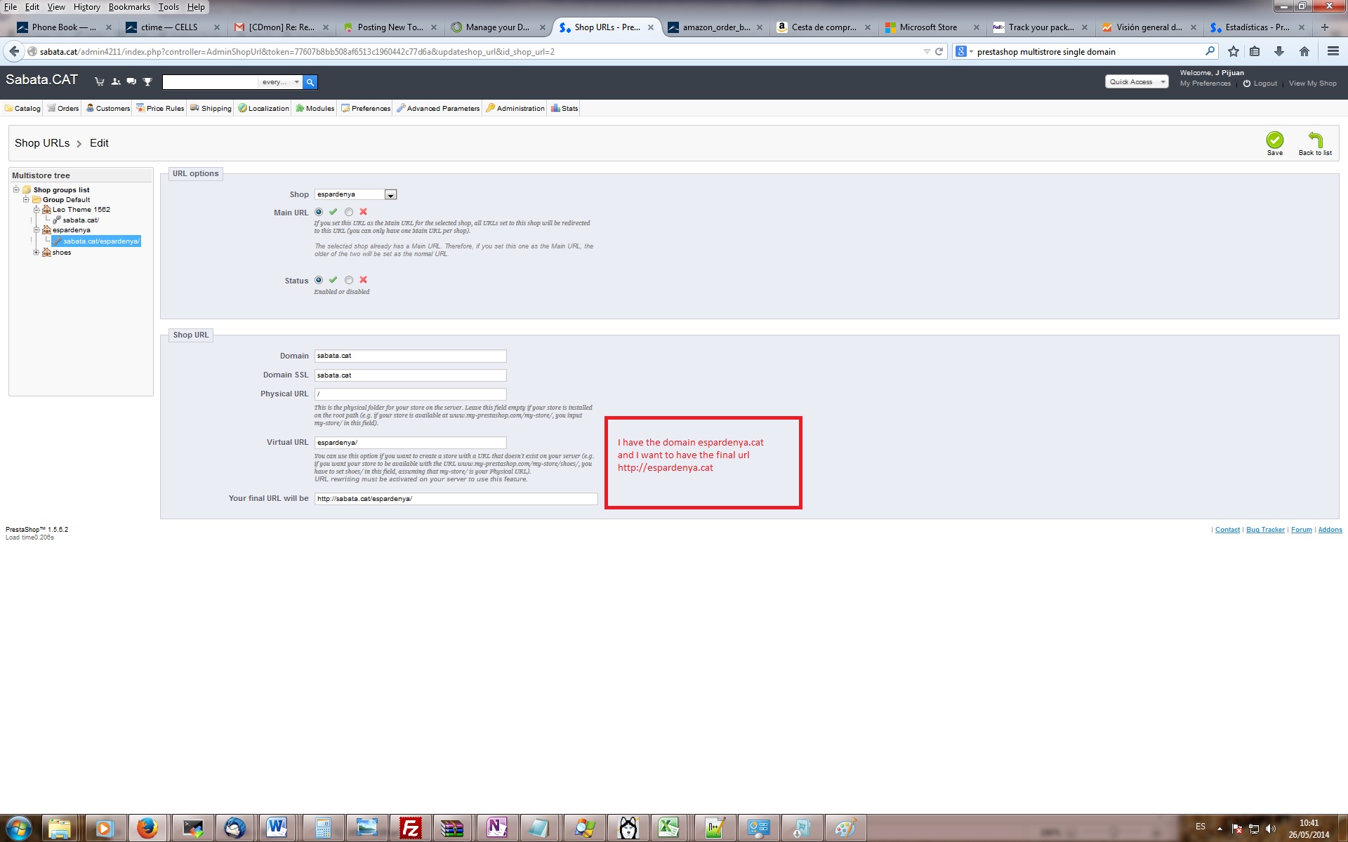

pijucat Posted May 26, 2014 Share Posted May 26, 2014 Dear all; I have a main web site : http://sabata.cat and I have created a new store with multistore functionality and is the URL http://sabata.cat/espardenya. Moreover, I have the domain espardenya.cat , and I would like to change the domain sabata.cat/espardenya to espardenya.cat Is possible to do this? I was searching info in the forum and i don't know how to do this. Thanks in advanced Link to comment Share on other sites More sharing options...
NemoPS Posted May 26, 2014 Share Posted May 26, 2014 Yes. You have to: 1- point your espardenya.cat domain to the same hosting and folder of the primary site. 2- set the second site's url to be espardenya.cat instead of sabata.cat with the added virtual url (espardenya) 1 Link to comment Share on other sites More sharing options...
pijucat Posted May 26, 2014 Author Share Posted May 26, 2014 Thanks for the fast answer. Now, I have the domain espardenya.cat redirected to sabata.cat/espardenya. Following your instructions, I have to change the redirection to sabata.cat (without /espardenya) The second instruction is to configure the parameters of multistore. Is the configuration correct in the attached file? Thanks in advanced Link to comment Share on other sites More sharing options...
NemoPS Posted May 26, 2014 Share Posted May 26, 2014 Almost. The domain should point to the main prestashop folder, the one of the main store, where files are really located 1 Link to comment Share on other sites More sharing options...

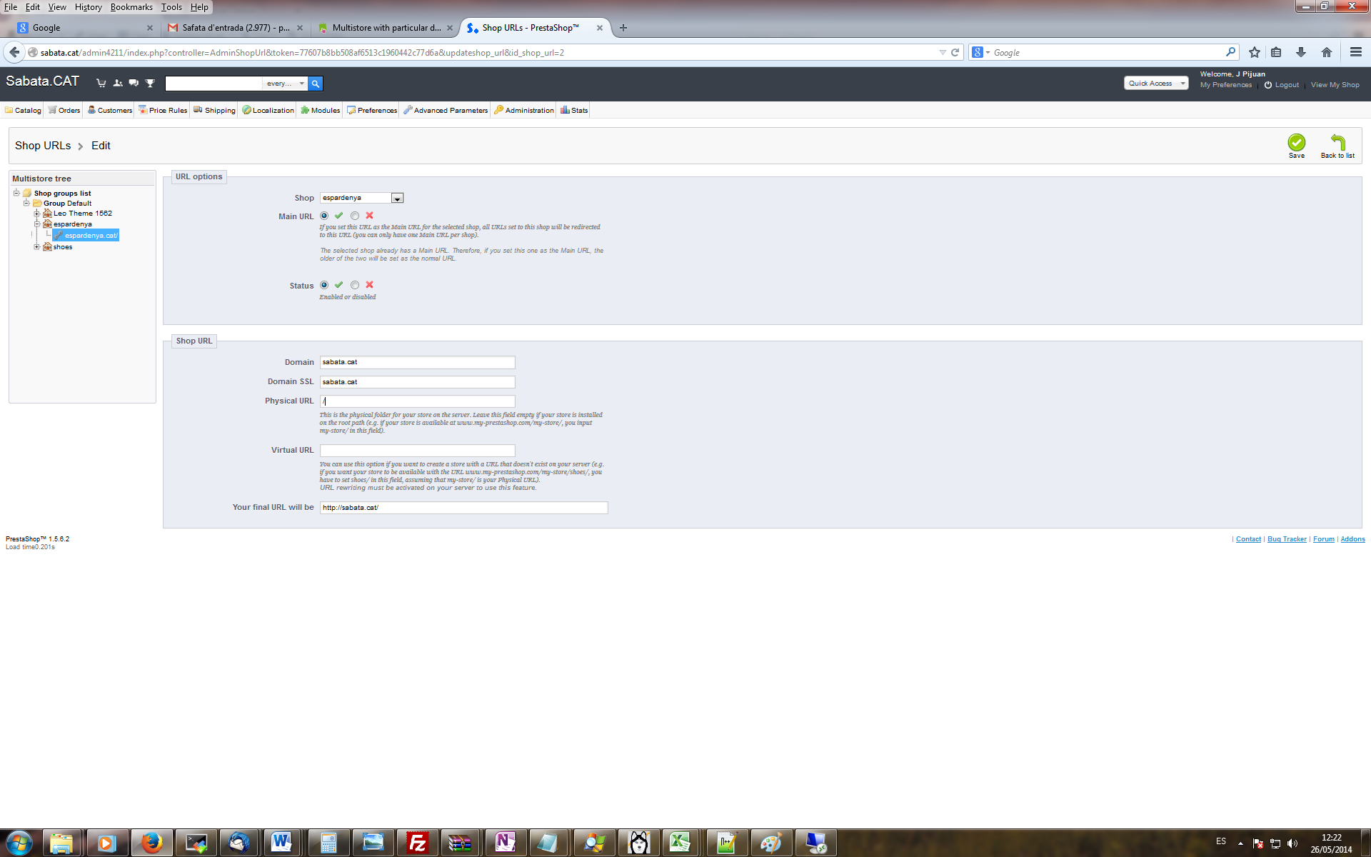

pijucat Posted May 26, 2014 Author Share Posted May 26, 2014 Hello Nemo1; The main folder is sabata.cat, and I have configured the parameters as you say. Is correct the attached configuration? Thanks in advanced, Joan Link to comment Share on other sites More sharing options...
pijucat Posted May 27, 2014 Author Share Posted May 27, 2014 Hi Nemo1; Can you check my configuration with the attached file? Thanks in advanced, Joan Link to comment Share on other sites More sharing options...
NemoPS Posted May 28, 2014 Share Posted May 28, 2014 If sabata.cat (the domain) points to the right folder, then yes 1 Link to comment Share on other sites More sharing options...

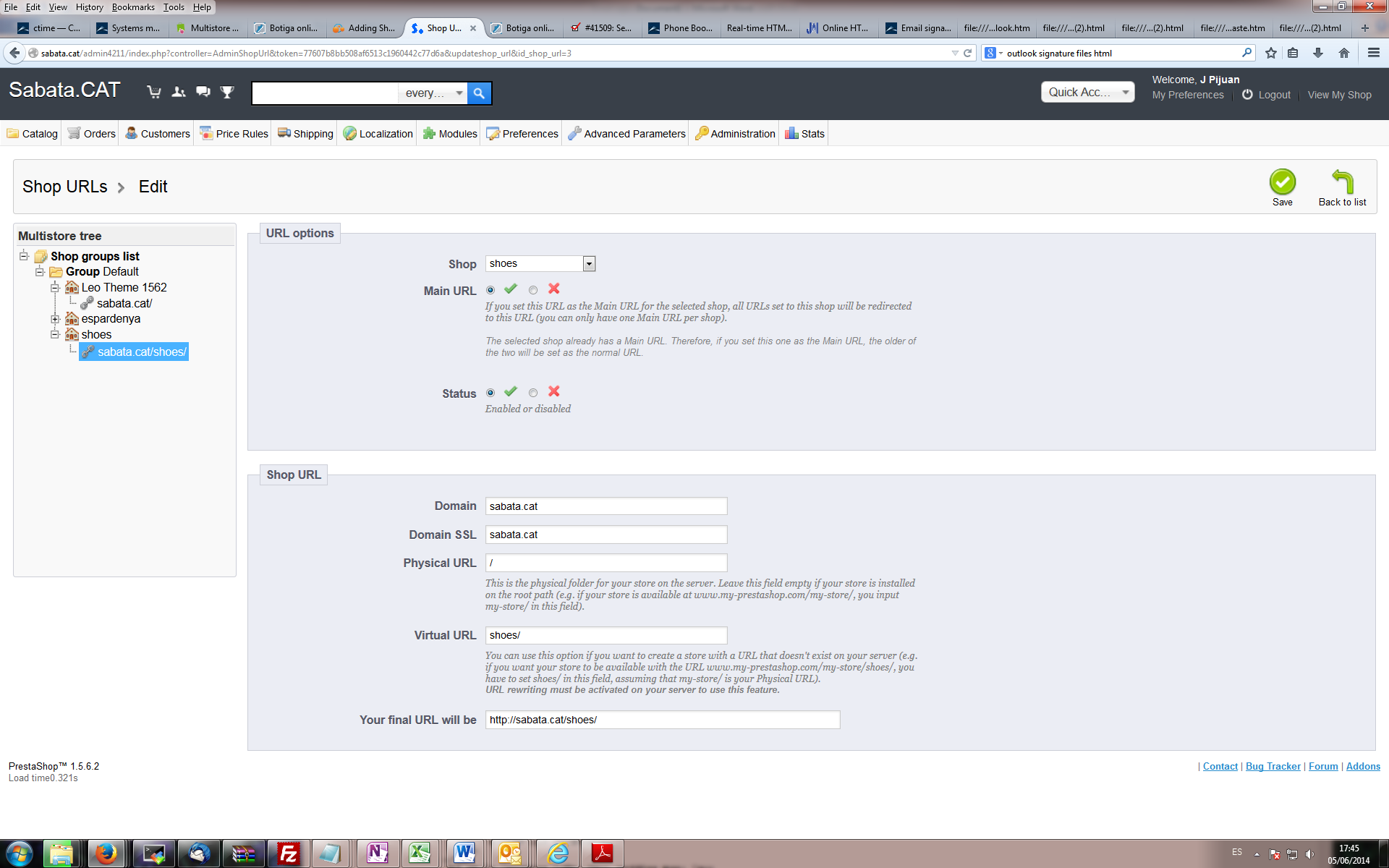

pijucat Posted May 28, 2014 Author Share Posted May 28, 2014 Dear Nemo1; I have tested the configuration and the problem continues.As espardenya.cat is in production, we will work on shoes.cat, if is good for you. I have performed the same configuration as you said for espardenya.cat. But the problem is not solved. The problem is that when I am navigating in sabata.cat/shoes the url have to be shoes.cat. To do this, I 've modified the Multistore configuration and the domain redirection in my ISP as you recommend. Resume of configurations. sabata.cat -> Main Store shoes.cat -> Secondary Store sabata.cat/shoes --shoes is an empty folder espardenya.cat ->Another Secondary Store Domain redirection shoes.cat ->sabata.cat, instead of shoes.cat->sabata.cat/shoes. But if I select sabata.cat in domain of sabata.cat/shoes ( at mlutistore configuration ), error appears because can not extist another store with the same url. See attached files. I hope that this explanations could be useful to solve the problem. Thanks again for the support, Joan Question4.pdf Link to comment Share on other sites More sharing options...

pijucat Posted June 5, 2014 Author Share Posted June 5, 2014 Hi, Can you try by putting Final Url = http://sabata.cat/shoes. Please look at tutorial http://www.webhostinghub.com/help/learn/prestashop-15-tutorials/set-up-multistore-15/adding-shop-urls-multistore Thanks Alok Dear all; My actual configuration is attached in this answer and is exactly what Alok says. Finally,I have redirected shoes.cat to sabata.cat/shoes but I really want to see in the URL shoes.cat. Any idea? It seems an impossible task but I hope that we will resolve successfully. Thanks in advance for your help!! Best regards, Joan Link to comment Share on other sites More sharing options...
