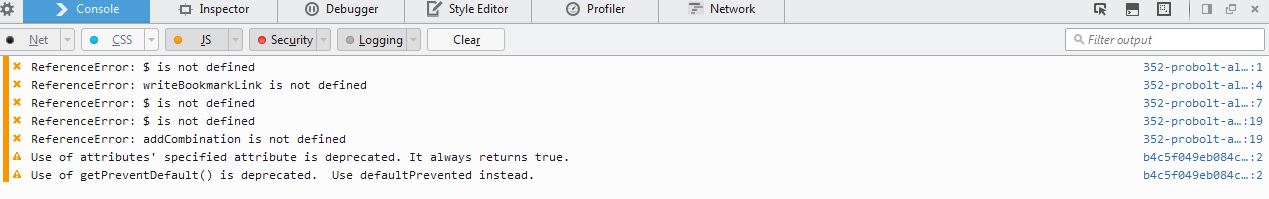

I have used the developer tools in chrome and when you first visit the page it shows the following in the before refresh.jpg below

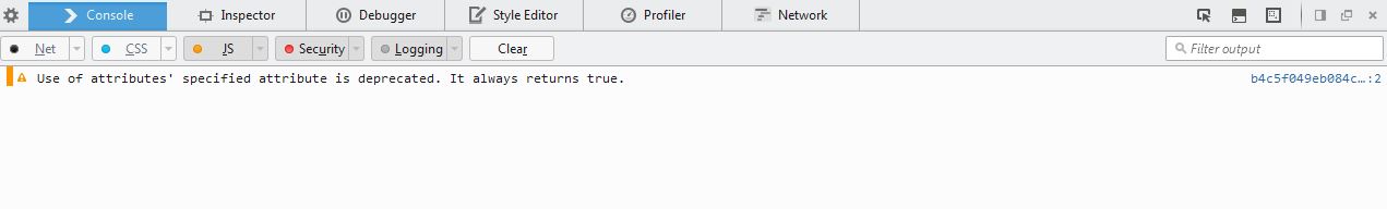

And after you refresh the page it shows the following in the after refresh.jpg below

Thanks again for the reply Jiten, but it was more than just the add to cart button not showing.
I think i have fixed this refresh issue......
In my header.tpl i had
<script type="text/javascript" src="{$js_uri}" async></script>
I removed the "async" and it seems to be working fine now
Does anyone know why adding "async" would stop some of the javascripts loading until the page is manually refreshed ???
