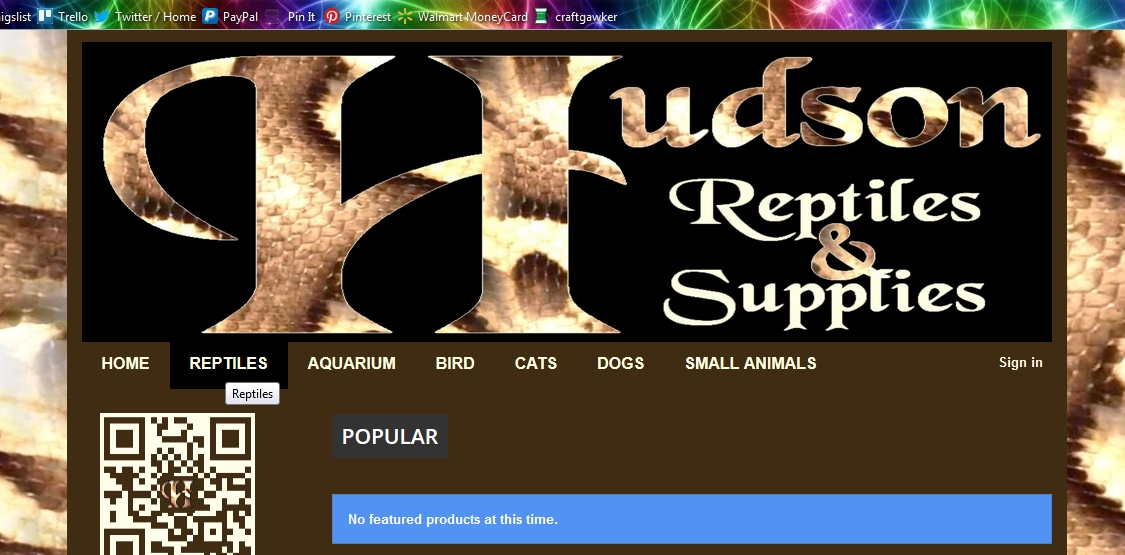

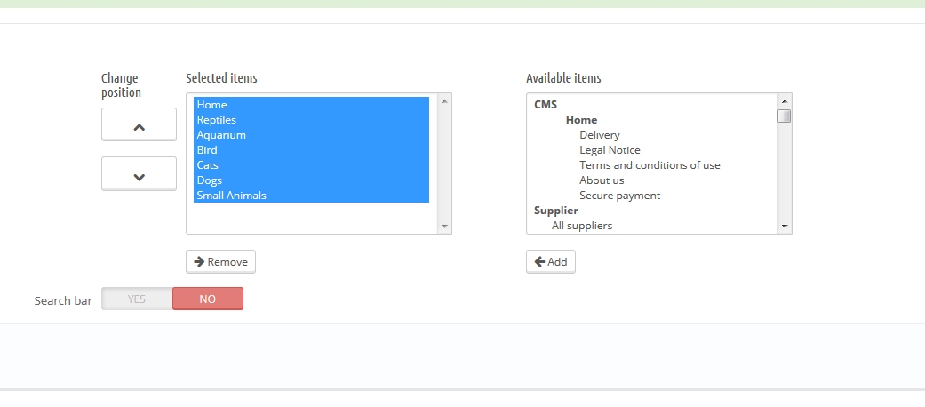

Ok, I have searched through this forum repeatedly to find a solution, but alas, nothing I have tried works.  I think this has something to do with my adding in all my categories via db instead of the back office.  I cannot get my subcategories to show on my front office.  Any assistance would be appreciated.

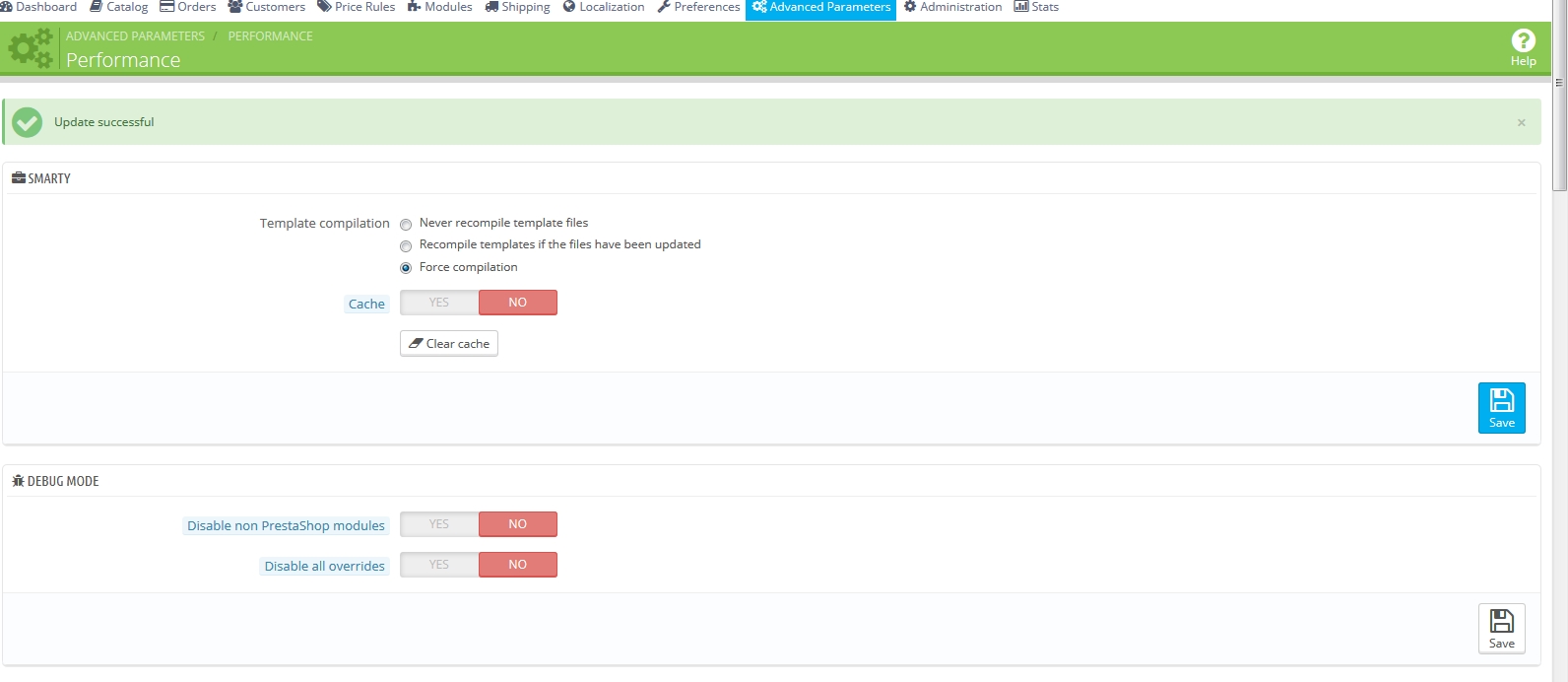

Cleared cache everytime just in case.
See attached images.

strange
i thought that it's a problem with css / js but in fact
there is no subcategories even in the module page source.
what version of module you use?
perhaps you use some module modification? or module .tpl files modifications?

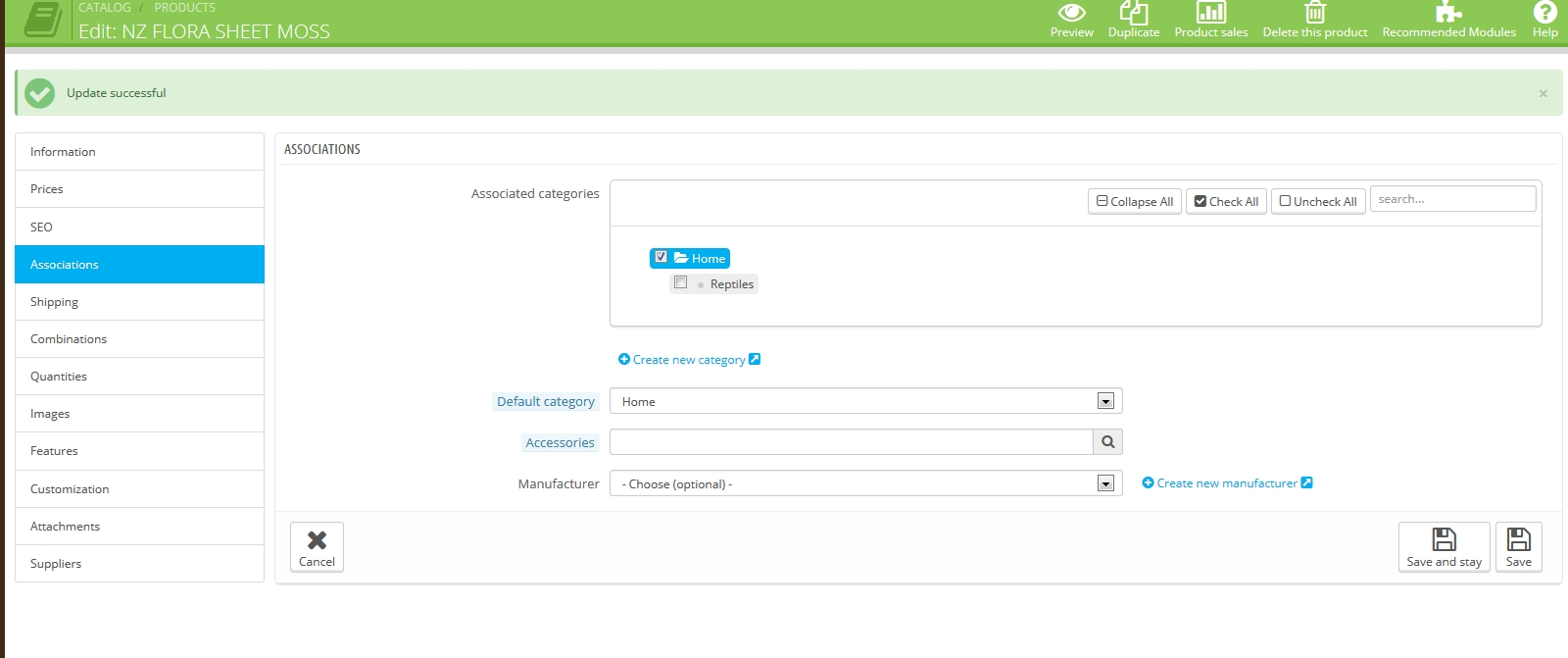

I have only started this page, so I haven't even gotten to the point where I have to start modifying php or tpl files, I have only modified the css.  Also, I realized another issue, while the Home link works (custom link) and the reptiles link works (although no sub menu on hover), none of the other categories work, they all throw a 404.  However, in the sitemap, they are all there.  http://hudsonreptiles.com/sitemap
with that being said, could it be in something I entered wrong in the DB files?  I attached the files if you wouldn't mind looking.  Maybe the nleft and nright, although from what I could tell that was just relating to breadcrumbs.

OMG...I just solved the problem.  OK, for anyone else that is doing this, if you enter your categories via the database and can't see them, create a test category and a subtest category.  The database automatically renumbers the nleft and nright and solves the problem!  Thanks for all that took a look, I just happened to be working on it and fell onto the fix. :D

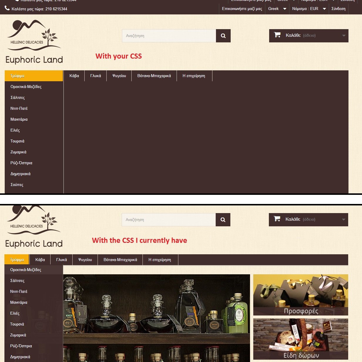

I tried the code you posted above, but I seel to have 2 issues:
1. The top menu is shown as it is supposed to be, but the subcategories look messy. (Please, refer to the image attached below)
2. In the mobile menu, I would like to have a level hierarchy, not everything to be shown at once.
