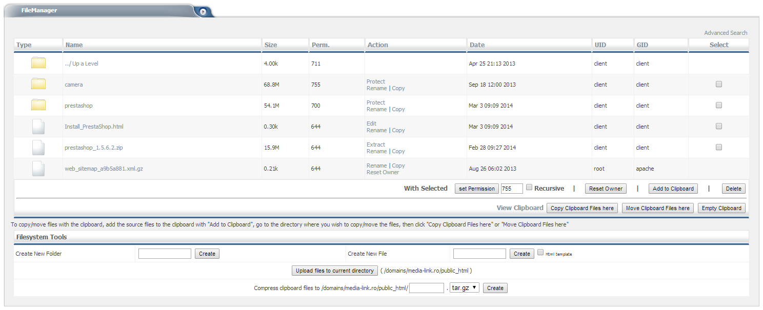

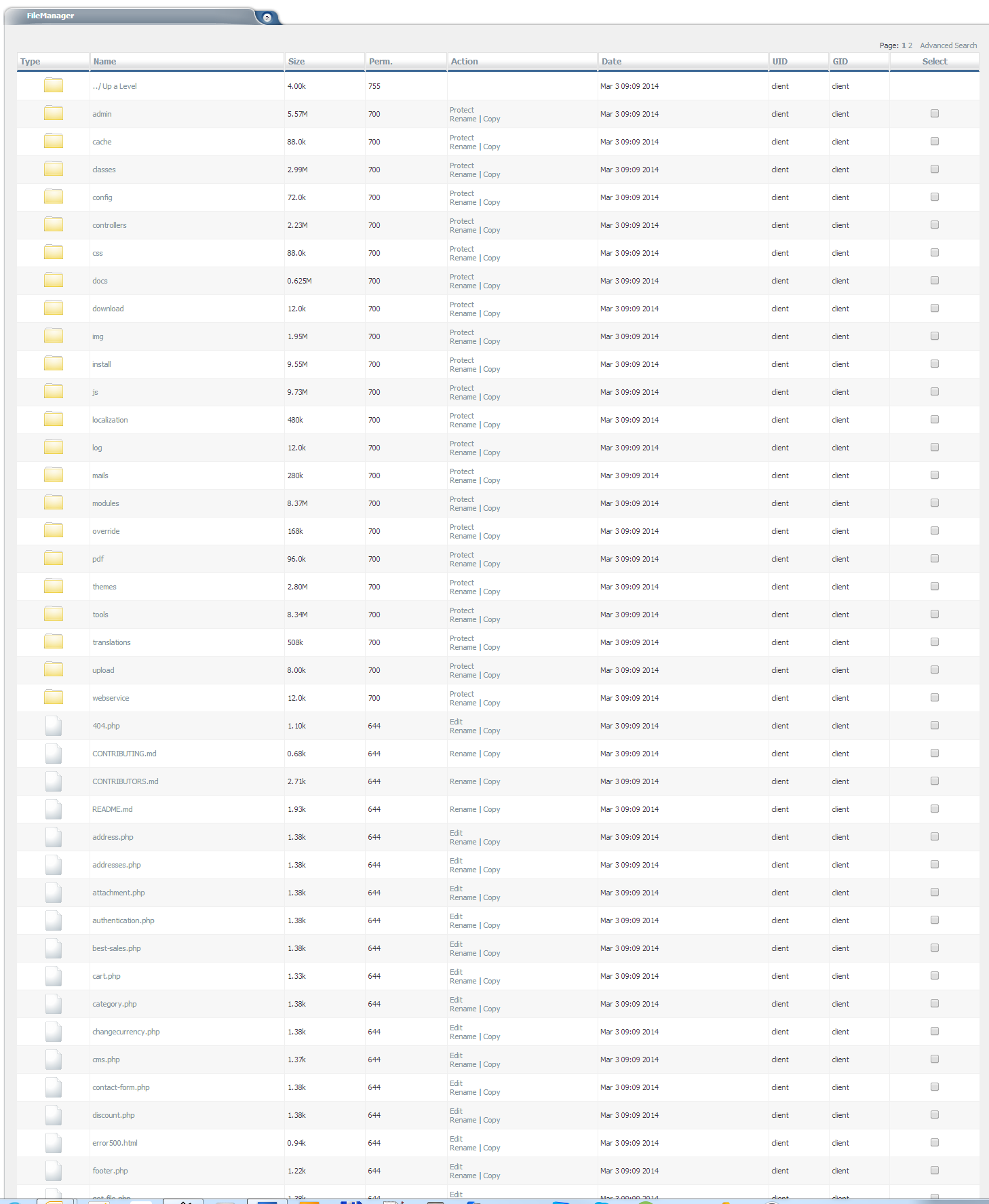

monova Posted March 3, 2014 Share Posted March 3, 2014 Hi there, I have a problem with 1.5.6.1 and 1.5.6.2 archives of prestashop. I downloaded the archives from prestashop website, uploaded them to my hosting server, extracted and all the folders have permission 700 instead of 755. I do not have this problems with 1.5.6.0 archives or lower. Have i done something wrong? Am I the only one with this problem? I did try on 2 different hosting servers, same problem. After extraction: Inside prestashop folder: Link to comment Share on other sites More sharing options...

monova Posted March 3, 2014 Author Share Posted March 3, 2014 (edited) In the public_html folder of my hosting server, (the root i guess) i uploaded the archive via ftp with WinSCP, then i logged in cpanel, selected the archive and clicked Extract. The folder "prestashop" that was extracted got the 700 perm along with all the folders in it without me doing anything else.. This is the result: http://144.76.85.194/~testmedial/prestashop Edited March 3, 2014 by monova (see edit history) Link to comment Share on other sites More sharing options...

maclean_cherry Posted March 4, 2014 Share Posted March 4, 2014 Hi monova, Don't worry, you're not crazy, I see exactly the same thing. I always install shopping carts via SSH. Who seriously has the time to wait for thousands of individual files to upload via FTP? So when I unzip the file on the server all of the folders have permission 700 instead of 755. All of the files are correctly set at 644 though. If you know how to use SSH you can fix this easily. - Login via SSH - Navigate to your Prestashop folder - Enter (without quotes) "find -type d -exec chmod 755 {} \;" This will start in the folder you're in and recursively go through and change the permissions on every folder underneath it to 755. You can add -print before -exec if you want it to list the folders it's changing in your terminal window. If yo ualso had the problem with files being the wrong permissions you could use "find foldername -type f -exec chmod 644 {} \;" Hope that helps. Maclean Link to comment Share on other sites More sharing options...
