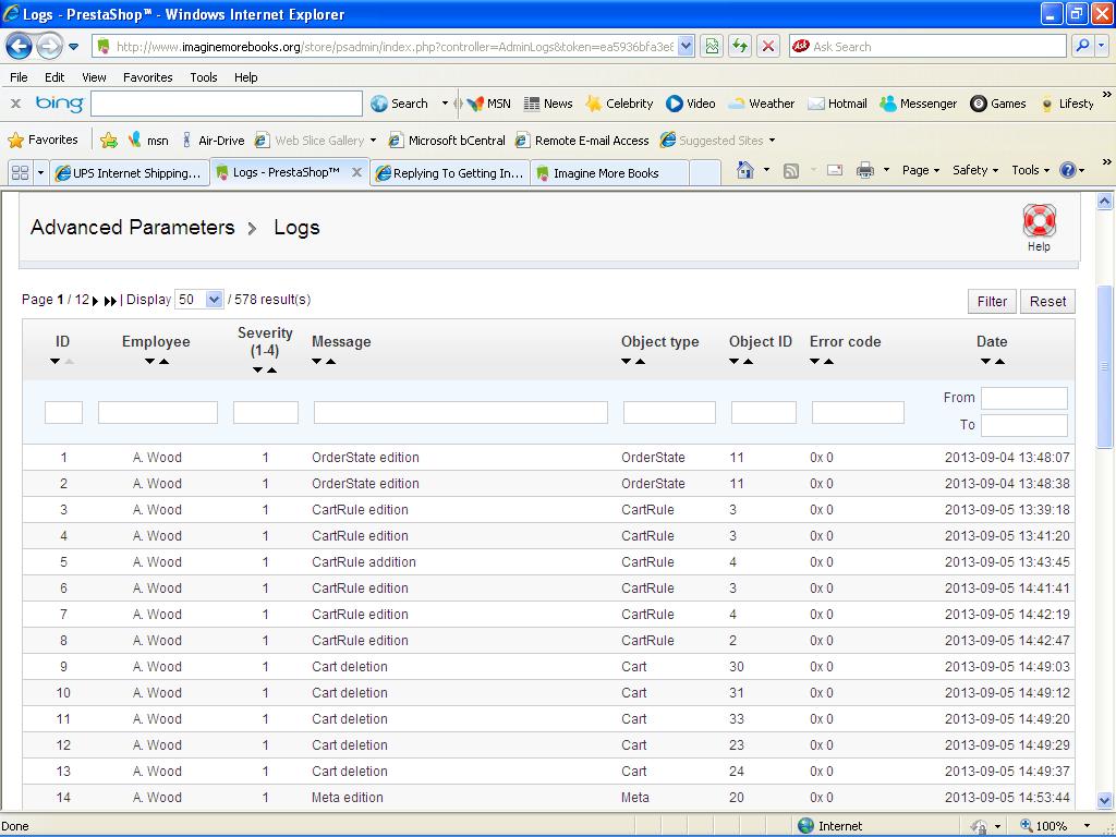

Amy Posted September 13, 2013 Share Posted September 13, 2013 (edited) In the Advanced Parameters under Logs I get an error logged anytime I do anything in prestashop. They are all level 1 informative errors. They show up when I add a product, change a product, go into cart rules, go into employees, etc. The error code is 0x 0. I can't figure out what that meant or how to fix it. My system has been running slow since the upgrade when it comes to adding new products or making changes within existing products. It takes a really log time to save a product. Any ideas? Edited October 23, 2013 by Amy (see edit history) Link to comment Share on other sites More sharing options...

benjamin utterback Posted September 17, 2013 Share Posted September 17, 2013 Hi keskifo, you are recieving the same 0 x 0 in the error log? Can you show me a screenshot? you can change that to line to "true" and save the file to your FTP of Cpanel. Hi Benjamin, I turned on the error reporting and added a new product. The same thing happened where it took a long time to save it. It actually created two entries because I stopped saving and hit save again, which probably caused the problem. It showed up in the log under the advanced parameter with the same error code of 0x 0. I went to the hosting company and looked in the logs but there was nothing in there from today. Is there another file I should look in to find the error code? No, I don't have Yotpo installed. Do you have a link to your website? Are you able to view your best sales items on the front office? Please keep error reporting on during this time if possible. 1 Link to comment Share on other sites More sharing options...
Amy Posted September 17, 2013 Author Share Posted September 17, 2013 Hi Benjamin, The link to my website is: www.imaginemorebooks.org/store I disabled the top-seller block because I didn't want it to show up on the website. But it was working when I had it enabled. I did that on 9/13. The errors started happening after I updated on 9/4/13. Is this the module you are referring to? I will keep the error reporting on. I checked it again about an hour ago and didn't see any errors in the log on my hosting site. I've attached a screenshot. This pic is from the beginning of the log. If you'd like from the end of the log or something else, please let me know. Thanks for your help! Link to comment Share on other sites More sharing options...
benjamin utterback Posted September 17, 2013 Share Posted September 17, 2013 Hi Amy, based on your picture it does not seem like there are any errors. They are level one and just informative. You mentioned that your store was slow after upgrade right? Can you tell me a little more about your stores history? What version did you start from and what versions have you upgraded to? Thanks a lot! 1 Link to comment Share on other sites More sharing options...

keskifo Posted September 17, 2013 Share Posted September 17, 2013 (edited) Hi Benjamin, Well, I receive the same log/error as Amy. The level of severity of the log is low and is only for our information but I'm wondering why I receive those errors which was not the case on my previous prestashop version 1.5.4.1. I have attached a screen capture of the issue I'm seeing. Thanks,F. Edited September 18, 2013 by keskifo (see edit history) 1 Link to comment Share on other sites More sharing options...

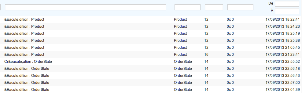

stottycabanas Posted September 23, 2013 Share Posted September 23, 2013 Amy, try reversing all the settings you have in the CCC section of Performance. It will get rid of one of your messages, and may help with the performance too. The other message is most likely due to having Friendly URLs switched off, so you should switch them on. You may need to check with your hosting service whether the Apache function 'mod_rewrite' is enabled. If not, ask them to enable it. Cheers, Dave 1 Link to comment Share on other sites More sharing options...
PrestaHeroes USA Posted September 23, 2013 Share Posted September 23, 2013 My system seems a little better after I cleared the smarty cache, but in the configuation checklist it has some warnings that I'm not sure how to fix. I've attached a picture of the configuation checklist as well as what I have selected in the adv parameter under performance. I thought by clearing the smarty cache that it would fix the warning that says, browser cache & compression, as well as the one that says, combine, compress and cache. But they are still there. I appreciate any help. Thanks! those message mean nothing, please ignore them...you are chasing rainbows. If you shop is working fine...or in your case a little better....then leave it alone.... 2 Link to comment Share on other sites More sharing options...
