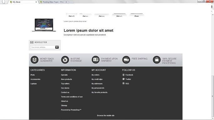

I'm currently running Prastashop 1.5.4.1
On my testpage with a fresh 1.5 installation I can see a big horizontal bar on the bottom. This contains contact information, cms, my account,... (see the attached picture)
On my running page I did an upgrade some time ago, and the bar never appeared as far as I know.
How can I make the bar vissible? The only thing I have on the bottom is 'browse mobile site"
Thanks and Kind regards

hey, if it is possibe - paste the url to your website
we will try to figure out whats going on

@Nemo1: I mean the whole footer. I like to ad the cms block into the footer.
@Vekia: I added my url to my userprofile. (still a lot of work on it)
hello
thanks for the url. i checked it and i don't see any footer as you said.
You should check this:
1) go to modules -> positions. You've got there list of all hooks in your store. Try to search on list "footer"
it should looks like: uUdzcuC.png
Have you got this "hook" on your list?
2) Go to your theme directory - it is here: themes/your_theme/ and open footer.tpl file, have you got there something like:
{$HOOK_FOOTER}

Thanks, I found the solution.
But again I'm facing a new problem. When I ad the cms block to the footer, it displays to much information. I have opened the tpl file. I understand I have to edit this file to delete the unneeded info-tags.
