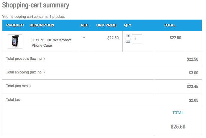

cantcloseaccount Posted October 7, 2013 Share Posted October 7, 2013 (edited) Hi El Patron, Thanks for the reply, I just upgraded to Paypal 3.6, and voucher entry disappeared, If i disable paypal module it returns. 3.6 also fails to return customers to the confirmation page on my site after paypal has taken payment, It just leads them to a black page with the URL: drystore.com.au/buy/modules/paypal/express_checkout/payment.php?token=EC.....(example)....CA2Y Edited October 7, 2013 by louisvs (see edit history) Link to comment Share on other sites More sharing options...

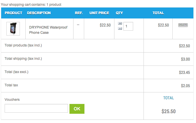

cantcloseaccount Posted October 8, 2013 Share Posted October 8, 2013 Bellini13 Thanks for the feedback, I have checked my paypal settings and corrected the first option to 1) Step 1: "Choose Express Setup" I had it set to "Regular Payments" Still same issue, I then removed the code above and problem was solved. Interestingly, with multishipping on If I clicked the "Ship Products to different addresses" Checkbox, on and then off the voucher box would appear after a few seconds delay. Side note, checked different browsers and Safari and Moz were fine. Just Chrome that had the issue. I'm still having issues with paypal return to confirmation page, post payment, but thats another issue for another post! Many thanks for all your input. Louis Link to comment Share on other sites More sharing options...
