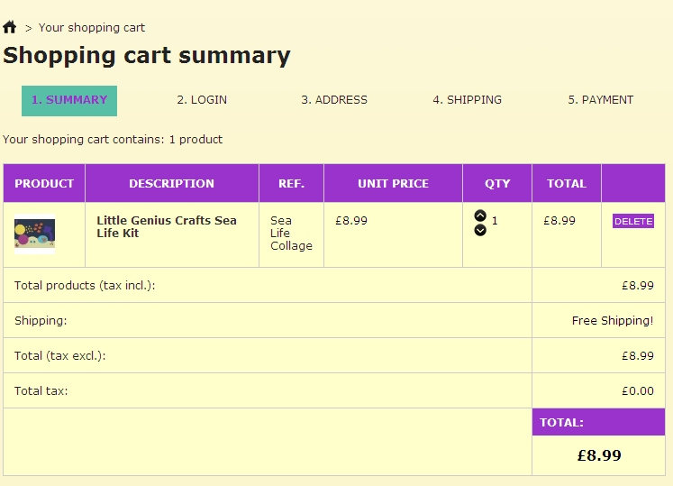

Hi there,

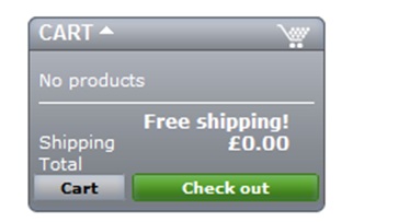

I just upgraded my shop from 1.4.9 to 1.5.0 and have noticed that on the cart block it says "Free Shipping" where it used to say £0.00.
My products have a shipping cost once you check out (one shipping cost no matter what you buy).
Once you add a product in, it changes it to the correct shipping cost.
Anyone know how to turn this off so it says £0.00 again like it used to on 1.4.9?
Also, I have noticed that the "Shipping" and "Total" lines are misaligned with the actual values. So when you add a product in, the shipping line says a value and then below where it says Total, there's no value (so basically the naming of the titles are down 1 line so they don't match up).
Please see the attachment for what I mean.

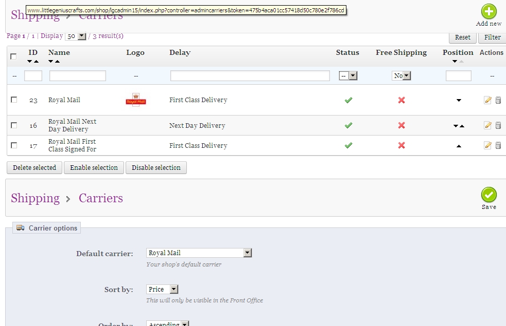

Thanks for all the responses guys! lucamax - no, they both have 'free shipping' disabled.
Haylau, thanks for the comment, yes my weights have been set up correctly. The most confusing thing is that once going through the checkout the shipping is updated properly, it is only when initially adding products to the cart that I have this problem...
  • Like 1
Lachlan, is the shipping carrier you are using the one that came pre-loaded with Prestashop? Meaning is it one of the "dummy" shipping carriers but you just modified it? I had this same issue so I deleted all my shipping carriers so that I had nothing in there. I then added my shipping carrier again, made my weight and price ranges, and voila the "Free Shipping" issue went away.
That's how I fixed my issue with free shipping so you might want to give it a try.

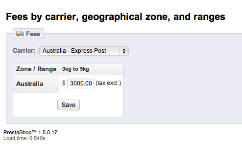

I think I have found the problem (seems to be a bug)
Default carrier is "International Austraila Post" but you will see Austraila Express Post in the first checkout step. The charge is 0 dollars.
The bug is that you can't choose default carrier for the cart. I have set the charge to 3000 dollar so you can see where I have changed.
You should report this to the Bug Tracker. This is a real bug and a bit irritating for the customer if the charge is free and then something else.
Edited by peranders (see edit history)

I have both issues with my 1.5.2. ie: misaligned values and free shipping text! I solved the free shipping text as follows:
I have both free and paid shipping and the free shipping option is for those who live in a specific country HOWEVER I had the groups VISITOR and GUEST turned on so a user without logging in was receiving Free Shipping. When set to default, users must be logged in and so once logged in they will see the free shipping. But this only solved the issue for the non logged in users.
What I did next was to put the POSITION of the free shipping to the very bottom so Presta can choose the paid option first. This actually solved the issue without having to modify the code.
What is still not solved is the misaligned values which are very misleading.

Hi. I know this has been a long-running problem that some people have now fixed, but could anyone help me?
I only ship to the UK and offer no free shipping. When a customer places and item in their cart it automatically states 'free shipping' and this happens on the next page (the bigger cart). It then reverts to the actual shipping costs when someone has logged in.
Although it's correct in the end, it looks really bad and like I'm 'baiting' customers with free shipping until I've got them signed in and tell them I'm charging them.
Any suggestions greatly appreciated, thank you.

I only have one zone enabled - UK, with no free shipping offered and yet 'free shipping' still comes up in the cart when a user is not logged in.
Could any clever person out there tell me where I can comment out the code that offers free shipping on the cart? At this stage, if I can't actually apply the shipping I want, I'd happily leave the line blank instead until my user has logged in, thanks.

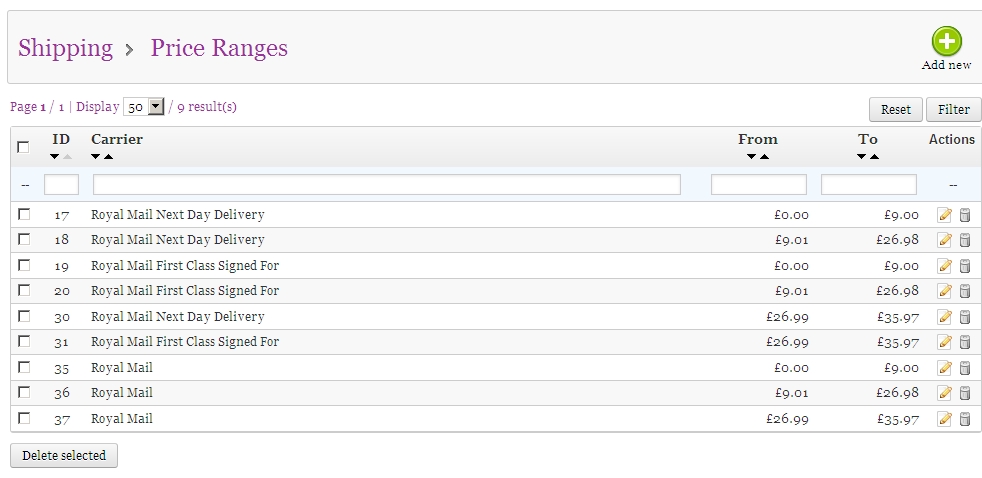

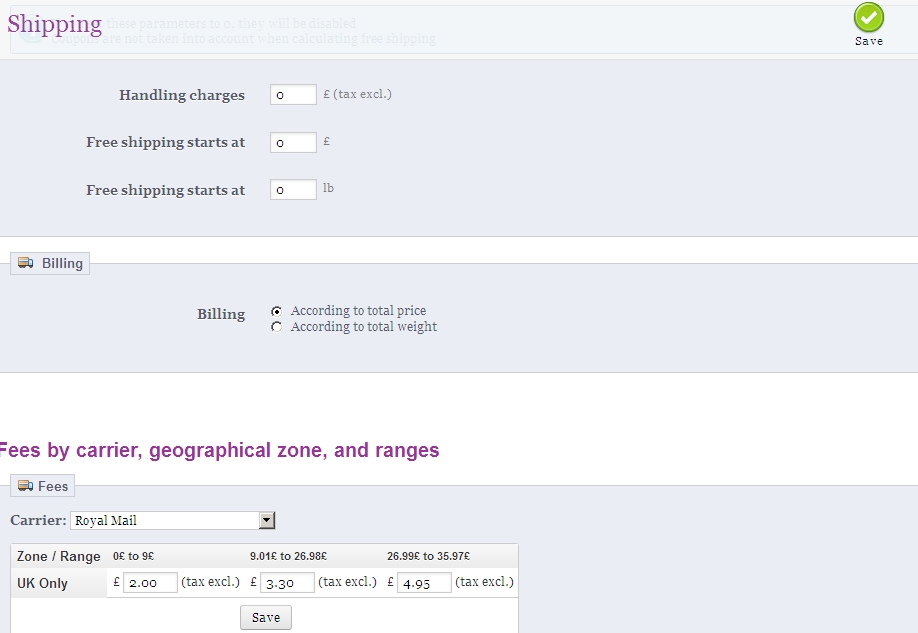

Hi,
Further to the above post, I thought it might be helpful to post these screen shots of my settings, and of the cart on my site offering free shipping, in case anyone sees an obvious problem. NB: for the 'free shipping starts at' field. I have read conflicting advice about this and have tried it on 0 and also on 100000, but it changes nothing.
Thanks - would really appreciate any suggestions you may have.
Hi,

I wonder if there may be an issue with your zones, UK Only
Did you create that zone or rename it? Chekc that all your carriers do link to that. If you renamed / created it after creating the carriers then it may be that things are not carrying through correctly
@ramfeirda confirms the problem is in 1.5.2. Also @ramfeirda is right - this is a config problem - it might be called an insidious one.
The cart is trying to use the default shipping method for the shop. Therefore this problem happens when the default shipping method for the shop is out of range for the user. The cart falls back to the lowest-cost method of shipping for that user. Reminder: users are always part of groups. The cart wants to display the cheapest method of shipping. If any user group has free shipping - voila - the user sees free shipping in their cart.
Thus, to trigger the problem all you need is the default shipping method for the store to be out of range for the user's current order (reminder: users are always in a user-group); and have a user group with free shipping applied. We're not merging 1.5.2 code right now. We're staying on a frozen codebase for the time-being and will selectively merge updates from a stable branch.
As for zones I'm not sure exactly how that plays in - we have one zone (USA), with no free shipping applied to any user group; and no free shipping applied to any zone.
The SQL patch above is for 1.5.0.17. Since the problem is confirmed on 1.5.2 the patch is still valid, though line numbers probably changed.
This is how I fixed it on our shop:
- Made sure the default shipping method for the shop will be in-range for most or all of the orders we expect on the shop.
- Make sure no user groups have free shipping applied. This is in the group's (edit) settings.
- Make sure all shipping methods have price ranges applied to them.
- Like @ramfeirda says - the patch is optional. I'll defend the patch though -- that join should be there and it's an improvement to the production code. The original query should not only be pulling all records from product_shop filtered only on shop_id, the join should also be filtered on product_id.
