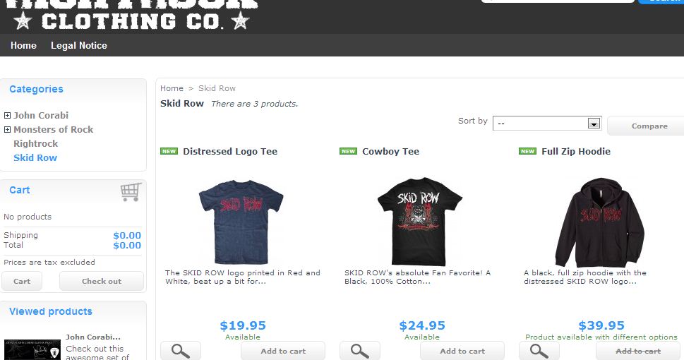

ShirtSeller Posted January 2, 2012 Share Posted January 2, 2012 Hey all - running a new install of 1.4.6.2. When a customer clicks on a category it normally lands on that category page and displays images and links of any subcategory and then all of the products below that. I want to remove that section that shows any subcategories and want it to look like a category with no subs. Two attachments: Remove sub shows the category that has sub cats (that I want to remove) I would like it to look the same as a category with no subs (no sub cats image) Thanks in advance for any assistance! Joe Link to comment Share on other sites More sharing options...

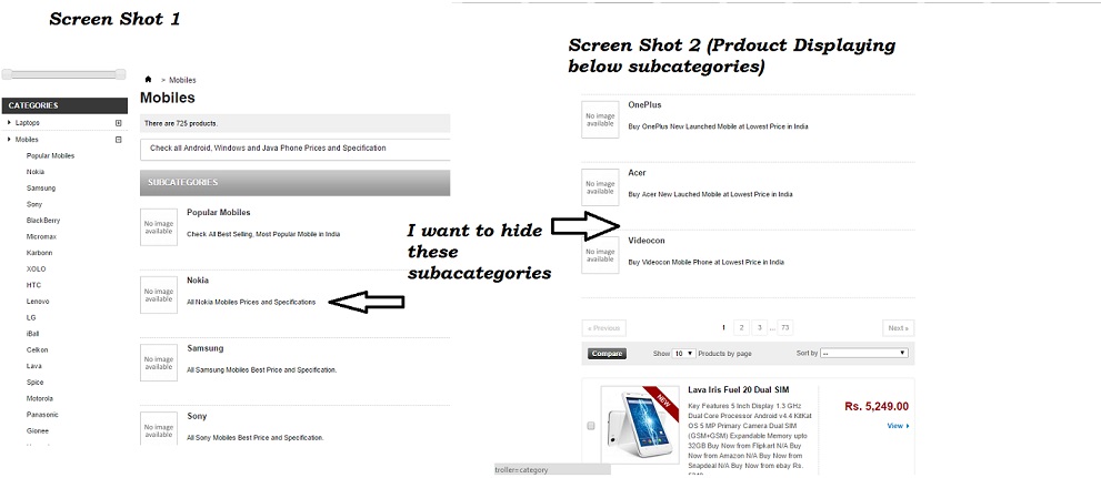

somits1 Posted February 20, 2015 Share Posted February 20, 2015 Hi, This is Somit and running my site http://slmobileprice.com using prestashop v1.5.6.2 english. In this version this code not available. In my site i want to hide categories from center (above product page). Whenever i click on Categories their subcategories also showing on product page. So could you please tell me how to hide subcategories from the product page.. Please check screen shot. Thanks, Somit Link to comment Share on other sites More sharing options...

vekia Posted August 12, 2016 Share Posted August 12, 2016 step by step tutorial: disable subcategories list from category page open "theme configurator" module settings page, there is an option to enable / disable subcategories Link to comment Share on other sites More sharing options...
somits1 Posted August 12, 2016 Share Posted August 12, 2016 Thanku so much Vekia. done. Link to comment Share on other sites More sharing options...
