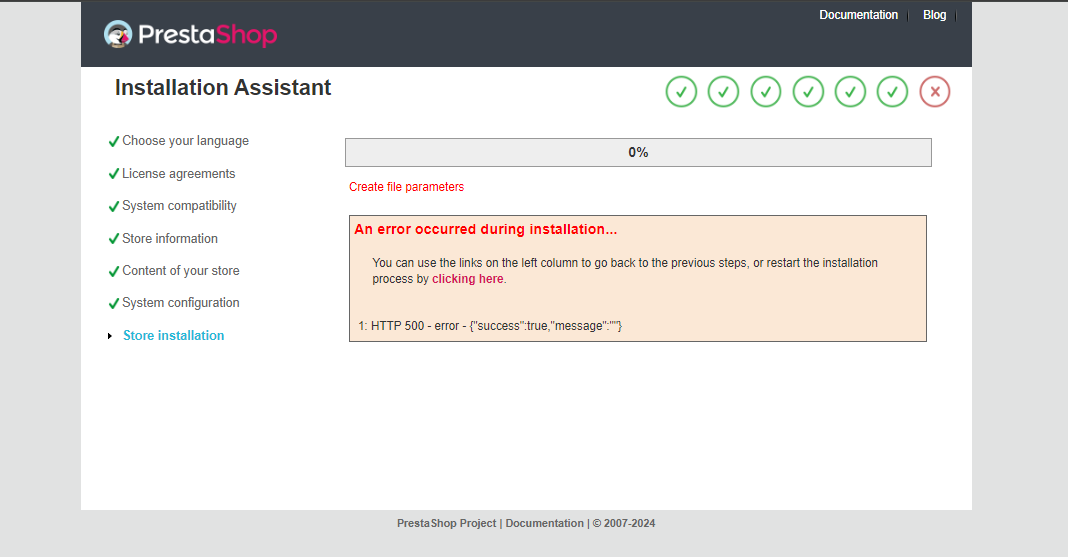

Classie Posted October 1, 2023 Share Posted October 1, 2023 (edited) Hi, I am doing a brand new installation with new database and getting the following error. An error occurred during installation... You can use the links on the left column to go back to the previous steps, or restart the installation process by clicking here. 1: "An exception occurred while executing 'INSERT INTO `ps_link_block_shop` (`id_link_block`, `id_shop`, `position`) VALUES\n (1, 1, 0),\n (2, 1, 1);':\n\nSQLSTATE[23000]: Integrity constraint violation: 1062 Duplicate entry '1-1' for key 'PRIMARY'" Thanks Edited October 1, 2023 by Classie edited Topic name from New installtion to New installtion error (see edit history) Link to comment Share on other sites More sharing options...
endriu107 Posted October 1, 2023 Share Posted October 1, 2023 Clear your database and try install one more time. Link to comment Share on other sites More sharing options...
Classie Posted October 1, 2023 Author Share Posted October 1, 2023 (edited) Hi, I have deleted the database and user and used a new database name and user name and still getting an error: Could it be permission on folders or PHP module ? Tried it again and got the same error now 1: "An exception occurred while executing 'INSERT INTO `ps_link_block_shop` (`id_link_block`, `id_shop`, `position`) VALUES\n (1, 1, 0),\n (2, 1, 1);':\n\nSQLSTATE[23000]: Integrity constraint violation: 1062 Duplicate entry '1-1' for key 'PRIMARY'" Edited October 1, 2023 by Classie added to description (see edit history) Link to comment Share on other sites More sharing options...

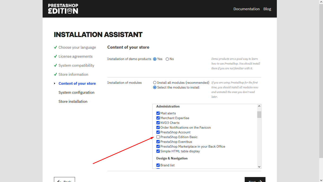

musicmaster Posted October 1, 2023 Share Posted October 1, 2023 This problem has been mentioned before in this forum. Your problem is that the module ps_edition_basic requires PHP 8.1 and you are running a lower PHP version. You can see that when you enable debug mode and then click the retry link. There are three possible solutions: - switch to PHP 8.1 - Use the Github version of Prestashop that comes without ps_edition_basic and some other modules (https://github.com/PrestaShop/PrestaShop/releases/tag/8.1.1) - delete the ps_edition_basic directory under the /modules directory and then click the retry link 1 Link to comment Share on other sites More sharing options...

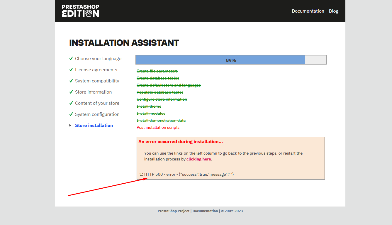

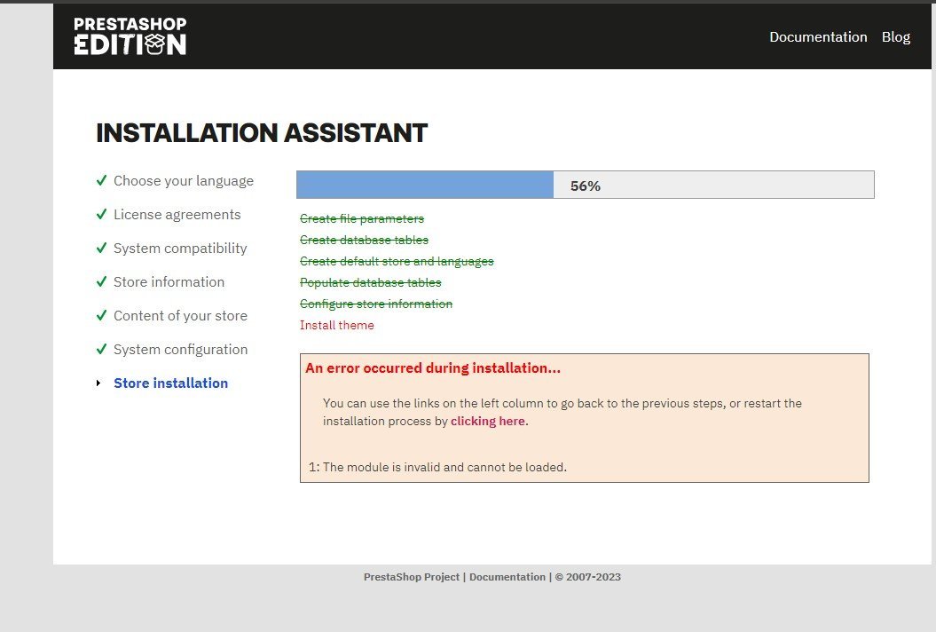

Zohaib-fk Posted October 2, 2023 Share Posted October 2, 2023 (edited) When I unchecked Ps edition basic and continued with installation, I got an error post-installation script. Attached are screenshots for reference. Any idea what is going wrong? The below link says PHP 7.2 and later versions will be ok with PS version 8 https://docs.prestashop-project.org/v.8-documentation/getting-started/what-you-need-to-get-started Edited October 2, 2023 by Zohaib-fk New information content added (see edit history) Link to comment Share on other sites More sharing options...
musicmaster Posted October 2, 2023 Share Posted October 2, 2023 (edited) 9 minutes ago, Zohaib-fk said: When I unchecked Ps edition basic and continued with installation, I got an error post-installation script. Attached are screenshots for reference. Any idea what is going wrong? The below link says PHP 7.2 and later versions will be ok with PS version 8 https://docs.prestashop-project.org/v.8-documentation/getting-started/what-you-need-to-get-started That is a different way of removing the module than I did. What happens when you enable debug mode before you click the link for restarting the installation process? At this stage all the files are there. Edited October 2, 2023 by musicmaster (see edit history) Link to comment Share on other sites More sharing options...

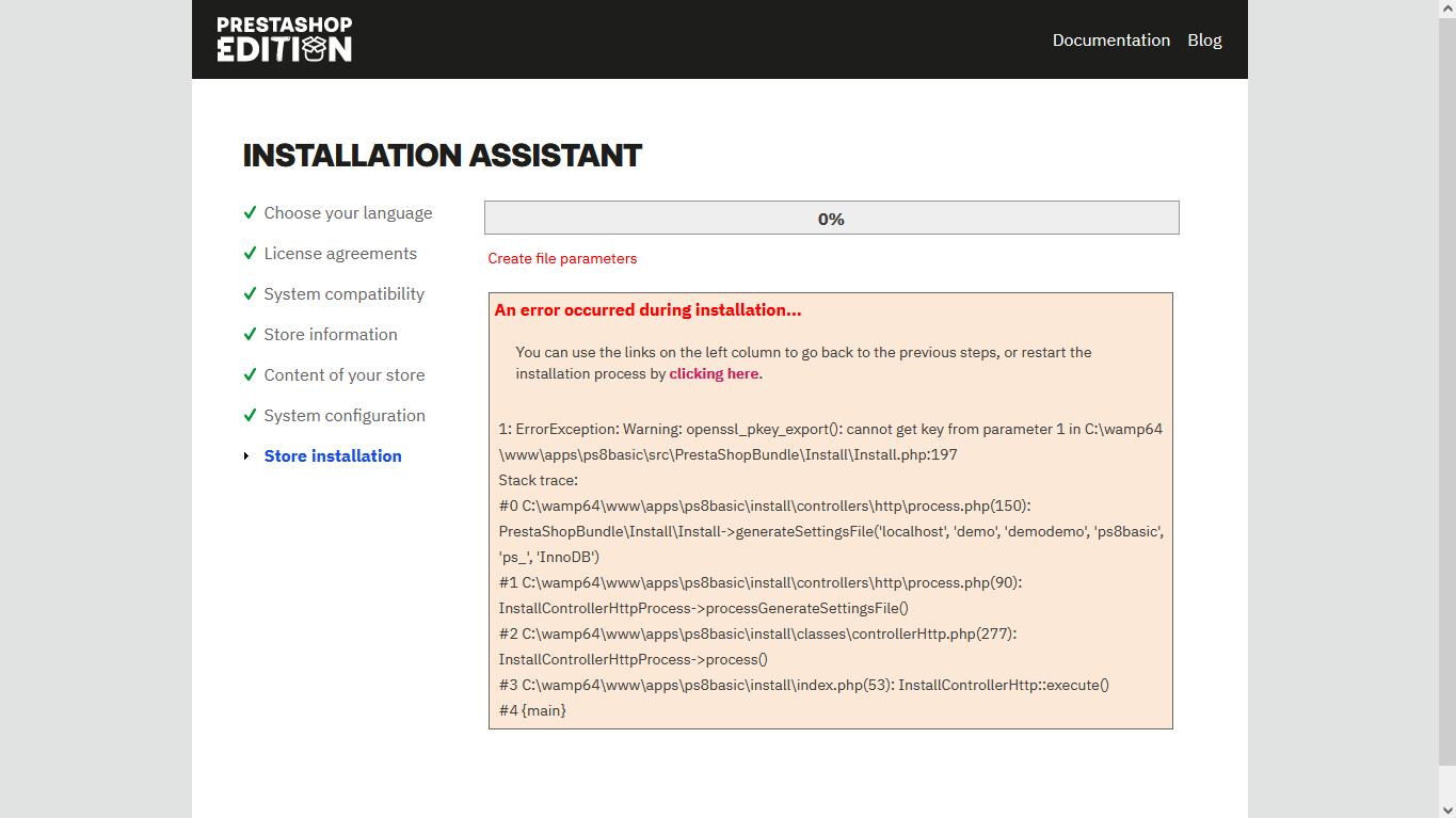

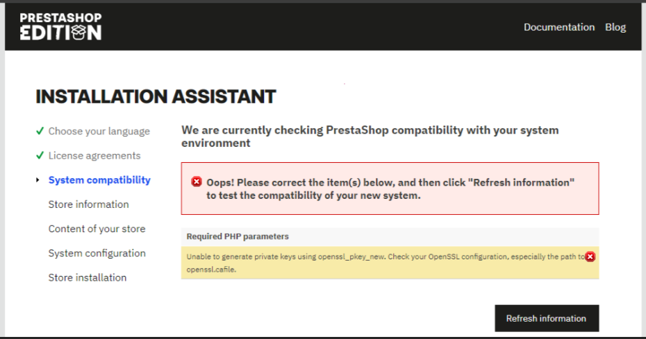

Zohaib-fk Posted October 2, 2023 Share Posted October 2, 2023 When I enable debug mode and restart the installation process, it stops at 0%. Attached screenshot for your reference. Link to comment Share on other sites More sharing options...
musicmaster Posted October 2, 2023 Share Posted October 2, 2023 2 hours ago, Zohaib-fk said: When I enable debug mode and restart the installation process, it stops at 0%. Attached screenshot for your reference. That one was mentioned before too: a Windows installation where the OPENSSL_CONF environment variable hasn't been set correctly. Link to comment Share on other sites More sharing options...

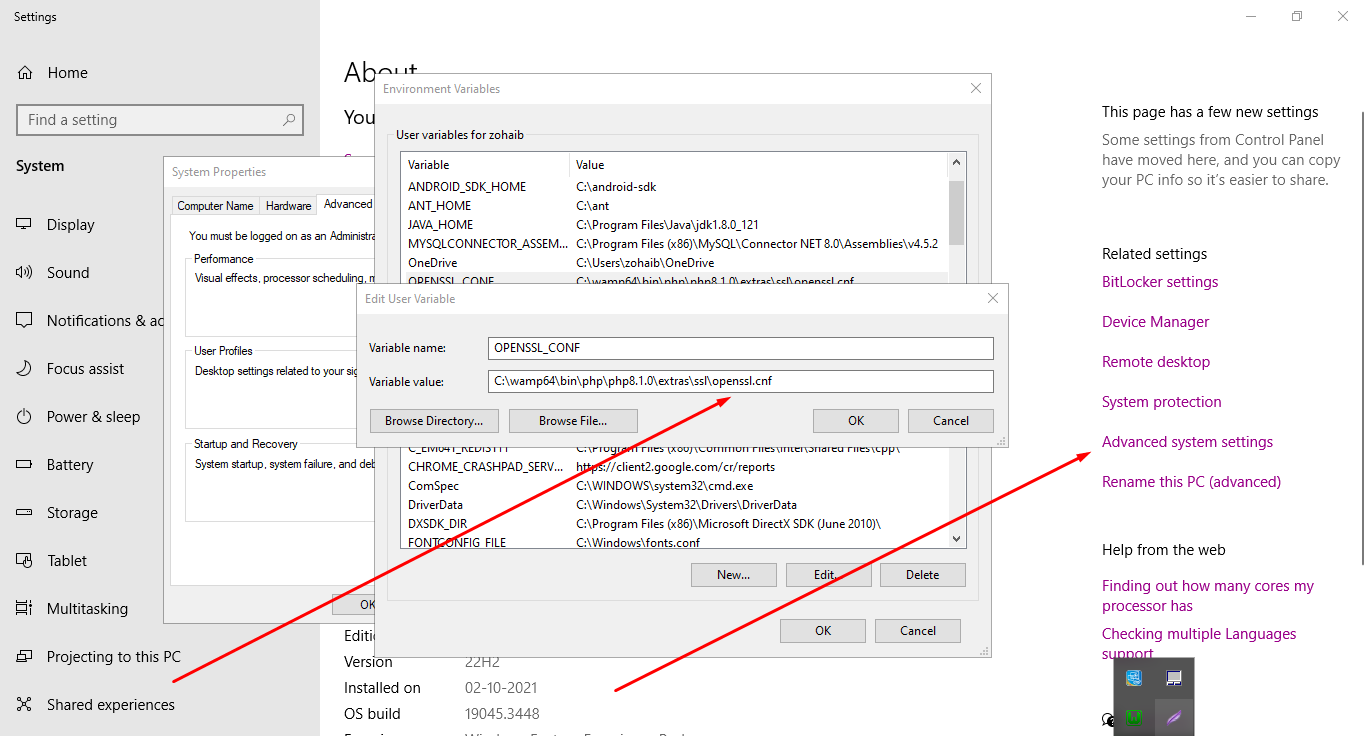

Zohaib-fk Posted October 2, 2023 Share Posted October 2, 2023 Okay, I will check for that setting in Windows WAMP, I tried on web hosting, installation stopped at many points so I restarted it It is getting stop at the install theme and install module, attached a screenshot and link of my PHP environment. https://www.hrms-systems.com/info.php When the install theme step is completed successfully, the install module stops. Link to comment Share on other sites More sharing options...

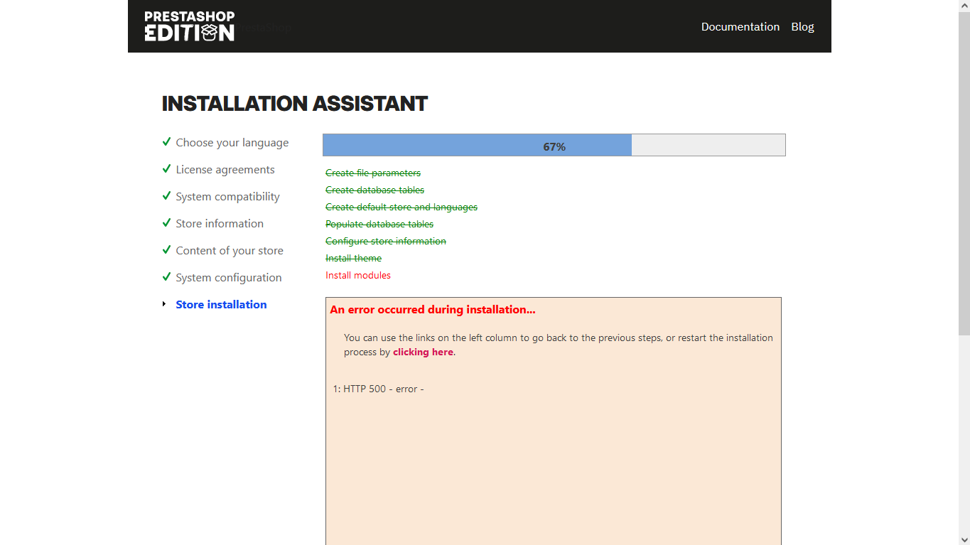

musicmaster Posted October 2, 2023 Share Posted October 2, 2023 I discussed OPENSSL_CONF here. This is not WAMP settings. It is something you need to do by yourself as for some reason WAMP fails to do it. 56% (ps_link_block_shop) and 67% (ps_edition_basic) errors seem to alternate. After I removed ps_edition_basic both disappeared. ps_edition_basic makes it clear that it needs PHP 8.1 when you have debug mode enabled. I am not how the ps_link_block_shop error would work out in debug mode. Maybe you can report that. Link to comment Share on other sites More sharing options...

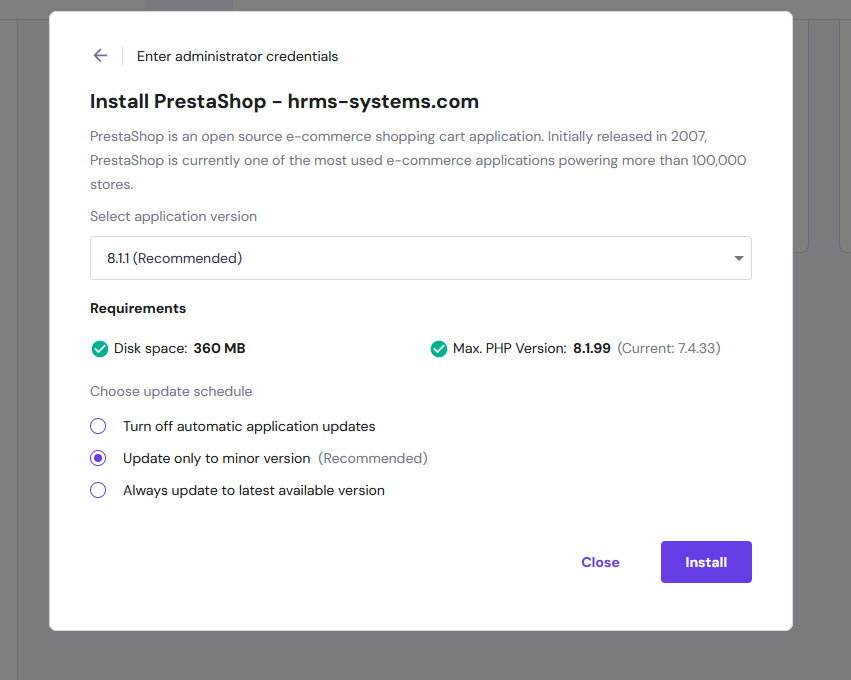

Zohaib-fk Posted October 3, 2023 Share Posted October 3, 2023 Thanks for your support and answers I have an automatic website installation feature from web hosting, automatic installation is able to install the PS 8.1.0 version but manual installation of PS basic gives errors. Below is the link to the same web hosting with the same PHP version for your reference please check. I feel maybe they installed some other version of 8.1.0 and not the PS basic which I downloaded from the PS website. Back Office URL: https://www.hrms-systems.com/pstest/admindemo/index.php Username: [email protected] Password: Demodemo123 Link to comment Share on other sites More sharing options...
musicmaster Posted October 3, 2023 Share Posted October 3, 2023 46 minutes ago, Zohaib-fk said: Thanks for your support and answers I have an automatic website installation feature from web hosting, automatic installation is able to install the PS 8.1.0 version but manual installation of PS basic gives errors. Below is the link to the same web hosting with the same PHP version for your reference please check. I feel maybe they installed some other version of 8.1.0 and not the PS basic which I downloaded from the PS website. Back Office URL: https://www.hrms-systems.com/pstest/admindemo/index.php Username: [email protected] Password: Demodemo123 It is a bit unusual to put password on the forum. Better to use PM for that. This is 8.1.0. When you download from Prestashop you get version 8.1.1. It is obvious that this is customized. There are also a lot of non-Prestashop modules. Link to comment Share on other sites More sharing options...
Zohaib-fk Posted October 3, 2023 Share Posted October 3, 2023 I use the instance for the demo purpose to show the compatibility of my module on version 8. x.x therefore I share the password and it is a public sharing demo instance. I am able to install PS version 8.1.1 using an auto installer from my web hosting, attached a screenshot for your reference. How to know if the version installed 8.1.1 from auto-installer is the PS basic edition? Link to comment Share on other sites More sharing options...
musicmaster Posted October 3, 2023 Share Posted October 3, 2023 The basic edition and the Github version are the same software. Only the basic edition has some extra modules. Obviously your webhosting uses its own mix of modules. So it is neither of the two. Link to comment Share on other sites More sharing options...
Zohaib-fk Posted October 3, 2023 Share Posted October 3, 2023 Ok, I will try manual installation on Windows WAMP, Ubuntu and web hosting, I will update on the success of the manual installation work. I set OPENSSL_CONF in environmental variables like the attached screenshot. Link to comment Share on other sites More sharing options...

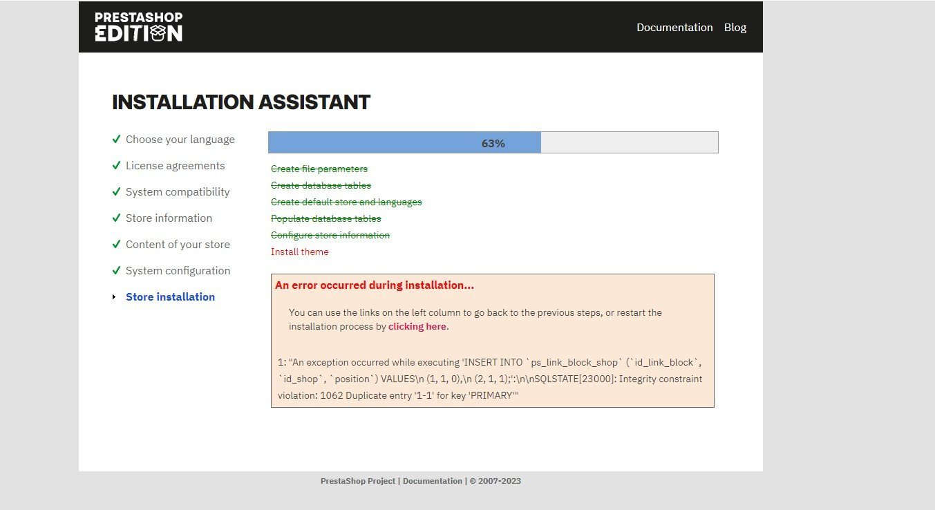

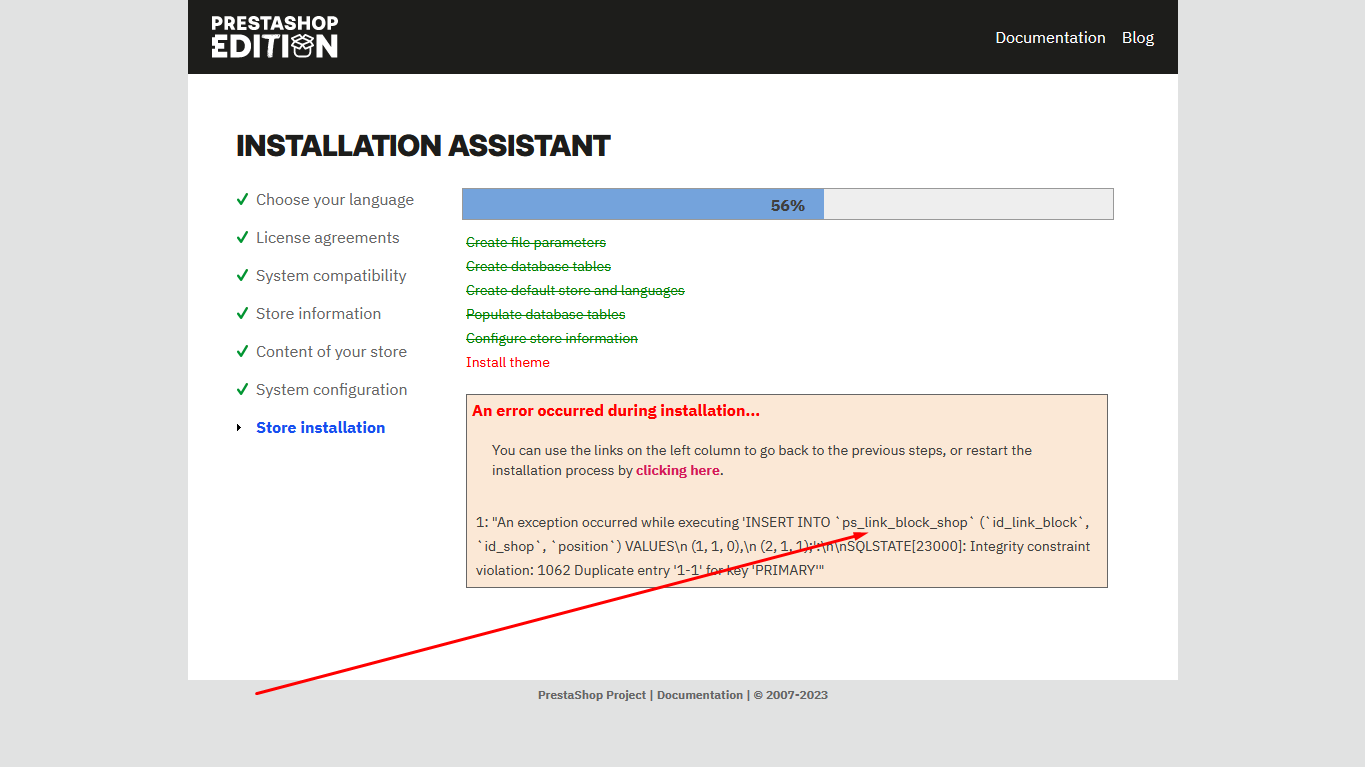

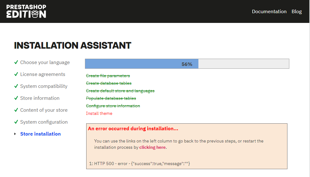

coolu Posted November 24, 2023 Share Posted November 24, 2023 (edited) Hi ia m doing a prestahop 8.1 installation getting the same error can anyone assist and help me An error occurred during installation... You can use the links on the left column to go back to the previous steps, or restart the installation process by clicking here. 1: "An exception occurred while executing 'INSERT INTO `ps_link_block_shop` (`id_link_block`, `id_shop`, `position`) VALUES\n (1, 1, 0),\n (2, 1, 1);':\n\nSQLSTATE[23000]: Integrity constraint violation: 106or key 'PRIMARY'" Edited November 24, 2023 by coolu (see edit history) Link to comment Share on other sites More sharing options...
musicmaster Posted November 24, 2023 Share Posted November 24, 2023 This is caused by the module ps_linklist. You can delete that module and then restart the installation process by clicking "clicking here" in the message you showed. Link to comment Share on other sites More sharing options...
coolu Posted November 24, 2023 Share Posted November 24, 2023 5 minutes ago, musicmaster said: This is caused by the module ps_linklist. You can delete that module and then restart the installation process by clicking "clicking here" in the message you showed. 5 minutes ago, musicmaster said: This is caused by the module ps_linklist. You can delete that module and then restart the installation process by clicking "clicking here" in the message you showed. okay i disbled it but still getting error check screenshot Link to comment Share on other sites More sharing options...
musicmaster Posted November 24, 2023 Share Posted November 24, 2023 It looks like ps_linklist should be there. Did you delete ps_edition _basic? It was mentioned in previous posts in this thread but for some reason you didn't mention it. Link to comment Share on other sites More sharing options...

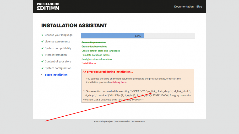

dannyfor Posted January 3, 2024 Share Posted January 3, 2024 Installation error indicates a duplicate entry ('1-1') violation in the ps_link_block_shop. Check and remove any existing entries with this value, consider restarting the installation, and ensure a clean database before reinstalling Link to comment Share on other sites More sharing options...
musicmaster Posted January 4, 2024 Share Posted January 4, 2024 15 hours ago, dannyfor said: Installation error indicates a duplicate entry ('1-1') violation in the ps_link_block_shop. Check and remove any existing entries with this value, consider restarting the installation, and ensure a clean database before reinstalling Please read the rest of a thread before you add your issue. The solution was already mentioned on 1 October. Link to comment Share on other sites More sharing options...

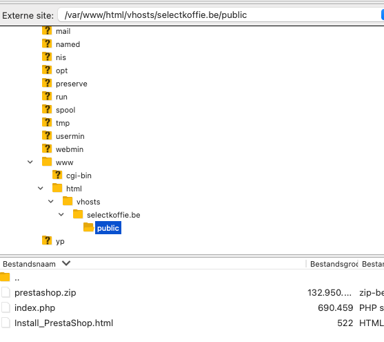

Generaal Posted January 18, 2024 Share Posted January 18, 2024 Sorry for wanting to cut in here. I placed the Prestashop files on my unmanaged VPS server. But it is not possible to get Prestashop installation started. What have I overlooked? Should I be able to achieve this via a different approach on my VPS? Link to comment Share on other sites More sharing options...
musicmaster Posted January 26, 2024 Share Posted January 26, 2024 On 1/18/2024 at 11:01 AM, Generaal said: Sorry for wanting to cut in here. I placed the Prestashop files on my unmanaged VPS server. But it is not possible to get Prestashop installation started. What have I overlooked? Should I be able to achieve this via a different approach on my VPS? As long as you don't explain what you tried nobody will be able to help you. Link to comment Share on other sites More sharing options...

Babu Amkaian Posted September 3, 2024 Share Posted September 3, 2024 (edited) Hi @musicmaster, I have read the rest of the threads and am posting this. I am installing PrestaShop version 8.1.7 with PHP version 8.2.12. Initially, I encountered an SSL issue, which I resolved by adding an environment variable. Refer to Resolve. Next, after providing all the necessary details, I am now facing issues with the theme installation. Is PrestaShop version 8.1.7 stable to use? Why am I receiving so many issues while installing the latest version? Edited September 3, 2024 by Babu Amkaian (see edit history) Link to comment Share on other sites More sharing options...
musicmaster Posted September 3, 2024 Share Posted September 3, 2024 Error at 56% has been discussed previously in this thread. I am not sure everything works with php 8.2. Try 8.1= 1 Link to comment Share on other sites More sharing options...

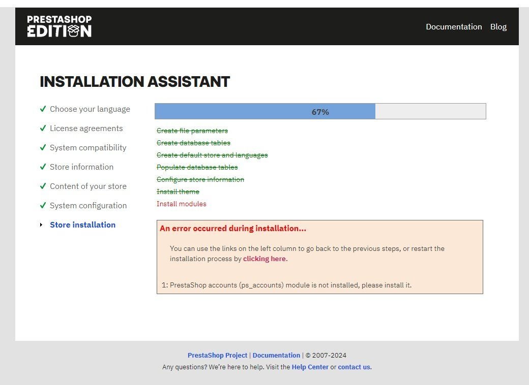

PuMaRi Posted September 11, 2024 Share Posted September 11, 2024 Maybe somebody know how to fix this error. PHP 8.2.12 Prestashop 8.1.7 Link to comment Share on other sites More sharing options...
musicmaster Posted September 11, 2024 Share Posted September 11, 2024 1 hour ago, PuMaRi said: Maybe somebody know how to fix this error. PHP 8.2.12 Prestashop 8.1.7 It says ""ps_accounts not installed". So obviously you have selected some modules that need ps_accounts but not ps_accounts itself. Link to comment Share on other sites More sharing options...
PuMaRi Posted September 11, 2024 Share Posted September 11, 2024 43 minutes ago, musicmaster said: It says ""ps_accounts not installed". So obviously you have selected some modules that need ps_accounts but not ps_accounts itself. Thank you for your reply. I am totally new to this. Could you possibly tell me, how I could select ps_accounts module? It is in downloaded files. I followed the installation process and did not modify a thing. Just did some corrections, when errors occured, but all answers I found in the internet. Link to comment Share on other sites More sharing options...
PuMaRi Posted September 12, 2024 Share Posted September 12, 2024 Found it myself. Took out edition basic module from installation and no more errors Thanks anyway 1 Link to comment Share on other sites More sharing options...
