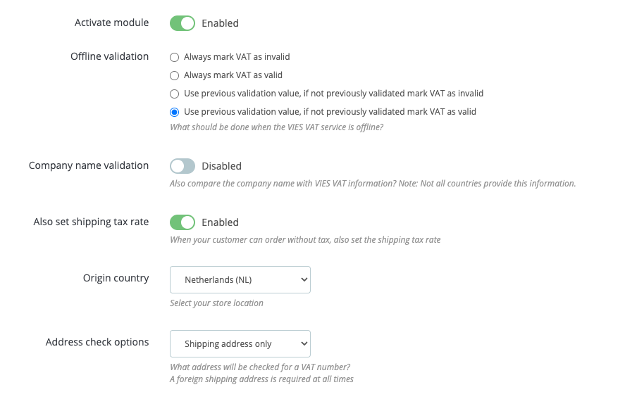

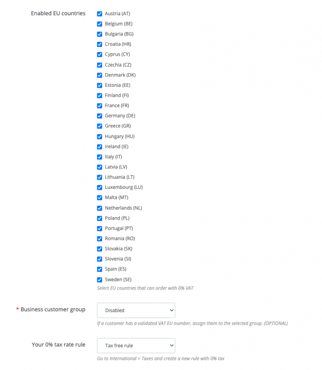

Inform-All Posted December 5, 2025 Author Share Posted December 5, 2025 The newly added feature may feel a bit confusing at first, but it is very important to review the module configuration after updating. The module now lets you choose which address should be used for VAT validation during checkout. Understanding the difference between these options is essential. If you select “Shipping address only,” the VAT number will be validated based solely on the shipping address. This means that if a customer has both a shipping and an invoice (billing) address, the module will ignore the invoice address entirely. In practice, this can lead to situations where a customer does have a VAT number on their invoice address, but does not enter one for the shipping address. Because of this, the order will not be marked as a valid VAT order, even though the customer does actually have a VAT number. To avoid this scenario, the module includes an additional setting: "Prioritise shipping address over invoice address". When enabled, the module will validate the invoice address if the shipping address does not contain a VAT number. This fallback must be explicitly activated in the module configuration. It ensures that VAT validation still succeeds even if the customer only enters their VAT number in the invoice address. In summary, after updating, make sure to review these new address selection options carefully, and enable the fallback if you want VAT checks to continue when the shipping address VAT field is empty. This will help prevent unexpected validation results and ensure a smoother checkout experience for both the store and your customers. Link to comment Share on other sites More sharing options...
