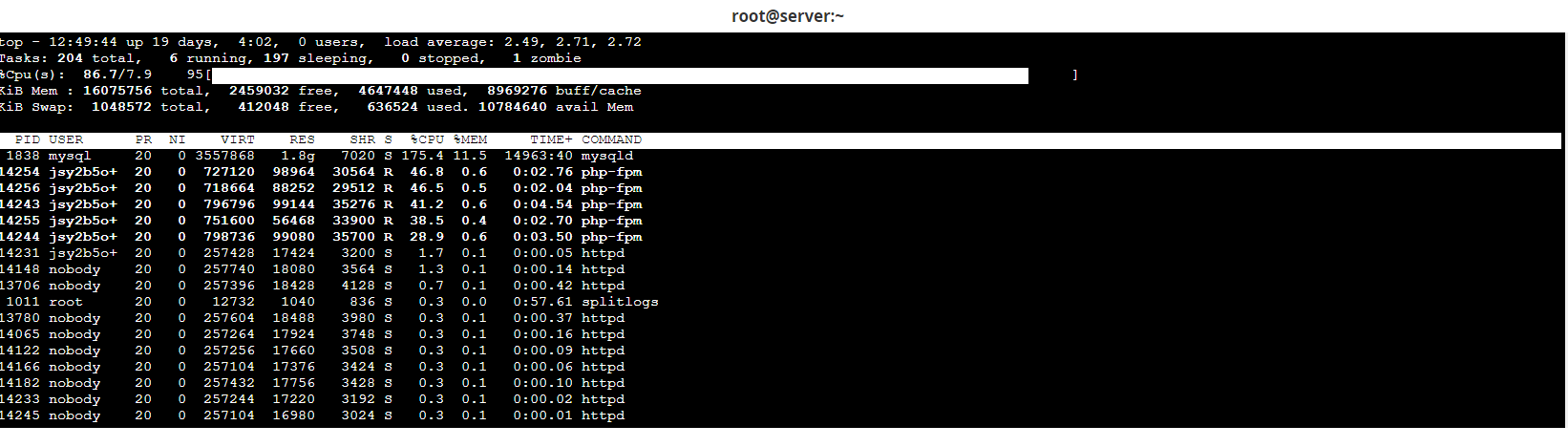

fraizor Posted February 13, 2022 Share Posted February 13, 2022 I had been using Prestashop since 2017 for my startup company since PS 1.6 Serious usage was from PS 1.7.4 till now using 1.7.7 on all of these releases i had been facing performance issues that occurs when we have a spike with visitors. when we have less than 20 visitor's everything is ok, however when they are above 30 the issue start happening... The issue is that mysql process is eating too much CPU , which is causing the website to be very slow as you can see in screenshot below Mysql process is using 175% CPU , followed by FPM processes i had consulted multiple developers, sysadmin, web agencies, all of them failed to solve the issue or square it in a specific module. one agency said that this is related to the core structure of prestashop and due to the unoptimized nature of the code, mystore have 150 category and 80k products .. simply PS cannot handle them in an efficient way Any advice / suggestion is highly appreciated , i am really stuck here and this issue is deeply hurting our business AWS EC2 x.large instance ( 4 cpu, 16GB RAM) VPS CentOS v7.9.2009 kvm Prestashop 1.7.7.8 Link to comment Share on other sites More sharing options...

fraizor Posted February 13, 2022 Author Share Posted February 13, 2022 Thank you for your response @ComGrafPL actually i had tried 3 of the best seller cache modules on the marketplace .. unfortunately they did not fixed the issue while i felt the website is a little faster when it is enabled , still the CPU issue is exactly the same that is why i uninstalled them Link to comment Share on other sites More sharing options...
SmartDataSoft Posted February 14, 2022 Share Posted February 14, 2022 @fraizor Cache module can't fix your this issue. Suppose you have huge visitor , those visitor log's saved in db. so you need to clean your store db frequently, using cron is good. Secondly, you need to find which module cause this issue. if they call the db frequently without cache. Optimize this two your mysql request will reduce Thank you 1 Link to comment Share on other sites More sharing options...
fraizor Posted February 14, 2022 Author Share Posted February 14, 2022 Hello @SmartDataSoft Actually I have All the stats module disabled ... regarding finding the bad module , how can I do this ? Debug profiling is not showing the perfoamce of each module on a Spesific page ... Link to comment Share on other sites More sharing options...

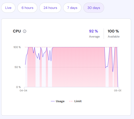

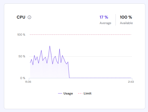

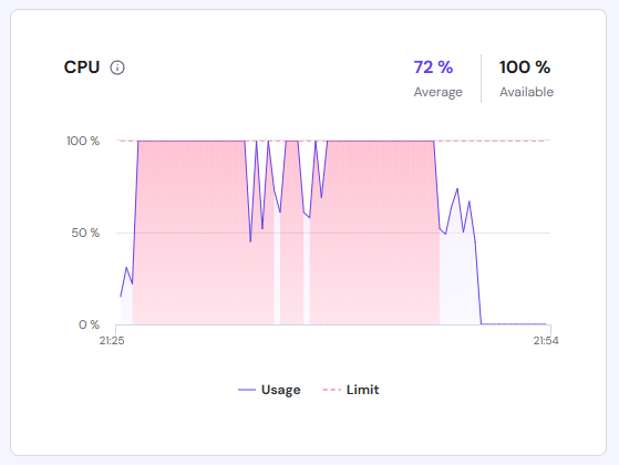

JaredK Posted May 5, 2025 Share Posted May 5, 2025 I use PS 8.1 and was having increasingly more frequent 500 Errors, both on front and admin of my website. Lots of calls to 'upgrade the plan' and spend more dollars without getting to the bottom of it. I see this is an ancient problem with Prestashop, some of these very similar posts going back to 2011. Probably everyone had their issues resolved, but I want to leave this here, in case some other unfortunate soul has the same issue and is frantically searching the internet... and perhaps they'll arrive here. For most of the day I was struggling to try and get my site back up. Hours passed. Restore of both file system and database to previously working versions. This was the worst it had ever been. Nothing helped to rsolve the problem, and I was completely locked out of the admin side too, so couldn't even make any changes to the settings. I thought my coder had somehow messed something up when he made a modification. He thought so too, but couldn't find the reason for the 500 Error and finally gave up on the project. I thought it was off that my CPU usage and memory would still spike even during times that both the website and admin side were down. Also at night. By fluke I looked at the analytics, the host support being not much help in figuring out the cause. I saw that there was huge traffic from Brazil, Banghladesh and other countries far away, and I proceeded to block access for any country I have no dealings with at all. Within minutes of doing so, CPU and Memory usage normalized. It's now been a full 6 hours since everything is calm and working perfectly. Moral of the story: before you dig into mods and try to find the problem in the data structure or settings of Prestashop, check out what traffic you're subjected to and if you see extremely heavy traffic from countries or IP ranges that should not be on your site, block their access. On a small site, that's essentially the equivalent of a DDoS attack. Chances are, your problems will clear up. II hope someone is going to be helped with this. Good luck 1 Link to comment Share on other sites More sharing options...

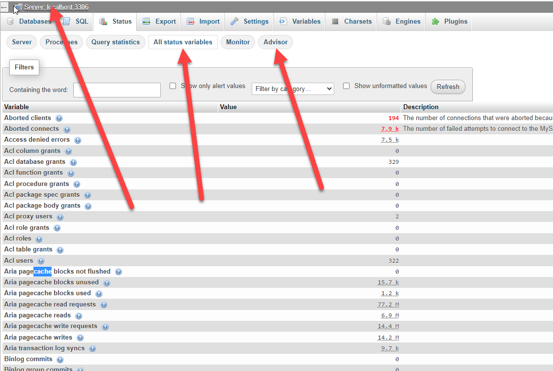

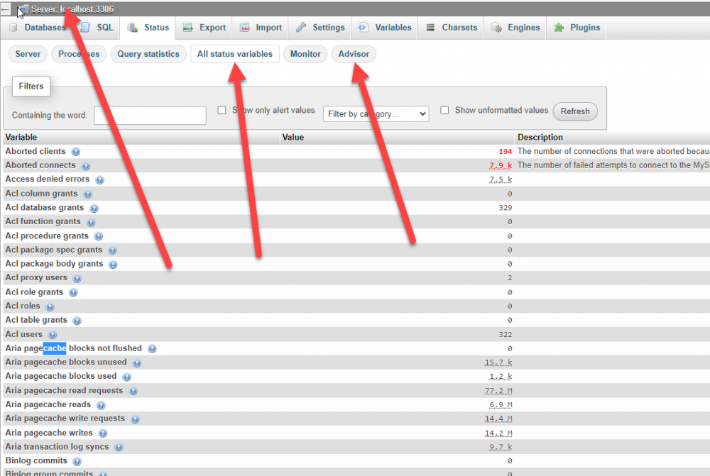

PrestaHeroes.com Posted May 5, 2025 Share Posted May 5, 2025 (edited) Hi, generally speaking and from experience, no the hosting company will not support tuning of mysql unless the hosting package is fully managed and may not even then. Login to phpMyAdmin Go to your hosting control panel and launch phpMyAdmin. Go to the "Status" or "Server Status" tab This gives you live metrics. Look for values highlighted in red—these indicate areas where performance may be suboptimal. Look for these key stats: Key buffer size – Important if using MyISAM tables. Query cache efficiency – If too low, consider disabling or tuning query_cache_size (note: query cache is deprecated in MySQL 5.7+). Temporary tables created on disk – If this number is high, increase tmp_table_size and max_heap_table_size. Sorts using disk – If high, consider increasing sort_buffer_size. Table locks / Slow queries – May need innodb_buffer_pool_size tuning or indexing. Edited May 5, 2025 by El Patron (see edit history) Link to comment Share on other sites More sharing options...
