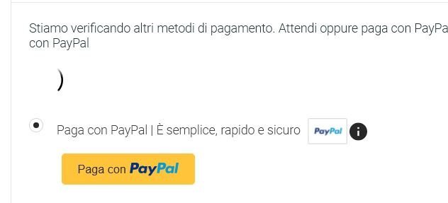

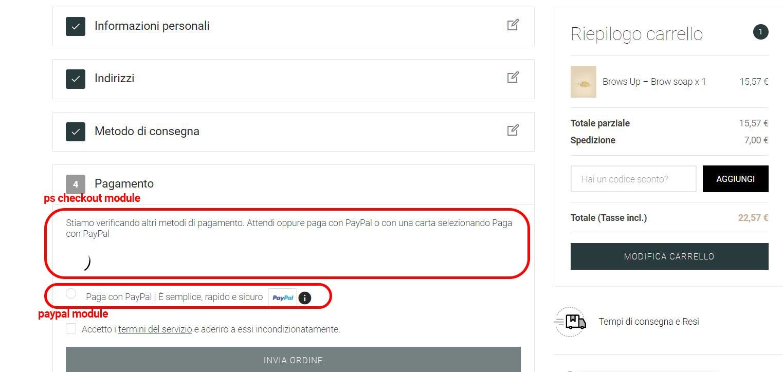

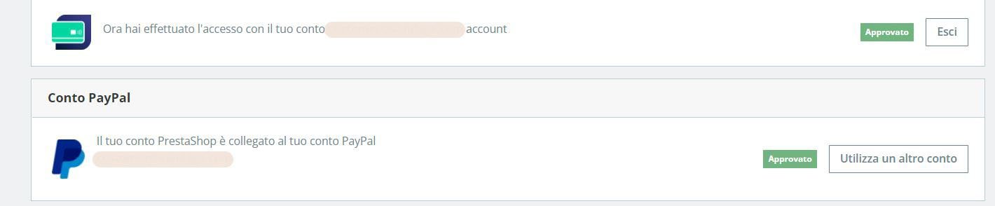

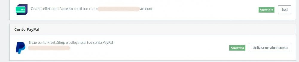

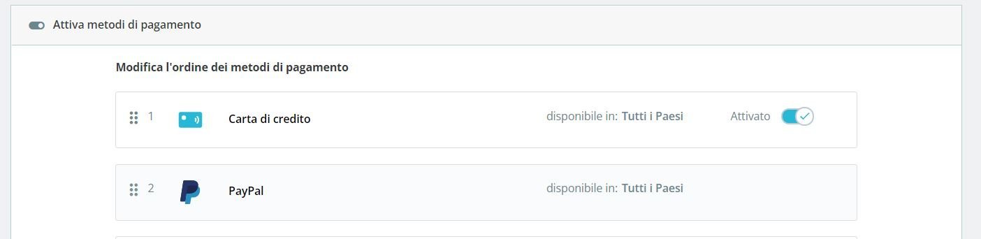

Nicolas B. Posted January 13, 2022 Share Posted January 13, 2022 Hello anyone! I need your help. I have an installation of Prestashop version 1.7.7.7 in which I have installed the prestashop checkout module at version 2.15.5 and the PayPal module at version 5.4.7. Unfortunately I have a problem with the Prestashop checkout module: I configured it with paypal account and prestashop checkout account and activated PayPal payment methods and credit cards payment method. Everything from BO seems to be configured correctly. My problem is that when I go to FO at the checkout, in the payments section I don't see any payment method, but a text that tells me that the payment methods are loading and a spin that runs indefinitely. I also leave a screenshot of the BO configurations and the FO result. Thanks so much for your help!! Link to comment Share on other sites More sharing options...
