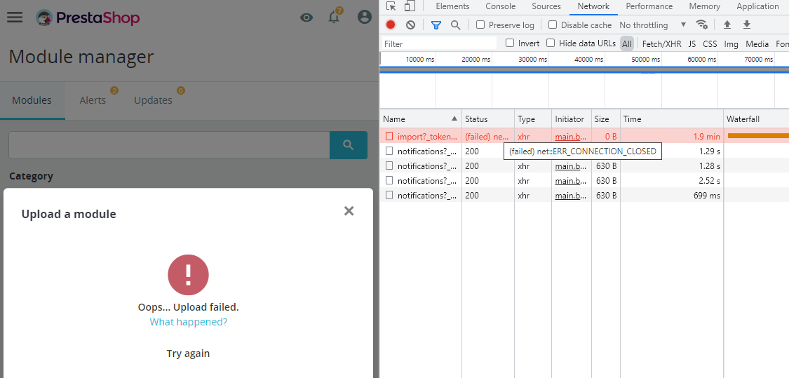

GFX_dev Posted December 29, 2021 Share Posted December 29, 2021 Hello, I am at a loss here. We got a new VPS for PS custom development purposes: 4 gb RAM 2 CPU When I install the latest prestashop, everything is fine, except that I cannot upload images or modules. It gives "Server responded with 0 code." after a while. Plesk Obsidian 18.0.40 Apache PHP 7.4.27 OR 7.3.33 (tried both) There are no errors in the debug console, no errors in the logs .... Installed an older version Prestashop (1.7.7); same issue. Then did 1-click upgrade; same problem. I am expecting something in the hosting, but given the fact that we have a different PS version (1.7.6) already running with the same host, I doubt that. What is new / who has any debugging ideas??? Image (in this example wooden planks) hangs during upload and then goes to Server responded 0 same for module Link to comment Share on other sites More sharing options...

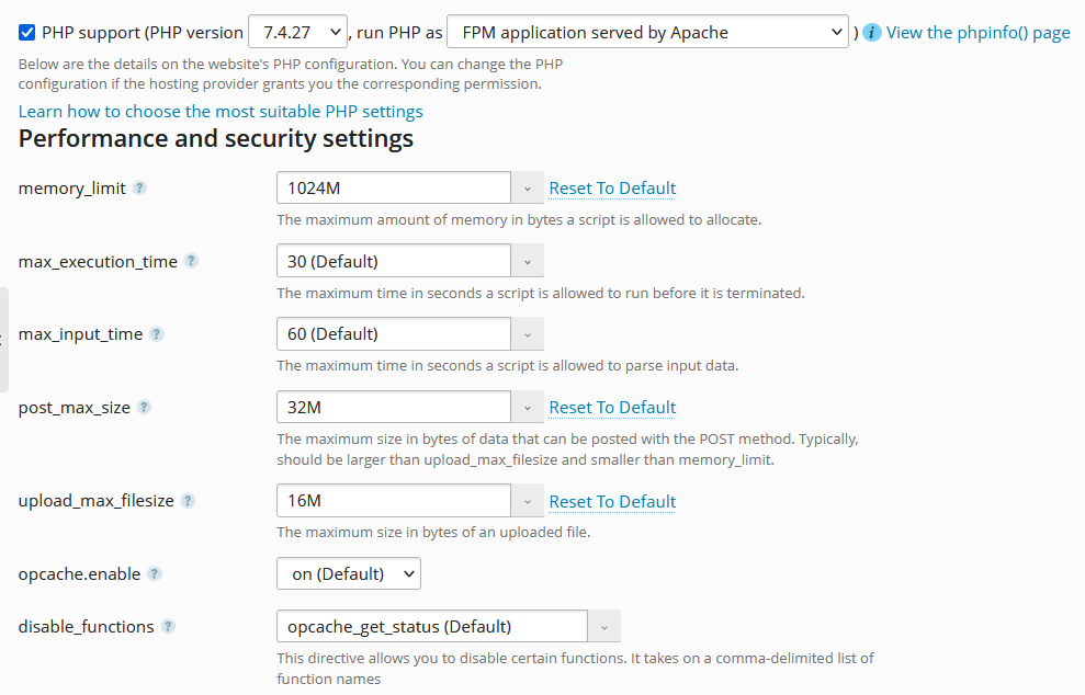

GFX_dev Posted December 29, 2021 Author Share Posted December 29, 2021 Thanks for the suggestions. I agree that it feels like a server-side problem. We should be able to solve this, right? I already played around with various settings based on the 1.7.6 config, but didn't seem to work in my hands! Here's a screenshot from my Plesk config right now (still throwing errors). Just uploading an image in the other set-up only takes a second or so. Therefore I feel 30 secs should be sufficient. I did put it on 60, but the error remained. PhpInfo is available to me; what should I look up? Link to comment Share on other sites More sharing options...

GFX_dev Posted December 29, 2021 Author Share Posted December 29, 2021 Via Google Chrome I get a bit more info when uploading a module. ERR_CONNECTION_CLOSED after almost 2 minutes of inactivity...? Link to comment Share on other sites More sharing options...
