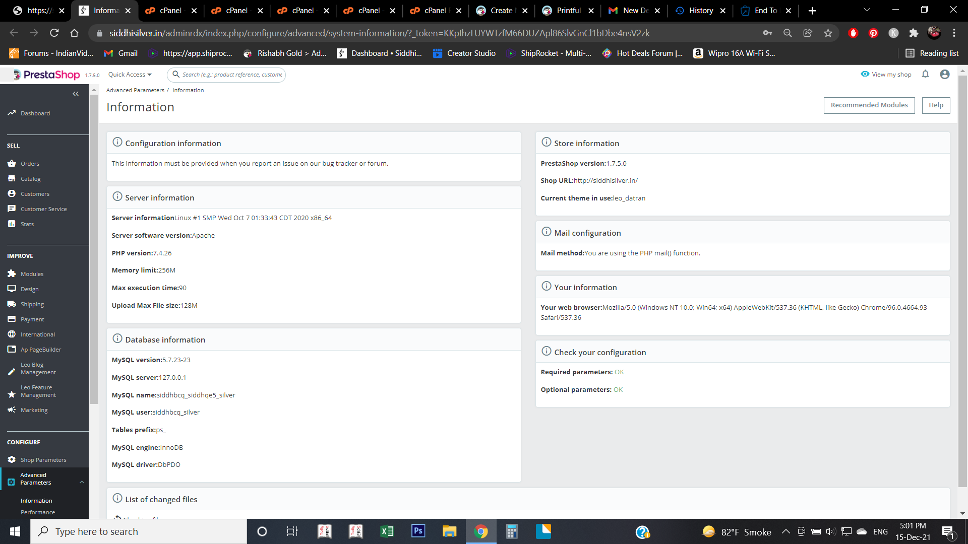

rushaboswal.rdx Posted December 15, 2021 Share Posted December 15, 2021 Hello my website was running fine for around 2 years and suddenly this happened. It keeps throwing 500 errors and server load is always around 1.00-1.10. When contacted hosting they said too many proccess are running . But im unable to pinpoint the exact issue from logs or any other help topics. Can somebody please help. Link to comment Share on other sites More sharing options...
rushaboswal.rdx Posted December 15, 2021 Author Share Posted December 15, 2021 Also when checked MYSQL Monitor , the system CPU Usage is always 100% What could be the issue ? Link to comment Share on other sites More sharing options...

Prestachamps Posted December 16, 2021 Share Posted December 16, 2021 Hi, A vcouple of issues spotted : 1. Lower your PHP from 7.4 to 7.2 - Ps .1.5.2 doesn't support the latest PHP ==> https://devdocs.prestashop.com/1.7/basics/installation/system-requirements/ 2. Ask your host to activate either PHP x-ray or new relic on the server. 3. Ask your host to activate for 1 H the server slow query logs . What they said it equals to zero! It would have been the same if I would have said about their host that s...s, without getting proper background information. I presume that lowering the PHP will solve most of the issues. Keep us posted. Cheers, Leo Link to comment Share on other sites More sharing options...
rushaboswal.rdx Posted December 16, 2021 Author Share Posted December 16, 2021 2 minutes ago, Prestachamps said: Hi, A vcouple of issues spotted : 1. Lower your PHP from 7.4 to 7.2 - Ps .1.5.2 doesn't support the latest PHP ==> https://devdocs.prestashop.com/1.7/basics/installation/system-requirements/ 2. Ask your host to activate either PHP x-ray or new relic on the server. 3. Ask your host to activate for 1 H the server slow query logs . What they said it equals to zero! It would have been the same if I would have said about their host that s...s, without getting proper background information. I presume that lowering the PHP will solve most of the issues. Keep us posted. Cheers, Leo The lowest my server provides is 7.3 they are the least helpfull in activating logs too. I think i might just migrate to a VPS Hosting with root access. Link to comment Share on other sites More sharing options...

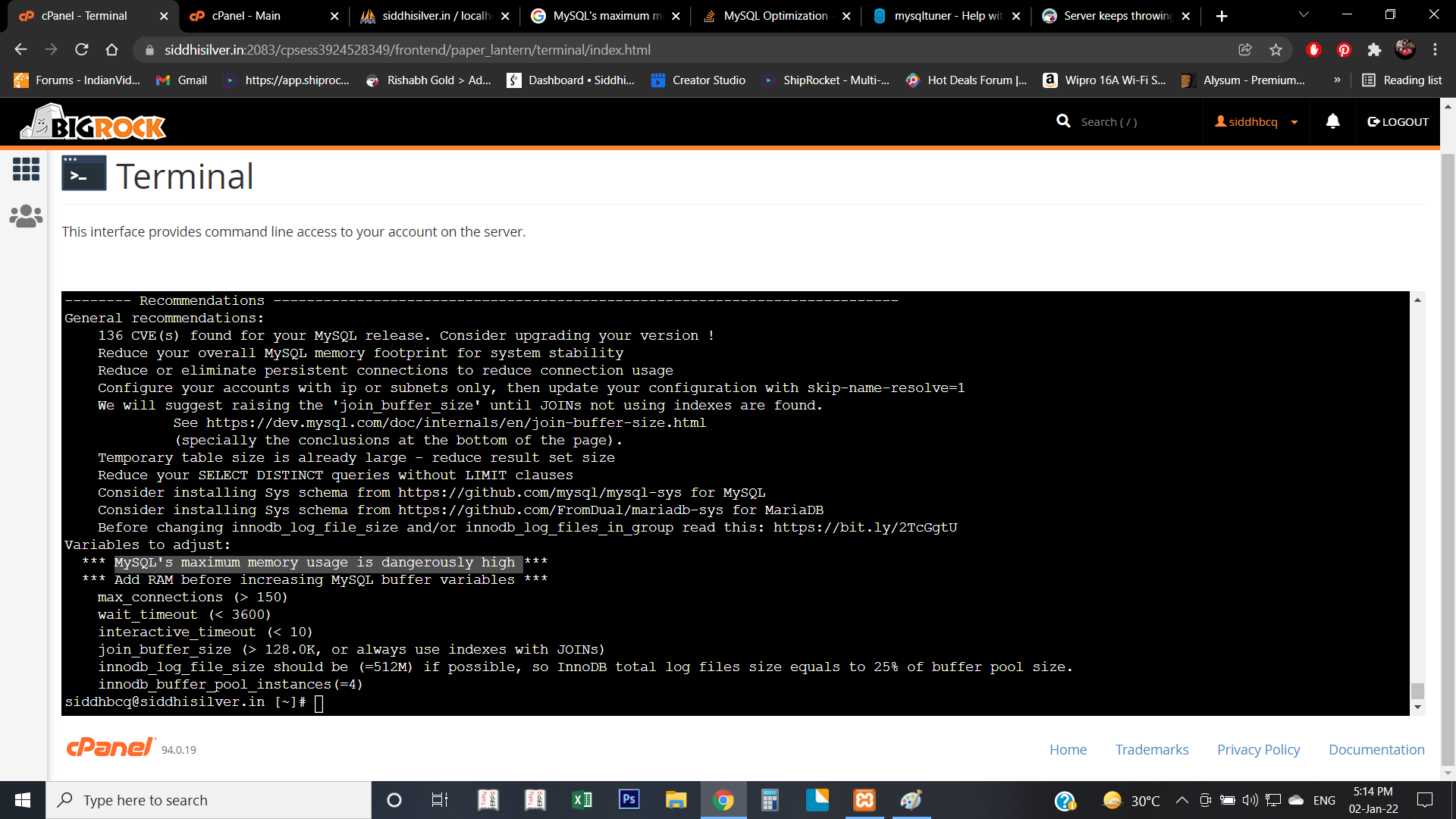

rushaboswal.rdx Posted January 2, 2022 Author Share Posted January 2, 2022 This is what i found out when i ran mysql Tuner. What could be causing this? Link to comment Share on other sites More sharing options...

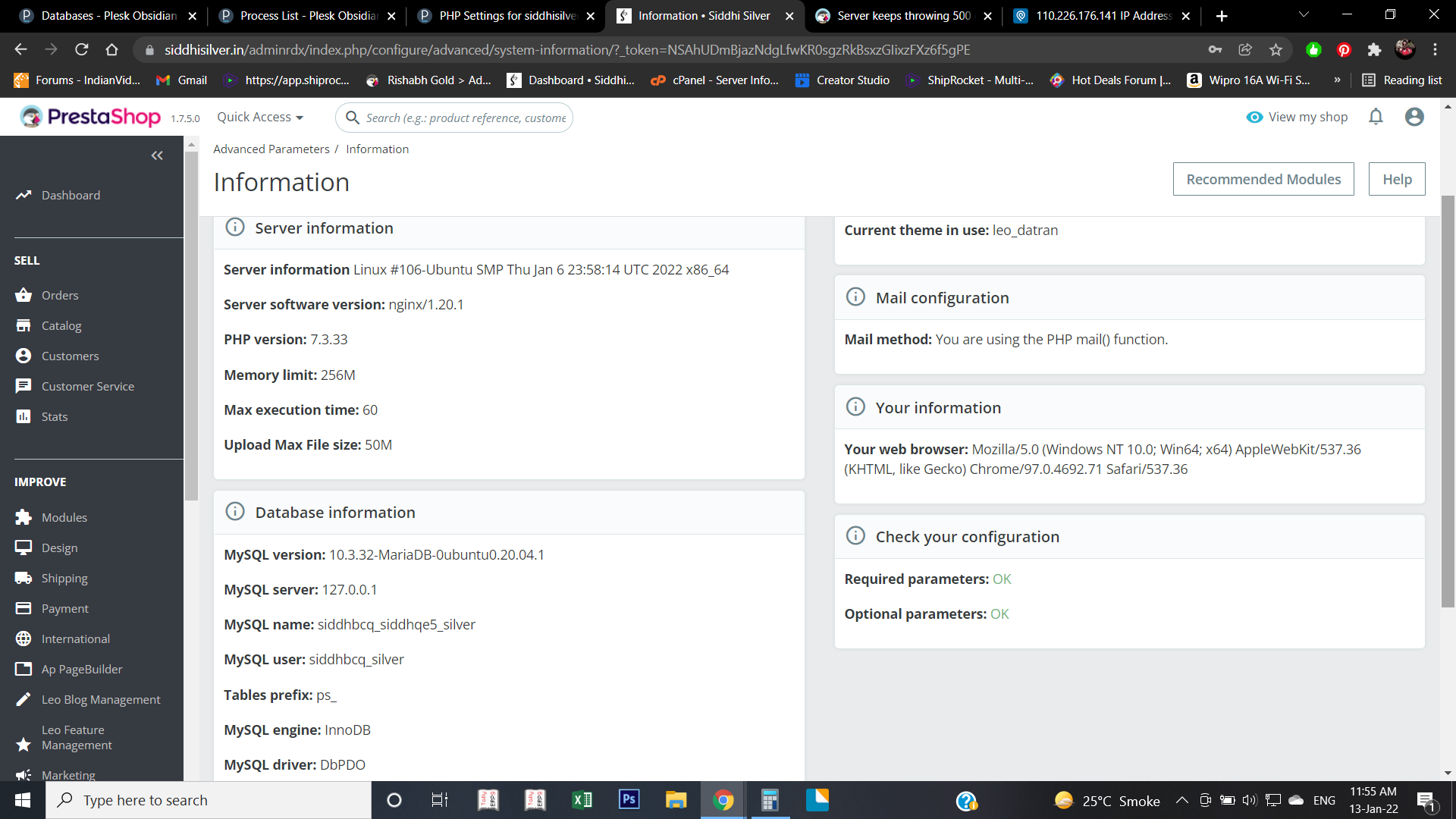

rushaboswal.rdx Posted January 13, 2022 Author Share Posted January 13, 2022 Switched to VPS finally. But the load times are a bit higher than that on shared hosting. Runnin PHP as Dedicated FPM application served by nginx. Here is the Information from prestashop information page. any help ? @El Patron ? Link to comment Share on other sites More sharing options...
